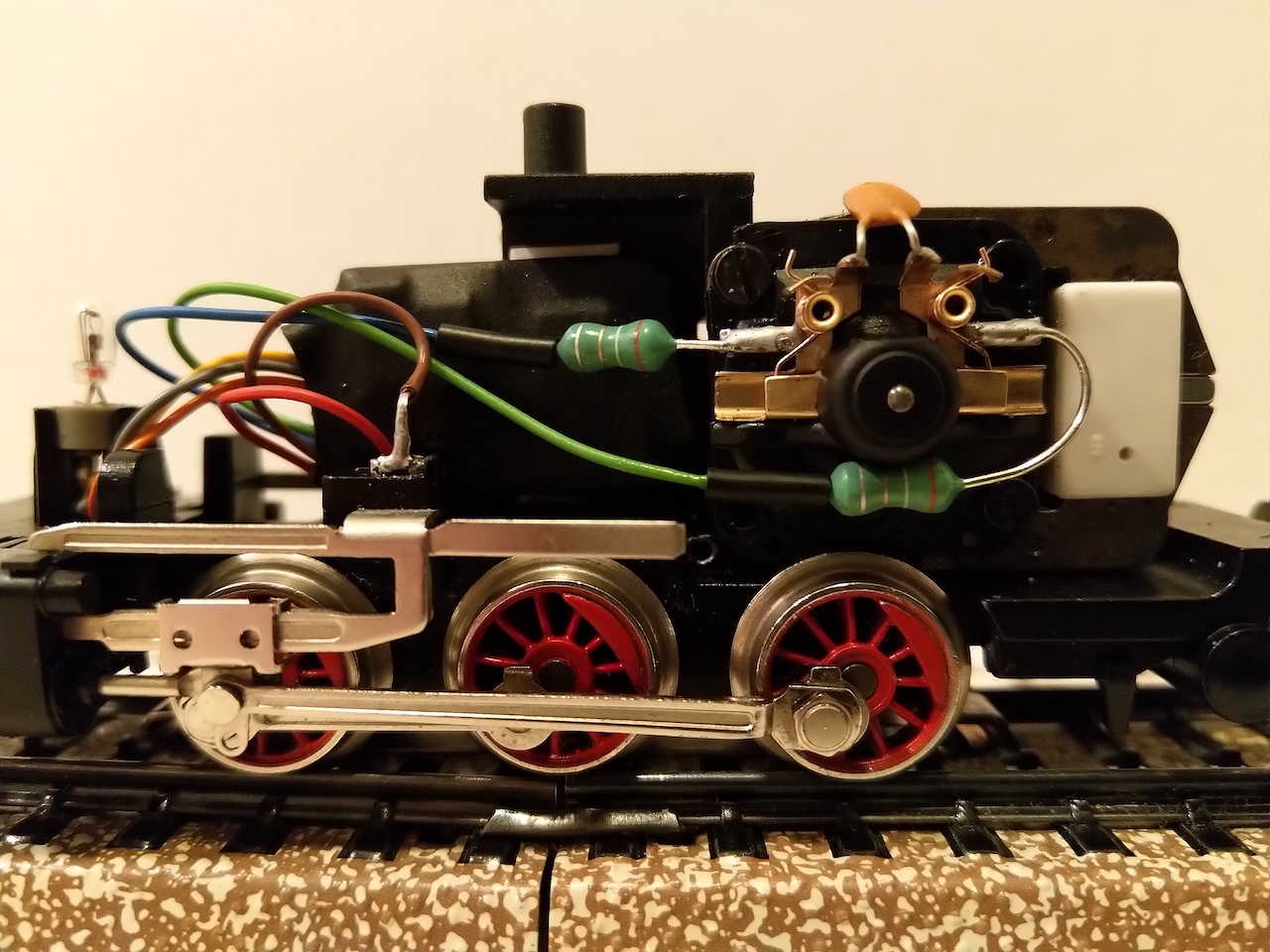

Just to close off this theme, I bought two 60760 sets and a 60943 + 60972 combo and so far I have installed the former sets to my BR 89 and BR 211 locomotives. The installation process went smoothly especially as my elder son did much of the soldering work: he is much more meticulous than me.
The only trouble came when we assembled the BR 211 afterwards. In particular, the Treibgestell (part 16 in the exploded image of the loco) got jammed and the locomotive refused to move. After several reassemblies it finally started to run properly.
My only explanation for this is that the kinematic chain consisting of the motor gears (part 6), the Treibgestell (part 16) and the small linking part ("Mitnehmer", part 15) can be put together in no less than 8 configurations. They should all be equal, but I suspect that after 30 years of service, one specific configuration had become much more equal than the others. So it took some tries to find it again.
All in all, I am very satisfied with the result. The locomotives work fine and exhibit exactly the kind of performance I was hoping to achieve.

Thanks for the reply, John! I am also a newbie in the conversion theme, so take my comments with caution.
Nevertheless, the two sets 60760 and 60943 you mention are intended for different types of motors: the former for drum-style commutator motors and the latter for smaller design flat-style commutator motors. (For an overview of different kinds of motors, I recommend peeking into this article from modellbahnkeller.eu.) So if your BR 89 has the latter kind of motor, 60760 was never going to work.
The particular kind of loco I upgraded was BR 89 006, Koll's version 3000.20 that originally came with the 2915 starter set. It had a commutator motor operated by a Delta decoder. So, 60760 was a good fit.
I also own a BR 89 028, version 3000.03 that poses a quite different conversion challenge. I will leave it as is.
I was worried about the space issue, but in the end this particular loco posed no real problems; we just had to route the cables appropriately. The end result of the conversion is shown below; I hope you agree that the handwork of my eldest is quite neat.
- Martti M.
thanks 2 users liked this useful post by Martti Mäntylä
