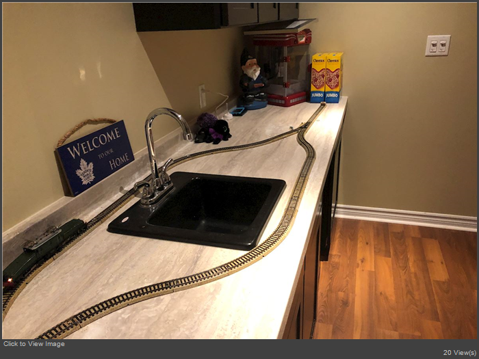

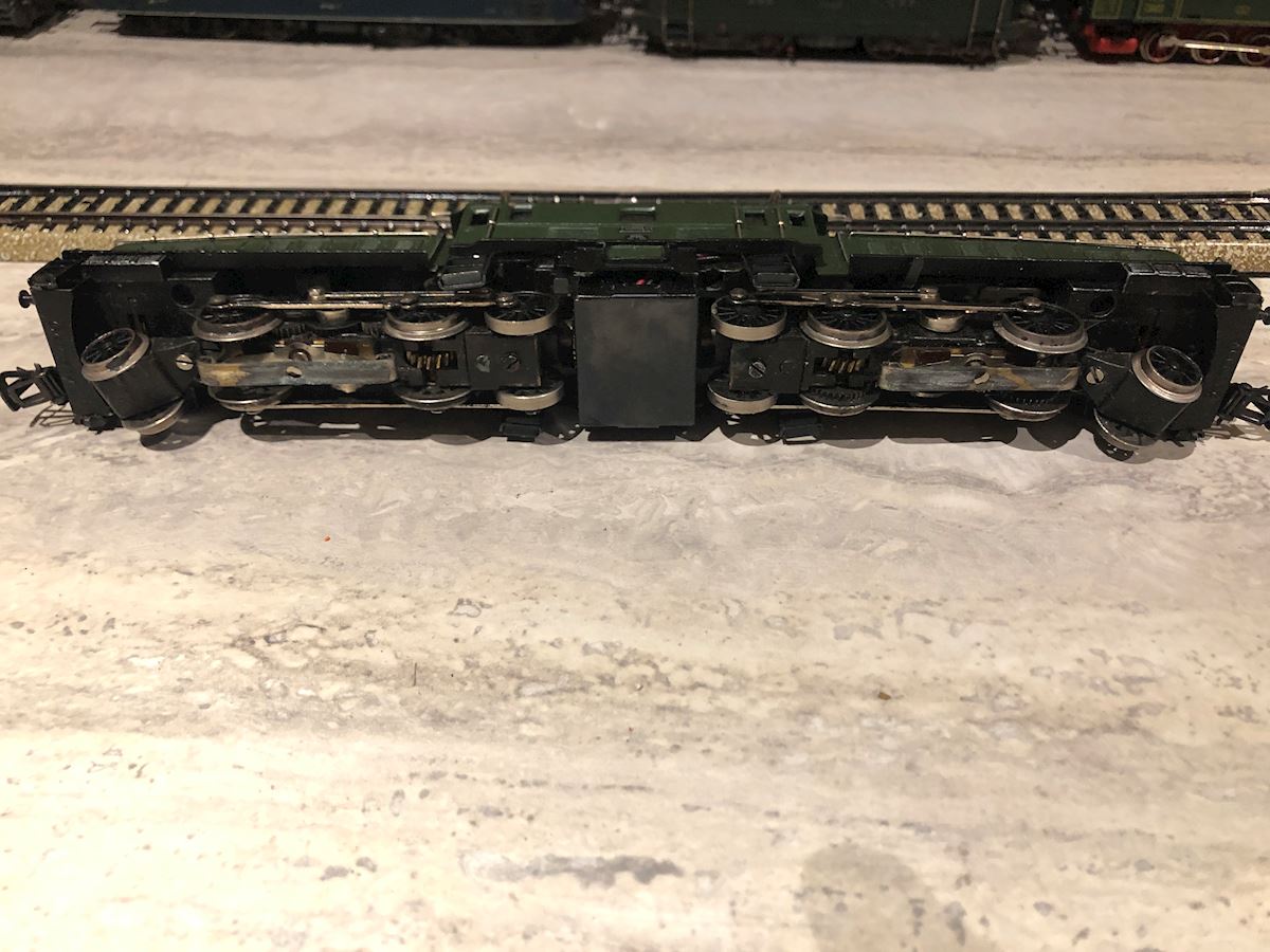

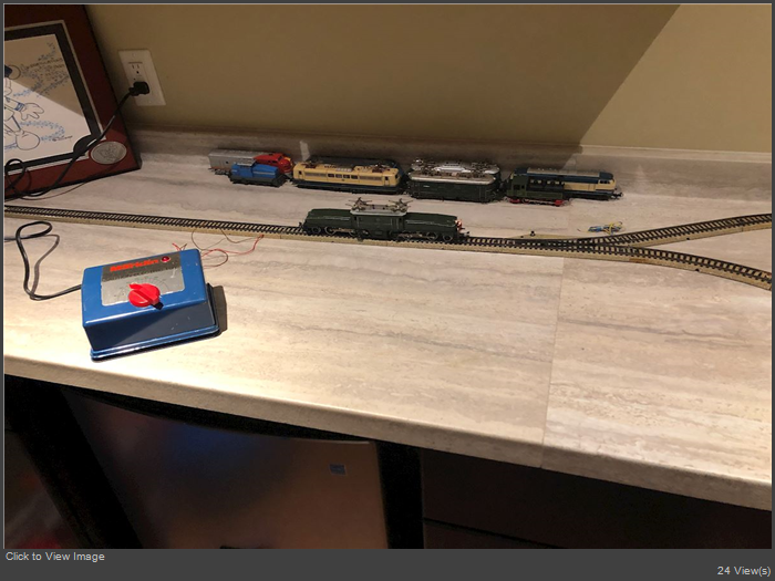

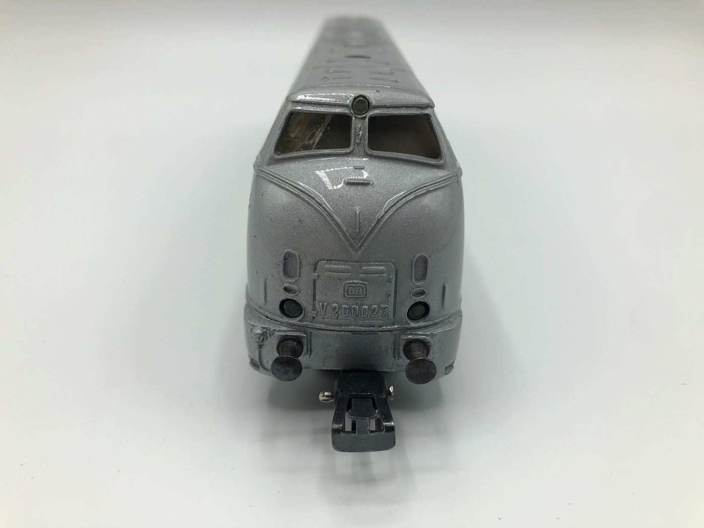

Ok, as requested here are a few photos of my small basement countertop setup. It's just setup to test some of the locos.
I was very interested in getting the 3015 Crocodile working which thanks to your guys help, I was able to do. However, it is not very smooth. It sometimes jolts forward, sometimes it stops and needs a small nudge to get going again. Also, when it is at the far end of the setup, it sometime will not reverse unless I again give it a small nudge.
I was also getting some sparks at one point as well. Is this a simple maintenance issue or is there something else going on?
Also, for oiling the locos that haven't been used in years/decades, is there a youtube video or something available I could check out?
Thanks!

No, if all of your locos and wagons are Marklin then you don't need to worry. If you have other make wagons you should be able to run them OK on Marklin track. Using non Marklin couplers with Marklin couplers can give some grief, as can the smaller wheels flanges of some non Marklin wagons. Best thing to do is try and see.
As for Youtube videos on maintaining Marklin locos, our forum member Martin from Sweden provides this video

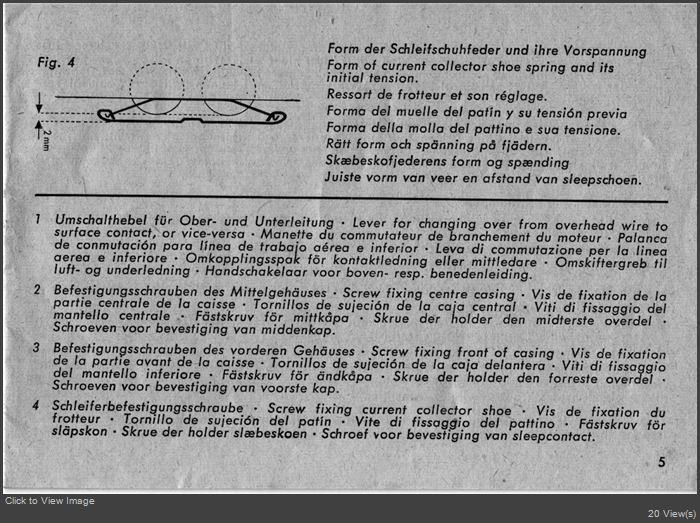

There is also a Marklin Service Manual which I've attached to this post. Also, Marklin locos come with a service / user manual for that particular loco. If you don't have the manual(s) we may be able to post copies for you. I don't have one for a 3015 Crocodile (the loco in your picture) but someone on the forum may be able to provide a copy.
Marklin 0733 Service Manual Vers B.pdf (11,534kb) downloaded 299 time(s).
As for your transformer, your particular one is from the 1970's so may be OK. The old 280A transformers from the 50's/60's were bad for the rubber insulating material in the transformer's cord breaking down and exposing bare wires which will lead to an electrocution risk. You can check your transformer by taking the mains plug off the transformer (unplugging it from the mains supply first!) and checking the state of insulation material of the cord at that end. If there are any signs the insulation has cracks or deteriorated in any way, have the transformer checked and or the cord replaced by an electrician.

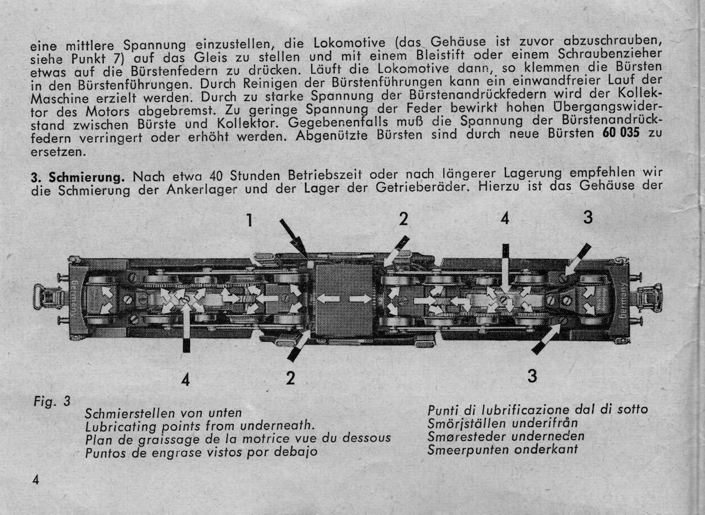

3015 Manual (English starts page 7):
Have FunBigGrin

The 3015 is one of the more tricky models to work with, so you may prefer to get started with simpler ones such as the 3000, 3003, or 3005 (if the collection includes these ones). They can be disassembled quite easily and the skills learned from working with them are transferable to other models.
I would recommend getting in your hands original Märklin lubricant (item 7149). You will also find it useful to have a bottle of isopropyl alcohol to clean jammed gears and like. Obviously you will need proper tweezers, side cutters, etc. The Märklin tool set (item 70900) is practical in the sense that it contains nut drivers specifically fit to work with steam locomotives, but of course you gan get similar tools from elsewhere. You will also eventually need spare tires, replacement brushes, lamps, and other small stuff like that. Fortunately, all these are easily available even for the old locomotives.
You say that the Crocodile may stop and then needs a small nudge to keep going. The problem may be simply that it has lost good electrical contact with the track. This can be simply tested by replacing the suspect 5106 with another. If the track turns out to be the culprit, it most often can be fixed by removing any dirt or rust that may be present. Also the pickup shoes underneath the loco may have issues - you can try to clean them up a bit (for this, isopropanol is great).
In any case, I personally envy your position - I find it great fun to get these old locomotives back in working shape again! One of the most attractive aspects of the old analog locomotives is that it is actually relatively easy to fix them, as long as there is no severe mechanical damage present.

As for the lubricant - is there an easily obtained alternative to the original Marklin lubricant?

Labelle brand oils have been recommended on this site in the past for both H0 and Z scale models, see these threads for example:
H0 locomotive rehabilitation post #2
Z locomotive rehabilitation post #3
I don't have any experience with Labelle, since I still have a 50 year old bottle of Marklin 7199 oil.
Labelle products are available in Streetsville (Mississauga), Ontario at the Credit Valley Railway Company Ltd. (CVRCO website) a hobby shop specializing in trains. They do not have any Marklin items, but almost everything else. It's worth a look at this place!
Where are you in the Toronto area? I noticed in a previous post that you don't get in Toronto often where Westend Trains and John's Photo are located. There are a few Marklin fans throughout the Greater Toronto Area, maybe someone could give you some hands on help?

I noticed in your Crocodile photo that the wheels and slider are discoloured, either deposits or corrosion. This would be a cause of the jerky running and sparking. They need a good cleaning (or just replace the sliders/pick-up shoe). The track will probably need some cleaning as well. Are there traction tires on the Crocodile (little rubber tire on a few of the large wheels with flanges, if not you will see a groove in them)?
Anyway, keep plugging away at the hobby and post your questions (and photos) here - someone will always respond with useful suggestions.

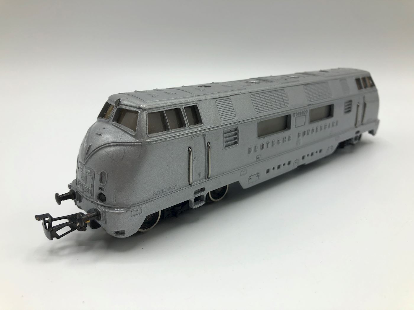

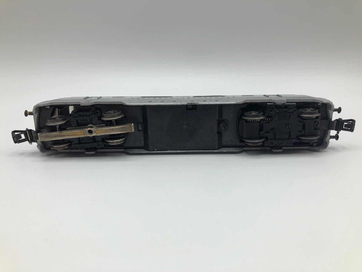

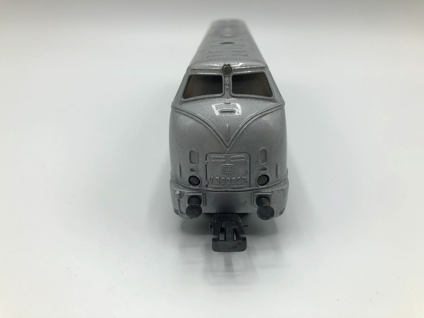

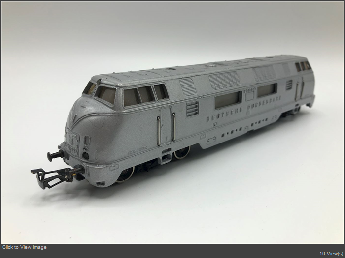

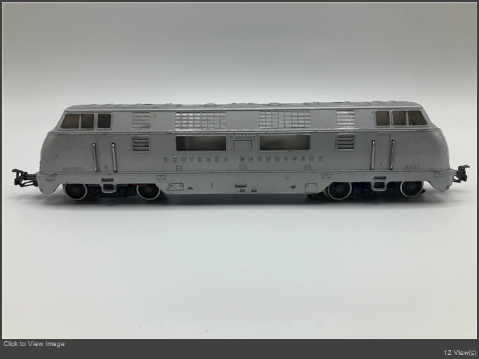

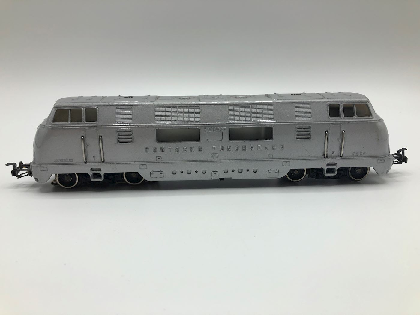

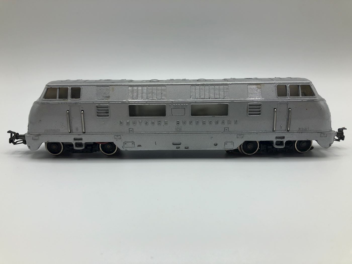

I am going through my collection...selling some...keeping some...but I have a question about a certain locomotive.
I believe it is a 3021 (as that is on the train), but it is all in silver. I have not seen another one like it. I am thinking it has been custom painted, but that seems unlikely. Is it possible that all the red/blue have worn off?
If you could take a look and let me know, that would be appreciated!
Thanks.
Offline IanC
#20 Posted : 21 January 2020 03:36:17(UTC)
IanC
Joined: 05/03/2016(UTC)
Posts: 371
Location: England, Bedford
My guess would be that someone has used paint stripper to take it back to the base metal. Can I recommend WD40 for freeing up seized wheels and improving electrical contacts? And can I point out that some oils will damage your paintwork so use sparingly and wipe off the bodywork.
May I say how impressed I am by the help, knowledge and generosity shown by the members above. What a great world-wide community to be a part of. I'm proud to be associated with you all.
IanC
thanks 1 user liked this useful post by IanC
#21 Posted : 21 January 2020 04:56:26(UTC)
Posts: 4,061
IanC
I agree with this. Those 3021's are heavy, and were quite popular so there's no shortage of them and they are often found play-worn, paint chips, dents etc.
It was either stripped back as a possible candidate for repainting, or just left like it is because they liked the look of it.
Without knowing how it looked prior, it's anyone's guess whether it now looks better or not. One thing is certain, a 'bad' repaint will always look worse than even a very rough original. BigGrin

This is how a 3021 should look.
#23 Posted : 21 January 2020 08:33:35(UTC)
Posts: 3,647
Could the 3021 be part of a "Metall Edition"?
I know that Märklin sometimes would do this for displays for shops. (and collectors?)
#24 Posted : 21 January 2020 09:17:25(UTC)
Posts: 4,061
Lol - yes I know how one 'should' look, I was meaning without knowing how that specific one looked - prior to stripping LOL LOL
#25 Posted : 21 January 2020 09:37:25(UTC)
Lol - yes I know how one 'should' look.....
I know that you know what a 3021 looks like, but then I didn't make that post for your benefit....Wink
Offline nhumps
#26 Posted : 21 January 2020 11:32:16(UTC)
nhumps
Joined: 17/12/2018(UTC)
Posts: 128
Location: Kapiti Coast
Not quite the same road number there ;)
#27 Posted : 21 January 2020 21:47:24(UTC)
Posts: 8,620
No, it is too early for a metal edition, they didn't come until the MHI items started IIRC, and this year is the 30th anniversary of MHI, the loco in question goes back to the 1960s.
Also Metal Edition models are given a silver paint coat, the are never the base casting metal in appearance which is what this one appears to be, or else has had a coat of battleship grey paint as it is quite shiny (see the reflections of the lamps on the noses).
