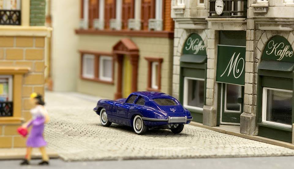

Each house gets the light, the larger it has several
In addition, they also get a new color to avoid plastic shine and various details
UserPostedImageUserPostedImageUserPostedImage
Turning on the light gradually, from dusk to full night

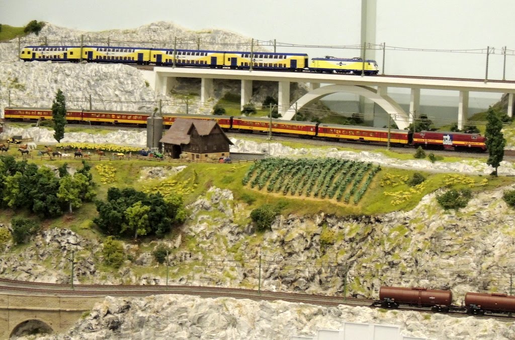

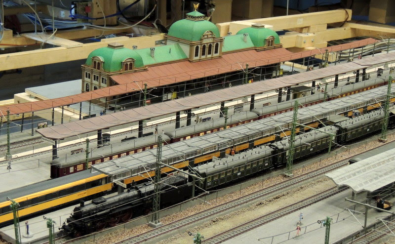

Trains run from all countries to the layout
It is more interesting to visitors than to see trains from only one country
Trains from all epochs also run
The curious always explain from what period a train was traveling and in which country it was traveling
UserPostedImageUserPostedImageUserPostedImageUserPostedImage
thanks 9 users liked this useful post by 1borna

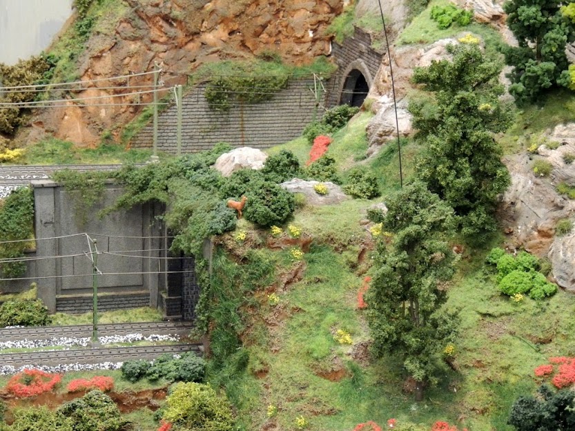

#155 Posted : 08 August 2019 21:17:22(UTC)
Posts: 2,323
Neat.
Can you or someone explain what is going on with this cantenary and mast? Am I seeing that correctly, that the wire makes a jump to the side at the mast arm?
Offline 1borna
#156 Posted : 08 August 2019 21:23:33(UTC)
1borna
Croatia
Joined: 21/12/2012(UTC)
Posts: 1,588
Location: Hrvatska
Thanks for the good remark!
I'll let the guys fix it if it's not already?
When mounting figures or other work, it is likely that someone stuck to the wire and moved it.
thanks 2 users liked this useful post by 1borna

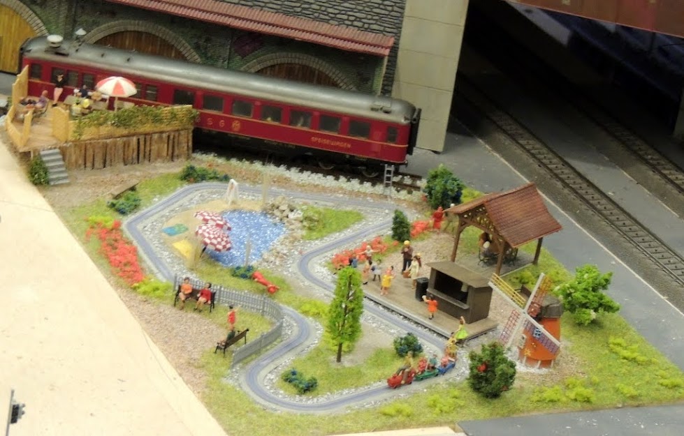

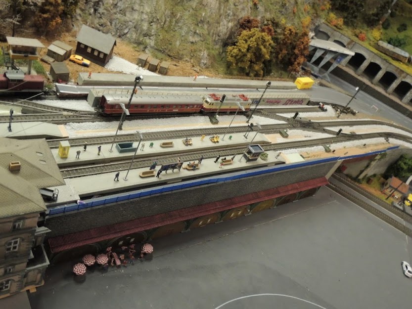

At this station is working on the details
UserPostedImageUserPostedImageUserPostedImageUserPostedImageUserPostedImageUserPostedImageUserPostedImage
A small facility was built nearby
thanks 6 users liked this useful post by 1borna

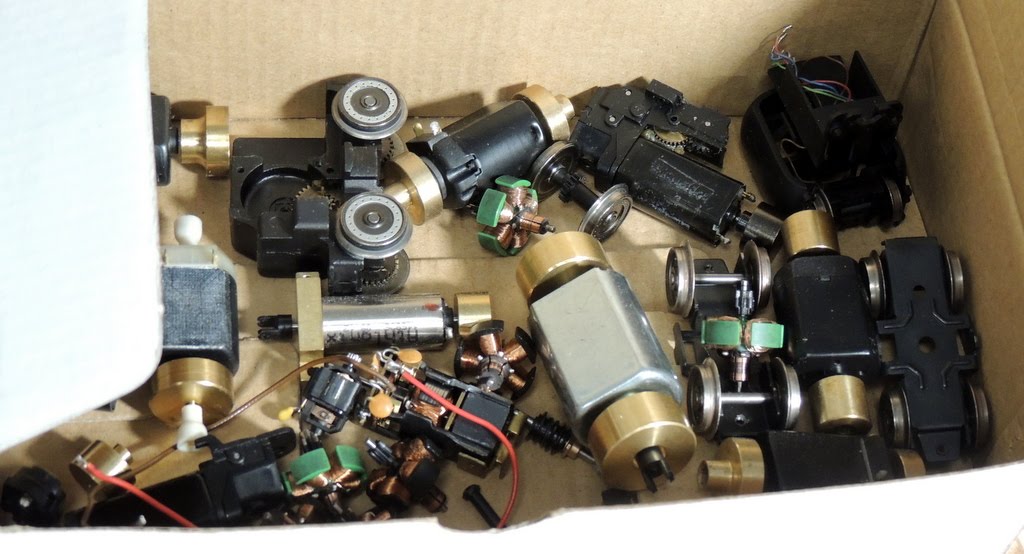

UserPostedImageThe last part of the workshops is intended for rougher jobs
For precision jobs, you must have the right tool
UserPostedImageA larger box was created as a carrier for battery train controllers
Young children often do not want to return controllers when their ride is over, so they cannot take it this way

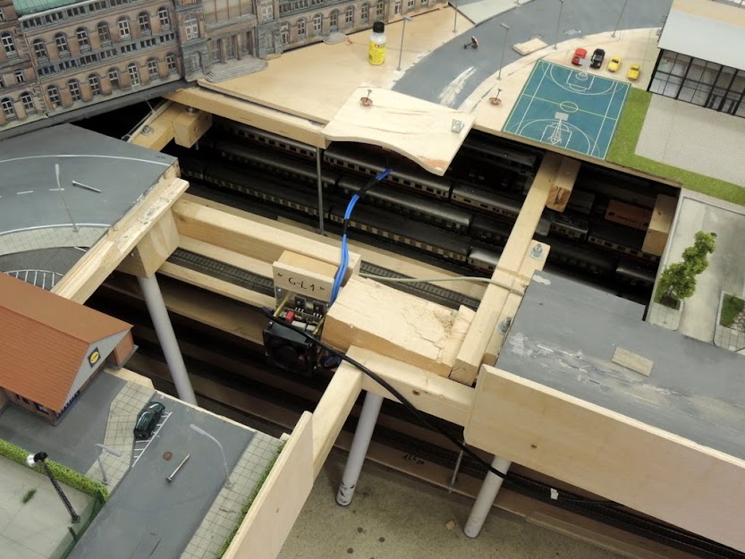

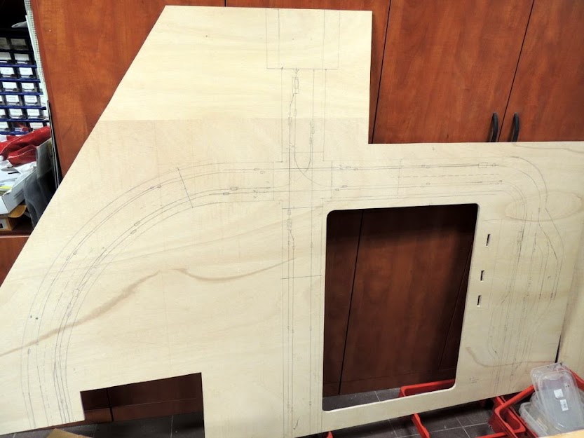

The construction of another major crossroads has begun
Numerous stop points, space for stop magnets and various sensors need to be carved
When the guide wire is inserted into the notched grooves, everything is swept and subsequently sanded
Only then on the down side does the extensive job of setting up a high-frequency field to power the vehicle follow

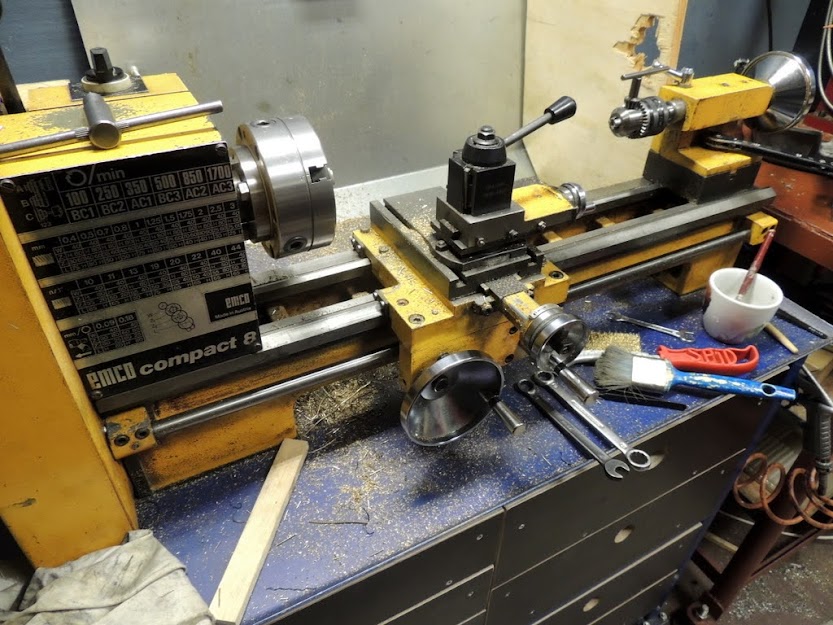

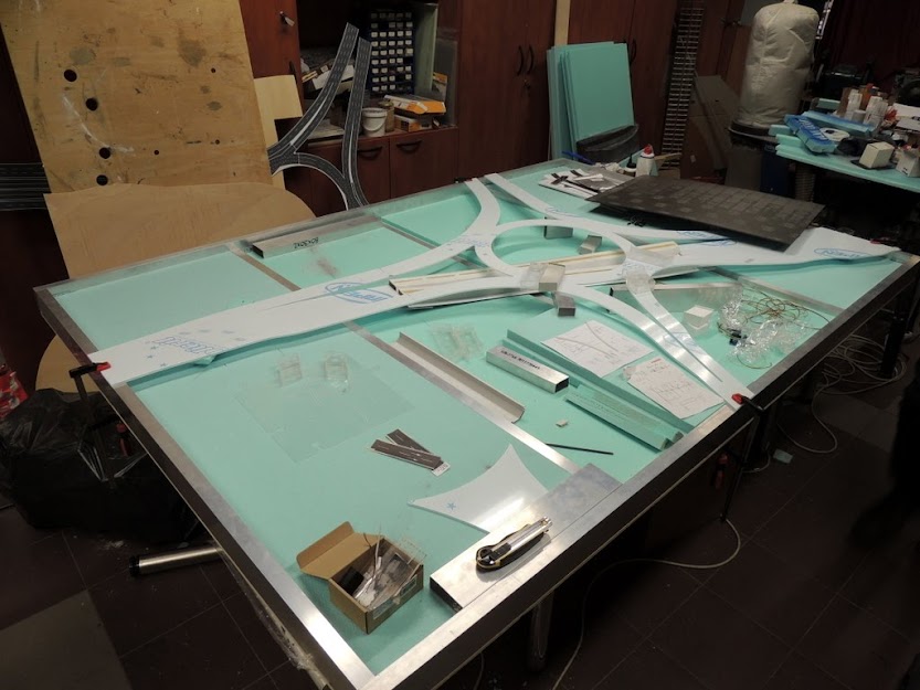

One CNC machine was purchased
It is quickly complex and tried and tested
A little later it was completed
And there is always work for a lathe
The workshop becomes too small
Especially when doing big projects
(Layout of new road rotor in Zagreb is at scale 1: 220)
thanks 5 users liked this useful post by 1borna

The Advent crowds are gone, so it's normal now. Part of the team is with visitors and others are completing some projects or doing new ones
Who would say that there is so much under the road?
Everything is made very neat and precisely connected

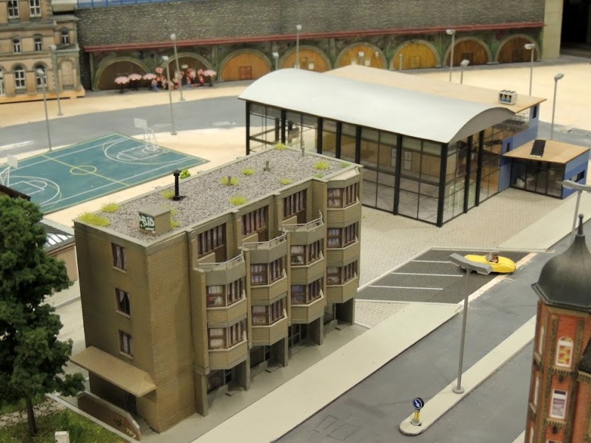

The new town square has been illuminated

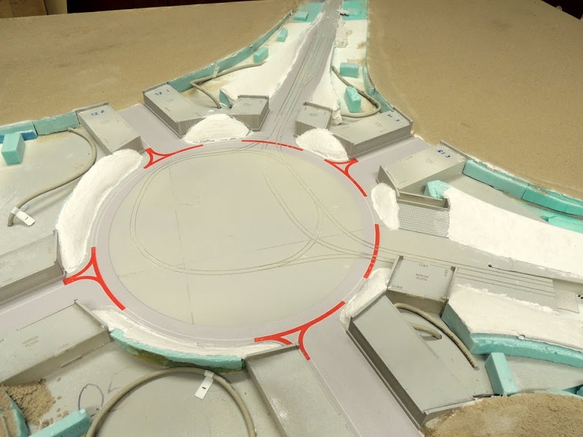

I will continue to show the design of the rotor

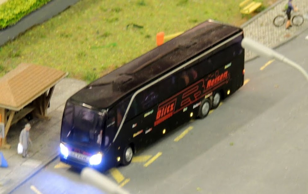

Numerous trams and buses were built
They needed to paint them and bring them lighting
Other road vehicles are from the standard Z program
Brass etching made the supports for traffic lights
Everything was done according to the design of the situation on the right rotor
This was followed by a demanding signaling connection (rotor inverted)
thanks 4 users liked this useful post by 1borna

In addition to the school was formed and sports hall
There is also a statue of an athlete in front
There is one parking lot nearby
and one nice old building

2 more road rotors will be made, this time at a scale of 1: 500
Traffic light and road sign carriers are made of etching
Vehicles were made with 3D printing

Relief is being done
And here they are ready
UserPostedImageUserPostedImageUserPostedImageUserPostedImageUserPostedImageUserPostedImageUserPostedImageUserPostedImageUserPostedImageUserPostedImage

Earlier, this intersection was removed for repairs
Some of the numerous routes were too close to each other, so it was possible to make a wrong turn
More vehicles had to be tested on various routes
Below the intersection is a chain that moves pedestrians on the surface with magnets, it needed to be slightly tightened and lubricated

Location: Hrvatska
One rail cleaning car driving on the road?
And that is possible when the Backo team processes it, also has wireless power
There are about 300 meters of roads on the layout, a good part of which is in tunnels and inaccessible, so this way of cleaning dust is welcome!
One day when everything is in use there will be over 100 different vehicles on the roads
All have wireless power supply, decoders and are controlled via infrared rays
This does not drive but moves by hand and serves to measure the frequency and strength of the current field on the road

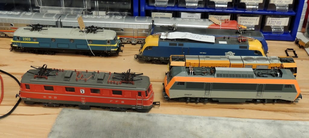

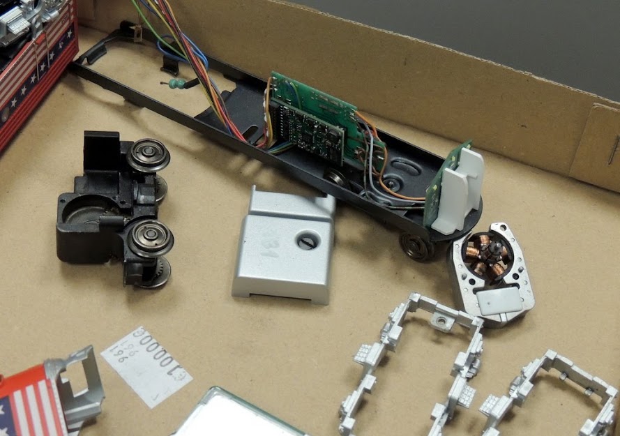

Locomotives run on the layout for several hours every day, so now there are close to 200 because there are always at least 10 of them in service.
Some locomotives also need to change the rotor because the brushes "eat" the collector after several changes.
Newer electric motors are not repaired but replaced

A layout of any size without small details would look unfinished
Figures and vehicles give life
This certainly includes various advertisements
We can work and improve all these small details over the years
Thanks to Preiser for providing us with countless figurines for all needs

Location: Hrvatska
I haven't presented compositions for a long time
Upstairs there are always more on hold

Recently, a small amusement park was removed from the layout for minor landscaping
I took the opportunity to film it from all sides
The scale of the garden rail is approximately 1: 500
The drive from above looks like this

The locomotive service table is always full
There are always about 150 compositions (up to 1,000 wagons) on the layout, so you should always have a reserve
The program keeps records of the operation of each locomotive and after 40 hours warns that it is time for service
Unexpected failures can also occur, so the model is repaired earlier
Models are becoming more complex and more difficult to repair, so it is necessary to have special tools
The latter is self-made
Large machines come in handy for making such things
Records of use are also kept
thanks 1 user liked this useful post by 1borna
