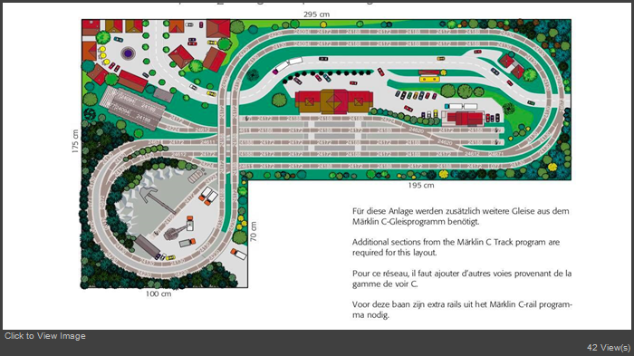

i would like to use this track plan:

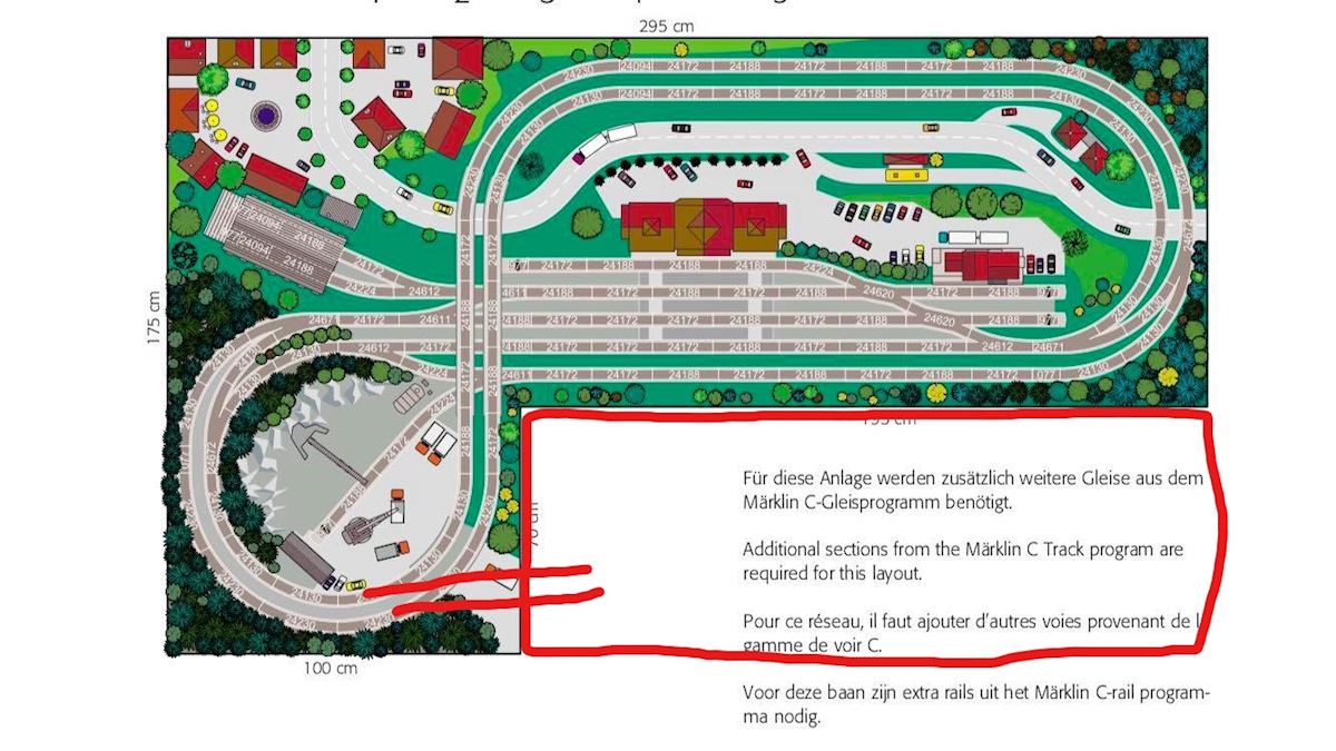

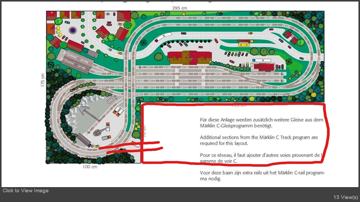

and add some extra shunting on the bottom right around here:
the idea would be that the loco pulls coal or ore from the bottom left, drives some circles and then drops the cargo at the bottom right were a shunting loco moves them around to "empty" them. I have no idea what would be a good part to add there as i have no experience tbh in adding stuff. If i would be building it now it would take up some empty space. Thx in advance

Please remember that you also need access. Comfortable arm reach length is normally 60 cm. By "sealing" the area marked by the red frame you would make your life miserable.
