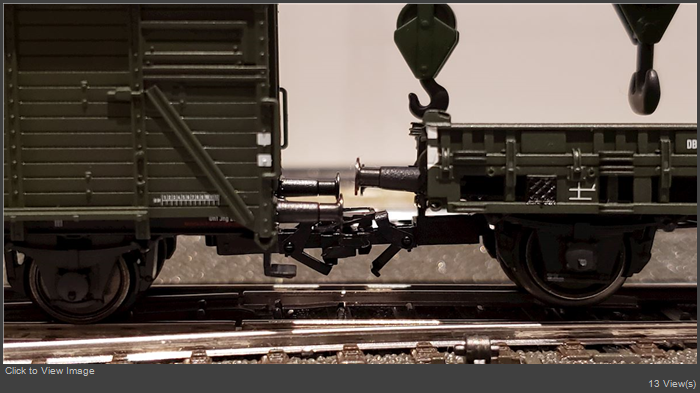

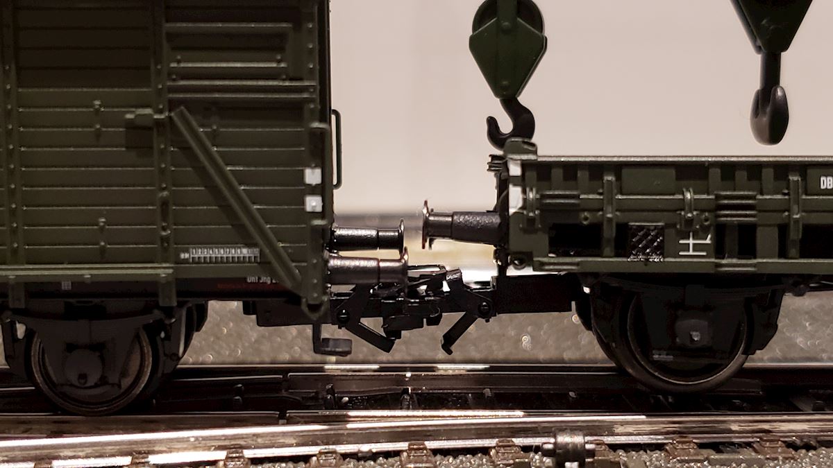

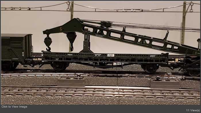

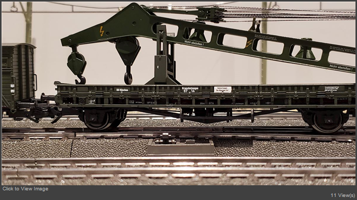

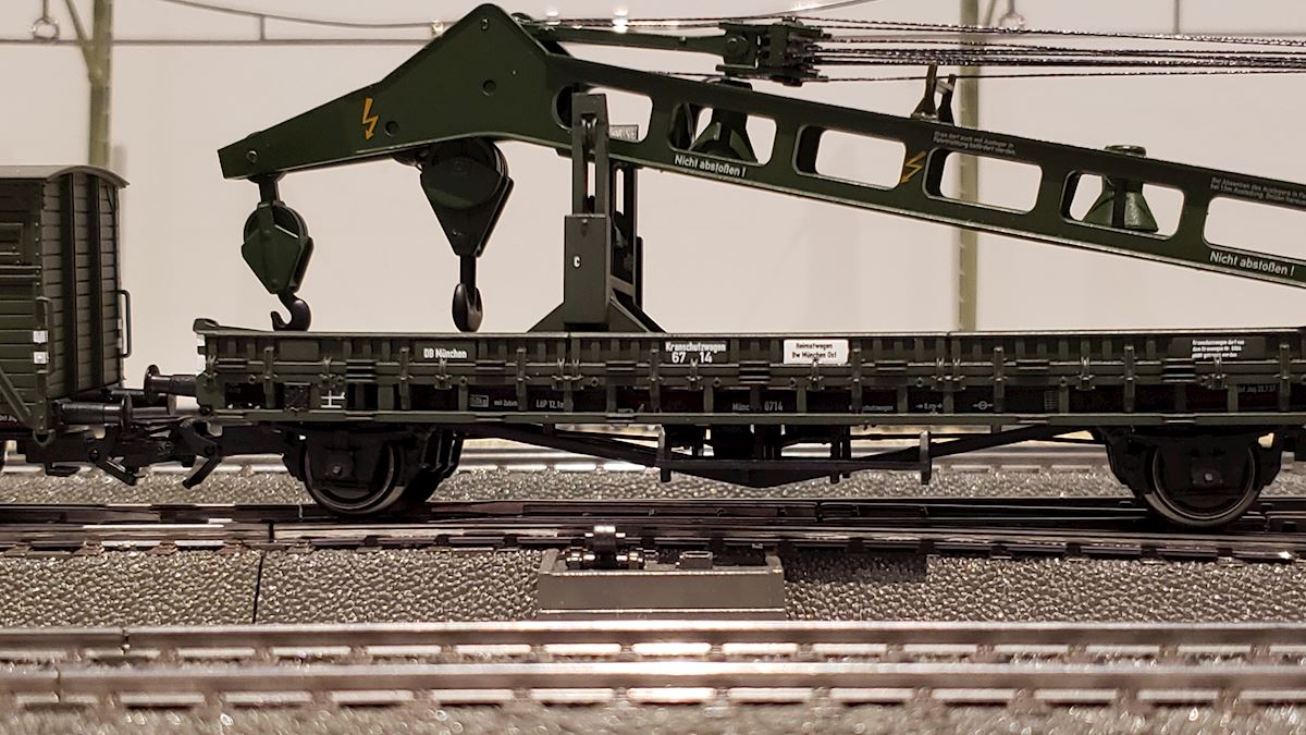

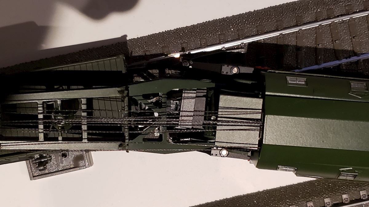

Thanks for your note. Somehow my experience is different. From the photos attached the flat car tilts when negotiating regular turnouts when the boom is in rest position. At low speed it tilts and could derail at higher speed. Agree the boom swivels on curve but apparently not enough to negotiate the turnout without tilting the flat car. Any advice?
On another topic, the crane housing rotates very fast and it is difficult to align the crane housing straight with the bogie. Can I adjust the housing rotate speed? And would a housing not exactly aligned with bogie affect boom swivel angle?
