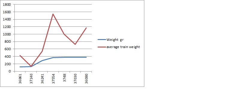

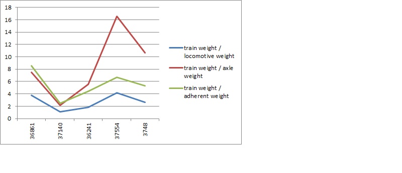

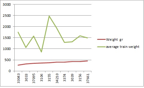

And now some graphics, the horizontal axis is the catalog number of the locomotives, I'm somewhat puzzled because I expected to find some pattern of behavior, and it does not seem that there is, in the graph are the locomotives with special engines (DC Can motor, Faulhaber, Bell-shaped etc) tested so far

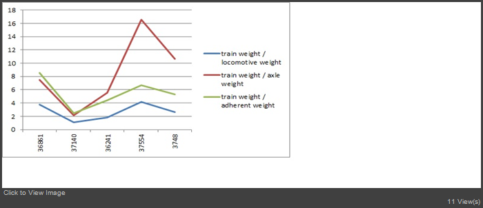

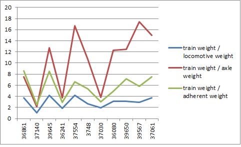

And now some graphics, the horizontal axis is the catalog number of the locomotives, with special motors, like DC Can, faulhaber, bell shaped etc.
tested so far

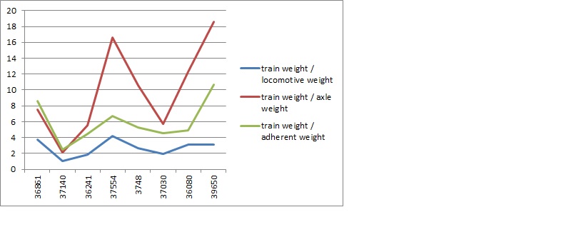

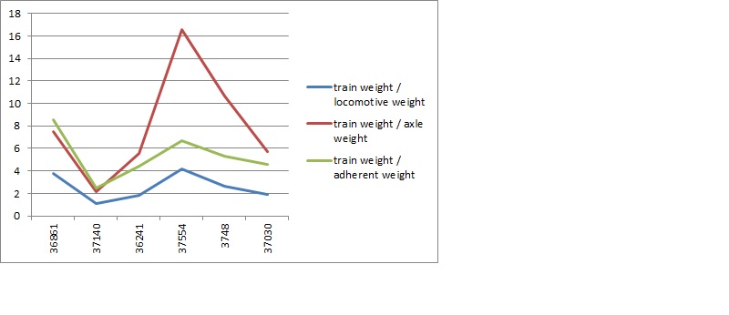

And now some graphics, comparing locomotives with special engines tested so far.

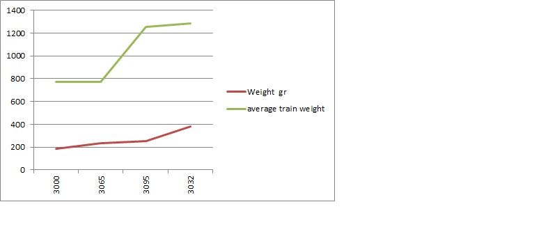

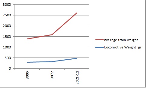

And now some graphics, comparing locomotives with SFCM engines tested so far.

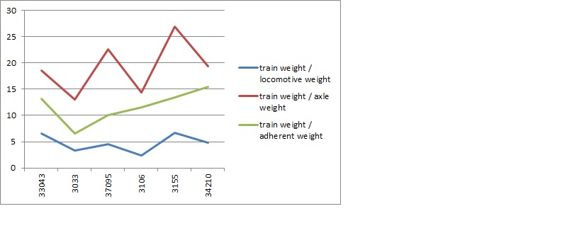

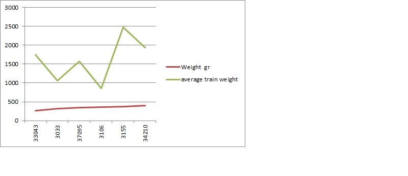

And now some graphics, the horizontal axis is the catalog number of the locomotives, with special motors, like DC Can, faulhaber, bell shaped etc. tested so far.

34210
Hello everyone
The next locomotive with 400 gr of weight, is the V140 märklin 34210, this locomotive is entirely of metal and originally brought a delta decoder, but the result was not satisfactory, and I contacted Huib Maaskants because he had an article of the conversion of the Trix model of this locomotive, and I converted my 34210 to 5 pole motor and decoder Lokpilot v3, to know more about this click here.
Its features are:
Weight: 400 gr
axle arrangement: 1’C1’
drive axles: 2
weight-bearing axles: 4
axles with traction tyres: 1
weight/axle: 100 gr
Adhesive weight: 125 gr
Motor type: DCM 5 poles
The test results are:
R1 pulling: 17 cars, train weight: 1842 gr
[YOUTUBE]
[/YOUTUBE]
R1 pushing: 10 cars, train weight: 1372 gr
[YOUTUBE]
[/YOUTUBE]
R2 Pulling: 24 cars, train weight: 2682 gr
[YOUTUBE]
[/YOUTUBE]
R2 Pushing: 17 cars, train weight: 1842 gr
[YOUTUBE]
[/YOUTUBE]

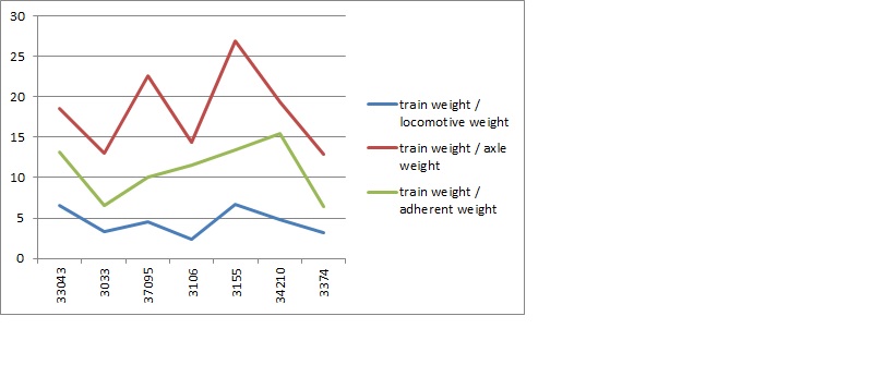

And now some graphics, the horizontal axis is the catalog number of the locomotives, with DCM motors tested so far.
Antonio Martínez
www.raildigital.es/davidruso
thanks 3 users liked this useful post by amartinezv

And now some graphics, the horizontal axis is the catalog number of the locomotives with DCM motors tested so far

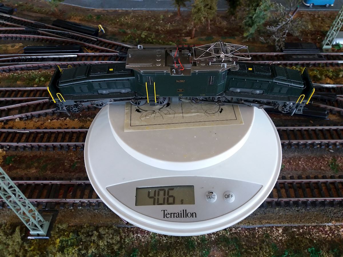

39567 1st part
Hello everyone
Several weeks ago I uploaded the last test, I have not forgotten this thread, quite the contrary, I have been doing many tests. This has begun with the tests of the kroko insider of 2018, the Ce 6/8 #39567, it must be said that this locomotive is a wonder, the amount of details that makes it unique, in addition it is equipped with two engines, each in one of the bogies, and has many, 28, functions, most sound, but also raise the pantograph, telex couplings, lights and sounds. The traction tires are in middle axle of the bogies. The ride is smooth and quiet. It is a must.
Its features are:
Weight: 406gr
axle arrangement: (1’C)(C1’)
drive axles: 6
weight-bearing axles: 8
axles with traction tires: 2
weight/axle: 51 gr
Adhesive weight: 152 gr
Motor type: DC can motor
It pulled about 20 cars through the section of R1, however I did not record it on video and when I went to repeat the test the locomotive began to skate at the exit of the curves in S of R1, I removed one car and another and another until you get to 12, and this is the video

This has made me rethink these tests, until now I had used the wagons that I currently have in the layout. But I realized that mixing short couplings with the relex couplings of marklin does not seem a good idea, and also that the elasticity of the short couplings of marklin is not good for these tests. So I have chosen the 46xx series wagons of märklin as well as the 24 cm cars, they weigh quite a lot and I think they offer good circulation characteristics, and I am currently testing with this material. I have to choose carefully the position of each wagon inside the train, but I have managed not to derail, then you have a video with the locomotive 39567 dragging a train of 18 wagons on the section in R1, and can with more!

Location: Madrid,
Antonio,
Its a dismal weight of 402g, you would think its all made of metal the weight would be higher., also 4 drive axles what happened with the other 2 ?
Hello
I weighed the locomotive again and obtained a result of 406 grams.
As for the axles of each bogie, I was wrong, and all axles are supported on the track, therefore has 6 axles with traction, in addition the grip rings are on the central axis, I have corrected the previous post data.
I will be out for the next few days, when I come back I will continue with the tests.

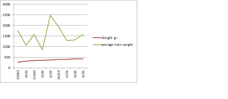

and some graphics
Antonio Martínez
thanks 2 users liked this useful post by amartinezv
