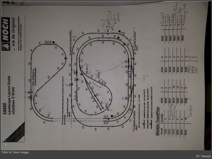

Hi, Did you ever find the wiring plan for the Noch Cortina layout you were looking for? I also need one. To lay the track I used an English version of the Noch 59880 Gleisplan (track plan) from the Noch website and followed it exactly, but there are no wiring instructions that I could find on the Noch website or elsewhere. The track plan is in German at Noch.com with the Cortina Layout. If a wiring plan for this track plan exists it would really help.

This is the track plan I followed. It is on the Noch website. How to wire the signals and isolation track is my biggest roadblock. I'm not even sure there are enough signals and circuit tracks to control two trains on the inner loop. I believe the two circuit tracks shown on the inner loop control the 8992 crossing gate. I also have a copy of the track plan in English which I got from a Marklin dealer, Z Scale Hobo. I haven't put down roadbed or ballast so I can still make changes. If I get any info on wiring I'll pass it along. Guide to Z Scale has a lot of the basics.

This is a second Cortina track plan with ten circuit tracks, five 8945 relays, four isolating tracks, four 8939 signals, etc. It was sent to me by a Marklin dealer but still no wiring information. Can anyone help with wiring hints for either track plan? The track plans are supposed to be for three train operation, two on the inner loop. This track plan may have used Noch Automatic Push Button Switches 51030 and may not work without it. I need to know which circuit tracks go to to which signals, which go to the 8992 crossing gate.

Hi Bob: Sorry to hear you're still stuck on this.
So in the latest plan you've posted, the 8539-8529 are used to control the 8992. These are circuit tracks that work in the same manner as the ones shown in the 8992 instructions. http://zscalehobo.com/ph...992_instructions_zsh.jpg
We should be clear on the 8992 now.
Next, you want auto operation with the two 8939s. You need to do is create a block either using 8588s on ONE SIDE or using an isolating joiner from 8954 set to do the same isolating function. Then you simply wire as shown in this diagram:
https://zscalehobo.com/p...244_with_89391_zsh_1.jpg
*Note that 7244 can be replaced with 8945 per my discussion with Marklin service.
I'm not sure what else you need. This has been provided to you a couple of times and the drawings in the images here show how to wire.
Don't forget the especially interesting and applicable image I sent to you in March ... this pretty much says it all:
https://zscalehobo.com/p...s/marklin/0318190522.jpg
I'm here to help. I did walk another customer through this recently and his setup is working perfectly on a Traunstein - same signals, same wiring dilemma. Direct link to his video: https://www.facebook.com...alink/10157696218334919/ (requires Facebook membership and Z Scale Model Trains group membership).
