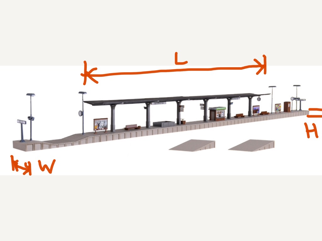

The Internet is great for ordering stuff, as my nearest MR shop is 220 km from home... However, often the product descriptions on the net are missing information. I’m interested in the Vollmer platform 43536 H0 ”Bahnsteig Seeburg”. However, I would like to know
the length of the platform roof (L),
the height of the platform (H),
the width of the platform (W1) and
the width of the platform roof (W2)
The Viessmann page - and other sites - indicate that the width is ”6,5/4,8” cm, and there is nothing in the manual that explains further.
Anyone out there who has this platform - or the more or less similar Vollmer 43535 H0 ”Bahnsteig Rheinburg” who could clarify...? As I’m laying the station tracks, this would be great to know!
Confused
(I also plan to use the Auhagen 41200 ”Bahnsteigkanten 13 mm” and make a custom platform, in combination with parts from the Vollmer platform.)

Well, judging by the dimensions given on the Viessmann page I would say your W1 is 6.5cm and W2 is 4.8cm, H will be suitable for HO models, and L could be worked out from the overall length of 96cm by counting the vertical ribs in the platform edge and working out how many there are in the length of the roof versus the overall length of the platform, but bear in mind the 96cm probably includes the seperate ramps for the ends of the platform.

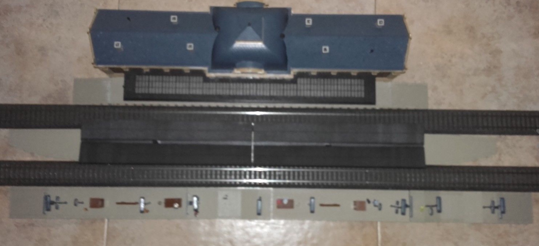

I believe this photo from a set on eBay actually would imply the opposite, i.e. roof 6.5 cm and platform 4.8 cm?
Oh, OK. That would mean the roof has to be high enough for coaches to go under it.

After purchasing this item, I can confirm the following:
the length of the platform roof (L): 500 mm
the height of the platform (H): 12 mm
the width of the platform (W1): 48 mm
the width of the platform roof (W2): 65 mm
I thought the roof was longer. I will probably buy a "Rheinburg" platform to extend this to 750 mm, as the total platform length is approx. 1600 mm...
