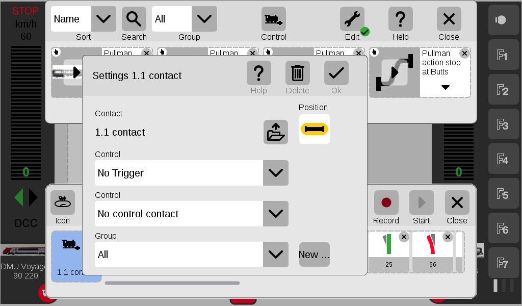

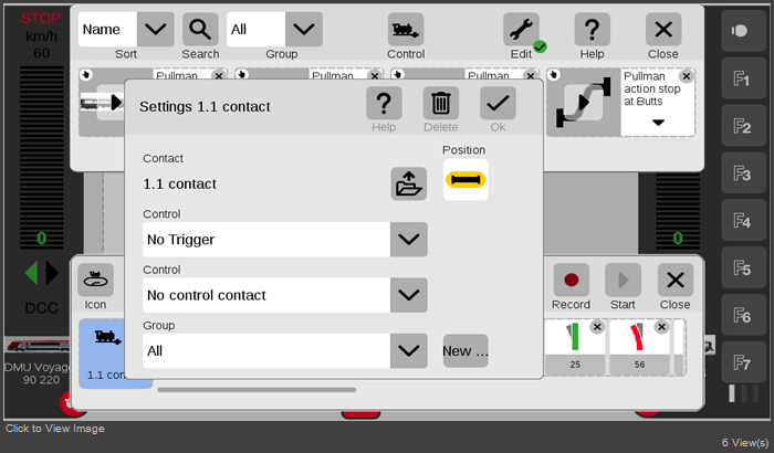

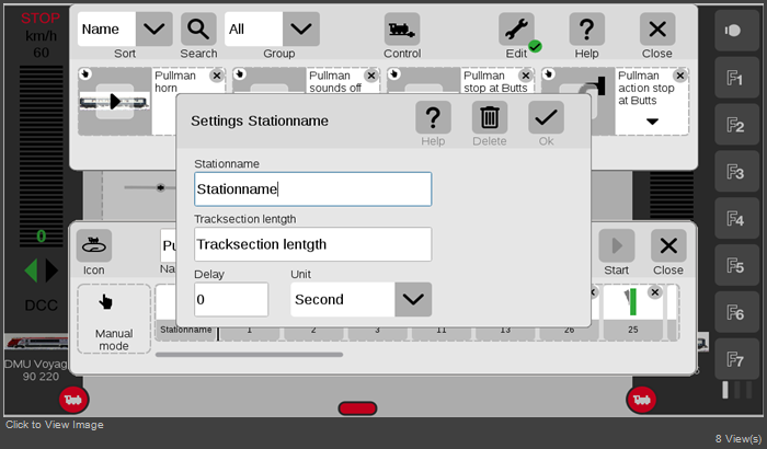

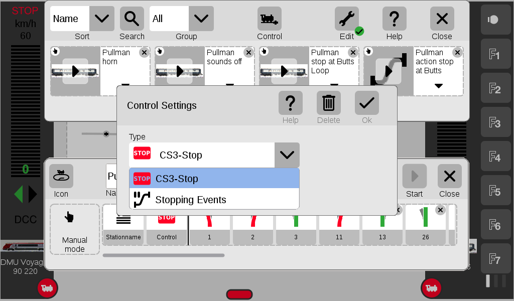

I will enclose some screen shots showing the areas that are different from the manual in the hope that people will comment if they have some answers. See my comments below the photos.
E349B2CA-673F-4046-AB9A-394C08CA8D84.png27E21A93-0F1D-41A8-A70F-BAE902E615B4.png87E081BF-D8D5-4D83-B1BC-F28225E0C77B.png29653B03-E098-4E09-884E-377E26E99EA2.png1A7E9CA1-F579-4D8F-AE9F-AE1F531D28DC.png873A5C3C-5EB3-49A9-B71F-A6DE26DB2253.png

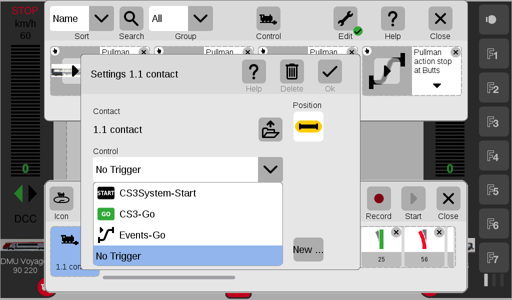

1. Notice events-trigger - what does this do the other triggers are obvious
2. What does control and group do?
3. What are the logging levels and what size is needed?
4. What does events advanced mode do?

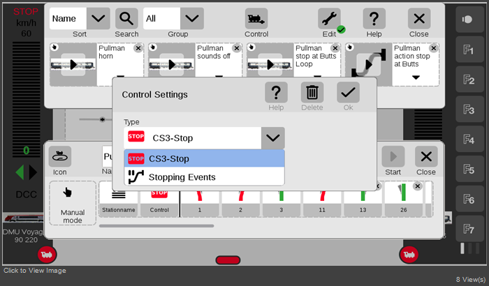

5. Why would you need to put in an event a command to stop events?
6. This does not seem to do anything?
Any help would be appreciated.

Offline siroljuk
#7 Posted : 03 February 2019 14:34:22(UTC)
siroljuk
Joined: 29/10/2010(UTC)
Posts: 377
I think (for me anyway) they have over complicated the CS3.
Still like the controller though.
Hi David and John.
Please remember that all functions which can be seen at the moment don't work YET.
I have studied CS2 and CS3 Events ( earlier they were Routes) almost from the beginning of CS2 was published. I have noticed that Märklin peoples way of work seems to be quite odd.
I imagine that they might design fine features for their new devices but they will not publish they thoughts before they make some programming and then they update devices but not any kind of instructions nor any information how they new updates should function.
Events are the most complicated features in these new computer based control devices. I have seen that there are many fine ideas ( like complicated conditional features of triggers) BUT they are not ready yet.
We have to study and make different kind of testing and learn how these features might respond. It is time consuming but, at least in my opinion, very very teaching.
In my opinion: When you start to make events ( routes) you should decide before you do anything, what exactly you want. How you think event should steer your Loco and how Loco should respond.
After you are sure what you want then just start to make and test event and learn.BigGrin BigGrin
There are bugs at least in CS3 control devices and when you make much work with the device I sure you; you will learn when your testing failure is up to your doings or they are due o CS3's bugs.
Meaning or purpose of those triggers which was in John's question; it is difficult to explain because there is no proper document for how they should use.
Märklin Digital Club and there Curtis Jeung is the best Man to follow. He has wrote many Newsletter in which he explains many difficult features and maneuvers using Märklin devices.
I this forum there is in many threads attached 2018 newsletters which give you excellent information. I don't put those threads here because you can find them by using search feature of this forum.
( I hope you don't get angry, it really is good to learn how to use search; you will find much much information related to you searching key-words )ThumpUp ThumpUp
In the 2018 newsletters 4, 5 and 6 there are very good information about events in CS3.
And in the next issue 1/2019 Curtis promised to handle advantage features of Events.
Have fun everyone
Jukka

Well I try to do my best.
I deleted attached pictures and split up your questions to the systems relating pictures. In my opinion the pictures relate to 2 different sections. If it is not the case, please list for me the menue tree where are these points at the CS 3.

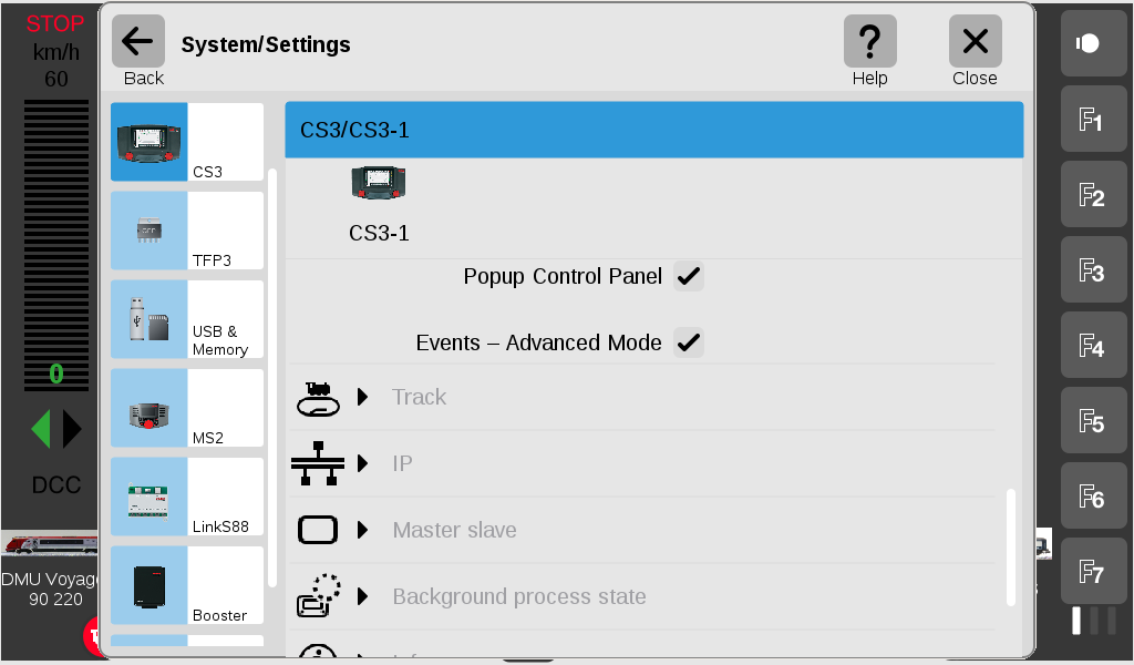

Before handling and/or setting events, systems settings has to be done first. Menue tree will be
System - settings - CS3/CS3-1
here you scroll down till you get to "popup control panel"
If you tickmark this field, you can get on your basic controlling screen with the layout, an additional control bar very quick for controlling any other loco from your loco list at the bottom on the screen. You select the loco, this one gets a lilac margin and then it opens another control bar for this loco in the screen. It looks like the bars at the right or left side of the screen, but this popup menue is somewhere on the screen. This function is already in the manual listed and has a short remark. See page 32 right side.
The next menue point underneath "events - advanced mode" is indeed not yet in the manual. In my workbook is stated this function was added with the software update 1.3.3 in summer 2018.
If you set the tickmark for this point, a small information window pops up, telling by setting this tickmark the handling for a CS 3 will be much more lavish and complex. More information about this complexity you get via the "?" "help function" in the lower left corner of this popup window.

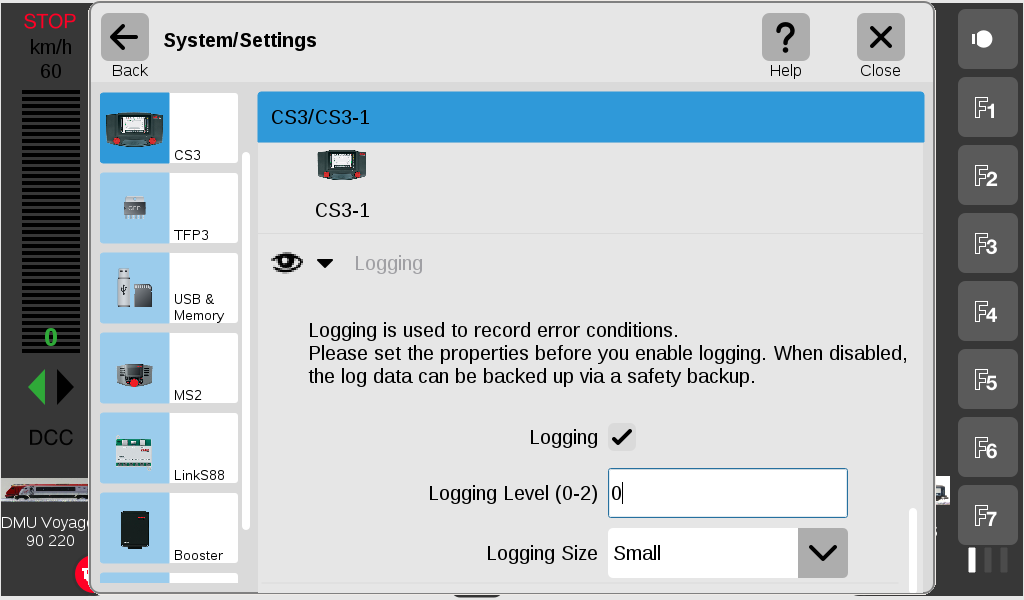

After "events - advanced mode" you scroll further down to the end of this window getting the menue point "Logging". This one is also not listed in the manual, because this is a section only for software developers creating a log-in file to identify a bugfix in the software.
It may happen, if you find an error in the software, Märklin service may request you to create via this function a log-file for sending it to Märklin. By this file they can identify a software bugfix in the CS 3, without sending the complete CS 3 controller to Märklin.
Well, I guess we all can forget this point, perhaps except our software developers at marklin-users.net. They are possibly the ones who can read such a file and identify a bugfix in the CS 3 software.

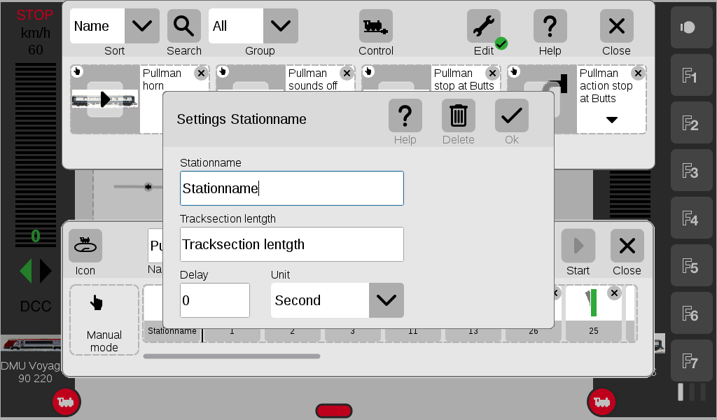

For the other pictures please write me by which menue trees you achieved these windows. Perhaps I can give you further help.
