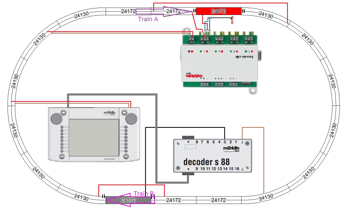

I need your advice in a simple matter that gave me some headaches for the past few days.
First let me describe my problem:

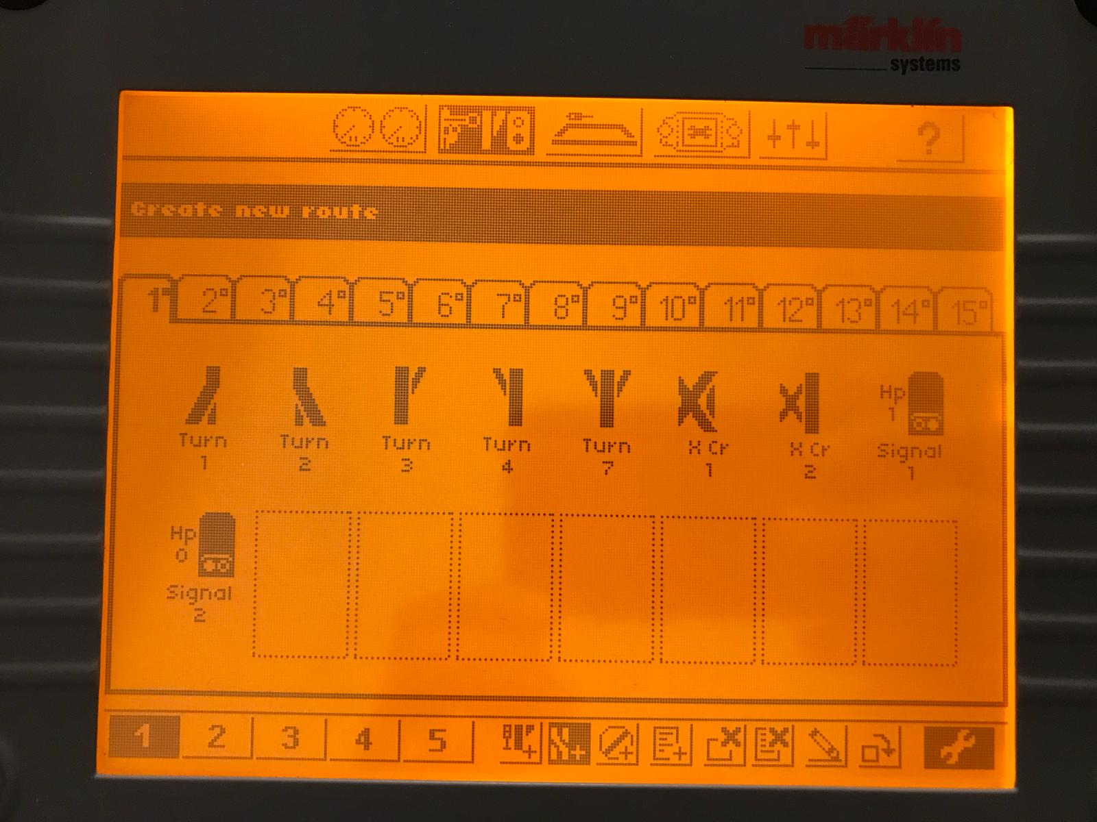

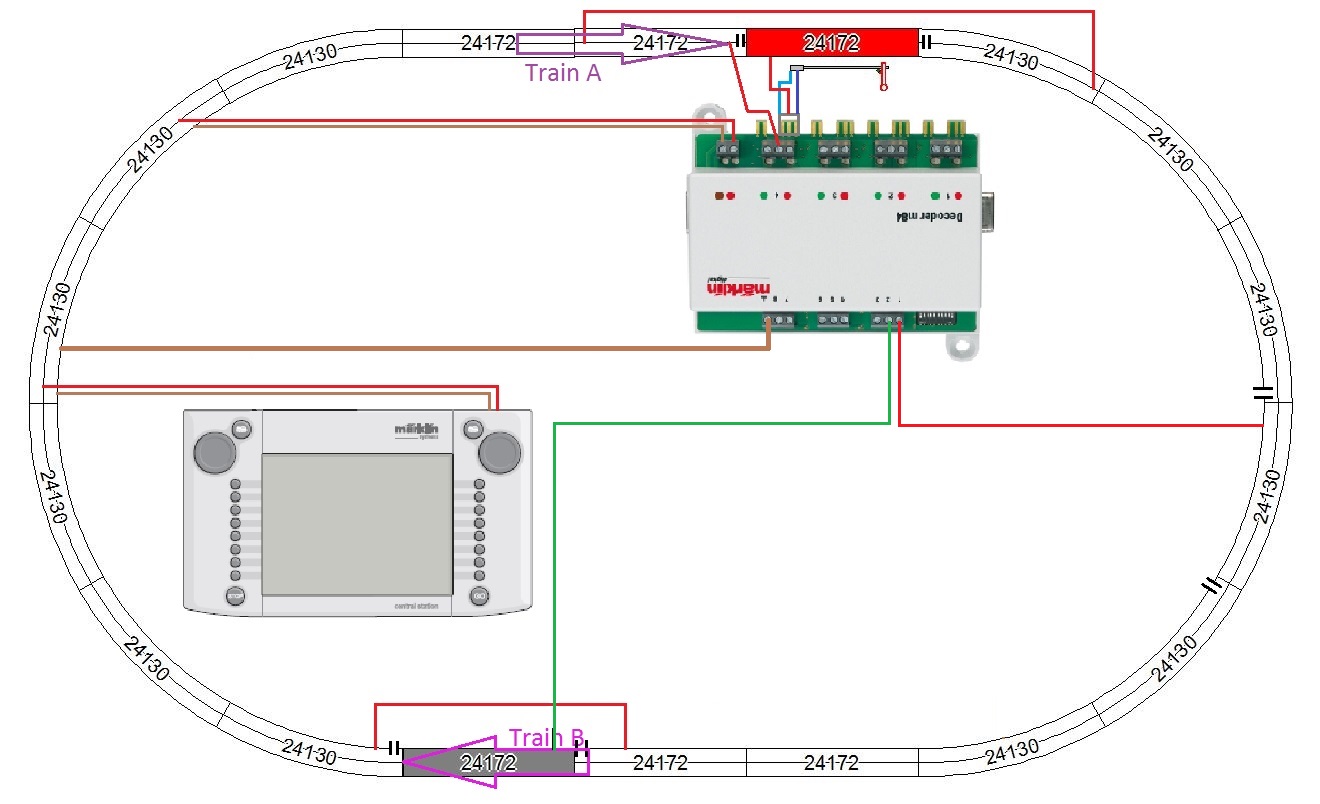

I have two trains (A and B) on the same track and I wand to use a signal and an s88 port to control the signal. The sequence of events that I imagined is something like this:
Starting position: Train A stopped at the RED signal light, Train B BEFORE reaching the s88 contact track.
SO: Train A is at the stop section Next to the signal > Train B reaches the contact Track and sets the signal to GREEN > Train A leaves the stop section > Train B leaves the contact track therefore setting the signal to RED> Train B reaches the stop section and stops > Train A reaches the contact Track and sets the signal to GREEN.... and so on.
Now, I have checked the signal and works on manual (I can turn it RED or GREEN from the Central Station), the feedback track gives a signal to the CS (the square associated to port #3 "lights up") but there must be something wrong that I am doing with the programming of the constraints and I hope you can help me here:

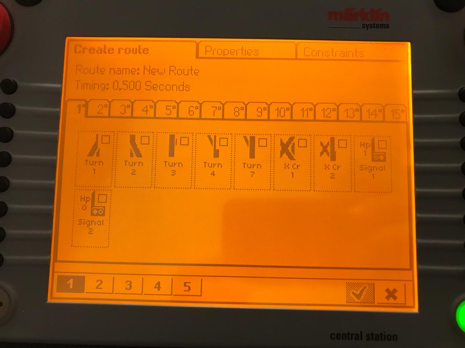

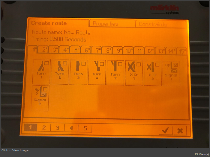

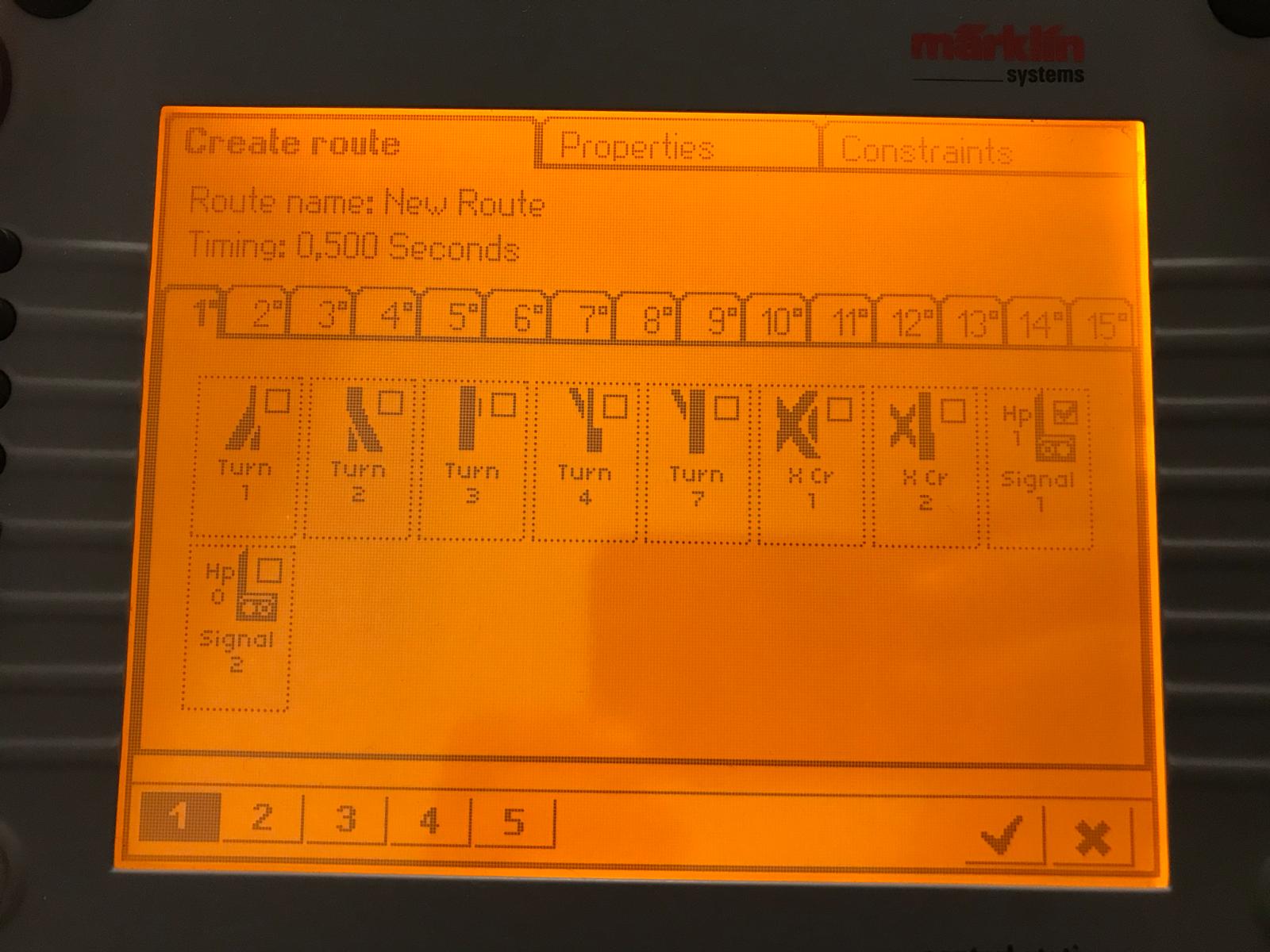

My steps are:
Go to the CRREATE ROUTE panel
Select NEW ROUTE
Select the SIGNAL and the GREEN color of the signal
Name the route

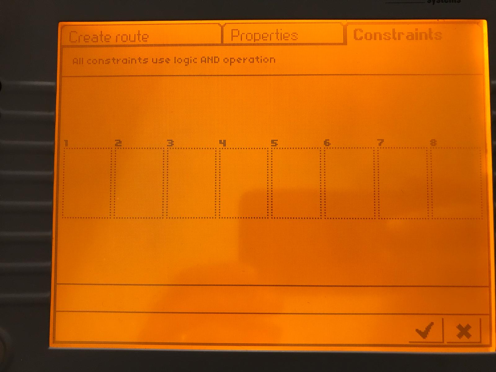

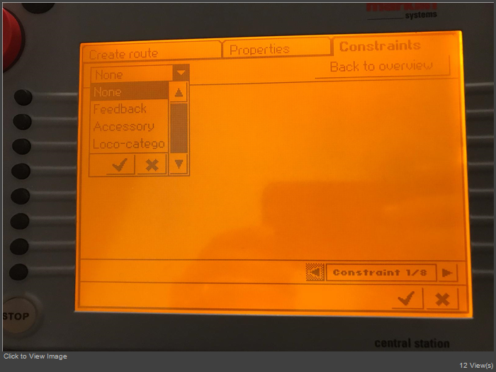

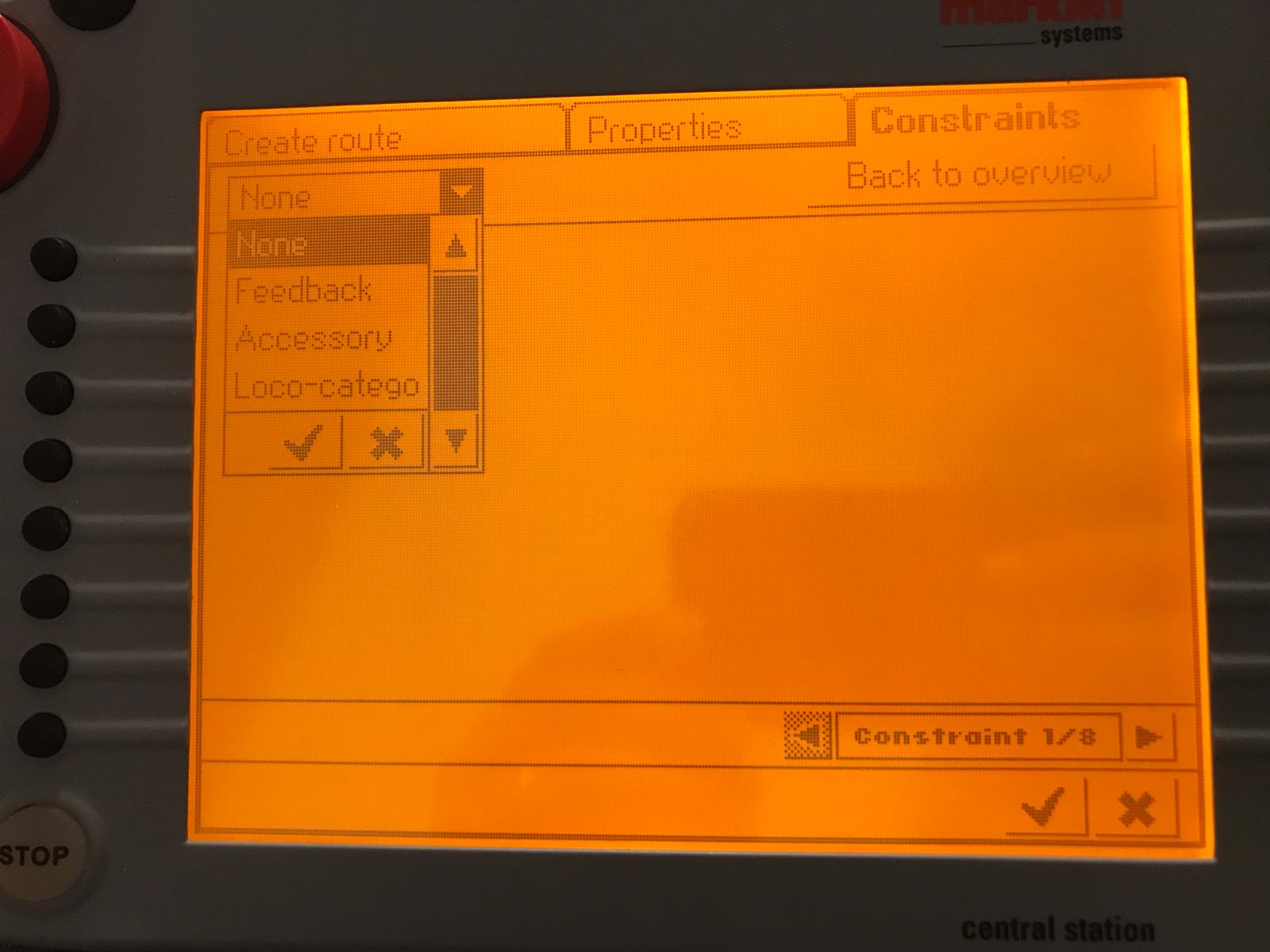

Go to the Constraints tab and select the first constraint
Select Feedback
Select the module and the port
After doing all this, if the Signal is RED and a train passes over the detection track, the signal doesn't turn green, or, If the signal is green and a train leaves the detection track, the signal doesn't run red.
Any advice?
Thank you!

Hello,i have no experience with CS1. But i assume that feedback is going to port 3 in the S88 module?
Offline Mmagda
#3 Posted : 29 November 2018 01:32:53(UTC)
Mmagda
Joined: 03/11/2018(UTC)
Posts: 41
Location: Brandenburg, Potsdam
...i assume that feedback is going to port 3 in the S88 module?
Yes the feedback track goes to port #3. Ports #1 and #2 are used for a shuttle train.
Thank you for the observation, I've corrected the diagram in the first post.

So far I am having trouble understanding the constraint function on the CS an how that works.
If I would see an example of how to program the CS to do what you described above, it would be very easy to understand and develop the routes for the rest of the layout.
I searched for tutorials but I couldn’t find any for CS Reloaded.
I’ve tried the ECOS instructions (they’re in English and the menu is very similar) but they too are very vague.
Guess I’ll have to play with the settings trial an error style till I get it right...

The problem was solved by changing the wiring.
I started from the wrong premise that I need to connect the feedback track to the s88 module instead of connecting them directly to the m84.
The following diagram shows the connections. I still have some issues but that's only with some locomotives/wagons and it's because they are not making good contact with the track.
Thank you Johnvr for the idea!
Now I have to figure out how to make a specific locomotive to activate a switch in order to change tracks

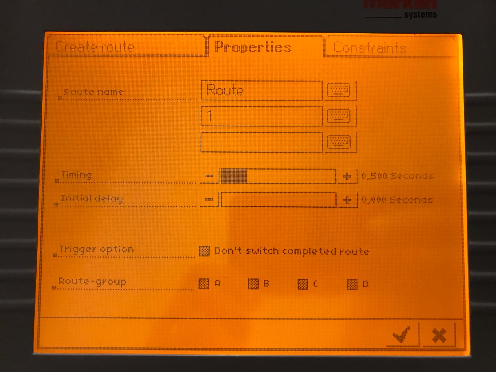

I thought of one more possibility for you to try with the CS1, where the Circuit Tracks are linked to the s88 and you use Routes in the CS1 :
In your one picture of the Routes under the "Properties" tab, there are 4 groups, namely A and B and C and D.
You need to assign each of your Routes to one of these Groups (ABCD), and then ensure that the Automation is switched on for that Group.
For example, you can assign your Main Line Routes to Group A, and activate these routes in Group A automatically, while Routes in Groups B and C and D are not selected to be activated. I think there is a setting to indicate which Groups you want to activate automatically.
Try that, and let us know.

I haven’t figured out yet HOW to program the CS in order to use routes to change signals Crying
RegardsBigGrin
As I said, I didn’t even managed to program that damn thing to do a simple task (use routes to change a signal). Using the Groups is way more advanced than I can understand right nowHuh
