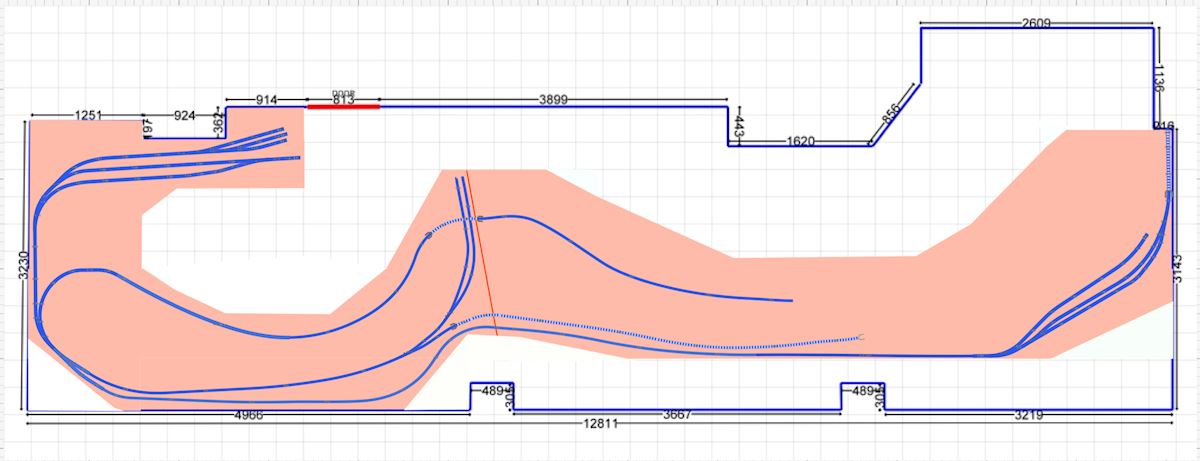

As I can't seem to PM John an Anyrail jpeg I will post it here. As I am using Anyrail if anyone would like an Anyrail file of the room let me know.
Please note dimensions are in inches.
Regards.

As requested here is a jpeg of my room with metric dimensions.
As stated I'm using Anyrail but I'm willing to purchase another track planning software to make it easier.

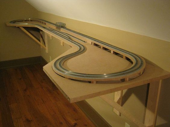

May I suggest you plan a layout that is capable of being changed in part or all without too much of a waste of both time and money?
I say this because I constantly change my layout because after a while I get bored with it. Granted, my layout is/was nowhere near yours - but the principle is the same: Having fun running trains with a layout that fits the mood of the moment. For that, C track is obviously the best choice.
In the meantime, you might want to get going NOW to put together a simple starter layout like the one below so that you can start running trains right away. In addition, you can plan a more elaborate layout to add to it or replace it altogether. In this respect, one principle I like and works for me is "keep it simple, stupid".
If you ever come down to Toronto, give me a shout, I'll be happy to chat with you over a pint.
Have a great holiday Monday. BigGrin

Very nice looking layout is that C track?
Offline baggio
#24 Posted : 06 August 2018 18:51:25(UTC)
baggio
Joined: 21/09/2012(UTC)
Posts: 1,730
Location: Toronto
Hi, Michel:
I am embarrassingly available most of this month. Blushing
I thought we could meet up at Mike's and have a bite for lunch afterward. My treat, since you are coming from out of town.
Send me an e-mail and we can arrange the date and time over the next few days.
As for the picture, I took it from the post by JCRtrains: "Layout 83"; it is not my layout.

Offline michelvr
#25 Posted : 06 August 2018 20:22:22(UTC)
michelvr
Joined: 06/07/2012(UTC)
Posts: 1,320
Hi, Michel:
It looks more like a Roco layout, but it can very easily be adapted for C track.
Have a super holiday Monday.
BigGrin
Silvano
Email sent. BigGrin Michel

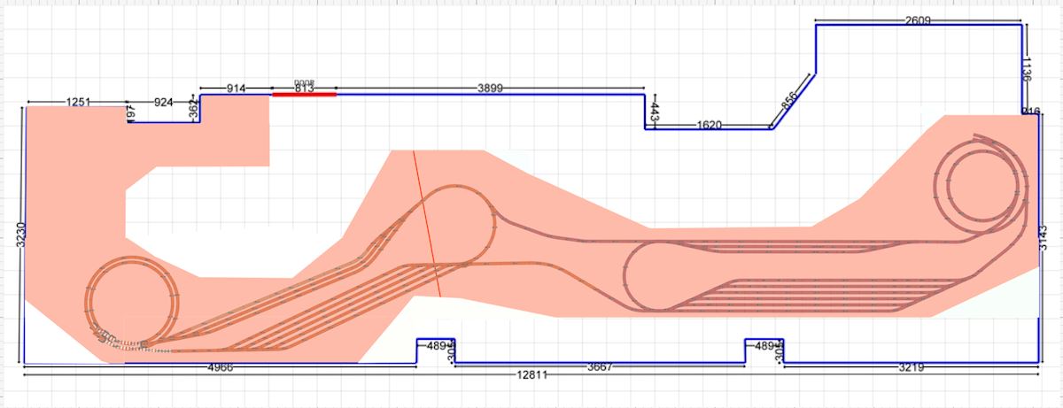

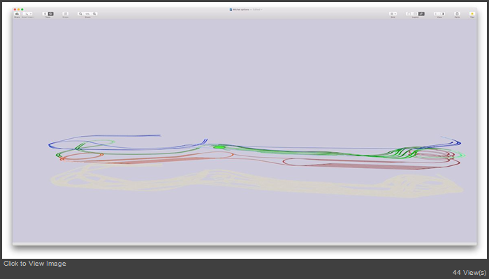

It took some time but here is a suggestion a layout that I hope will fit your room. The idea behind the layout is a long double track main line (green) that where the driver can choose to enter the main station or pass by on the track below (outer). Each side of the main line is connected to a hidden staging area (red) where the trains can either turn or come up at the other side of the staging area. To give more variety. The main line is placed at 100cm (suggestion, can of course be changed) and the station is placed at 110 cm.
There is also a couple of branch lines (blue) connected to the main station. They lead to two smaller stations and an industrial area. There are two connections to the main station, where one is hidden in a long tunnel.
I made the layout very thin at the left hand side so that everything can be reached from outside. In the corner you can also come up and do maintenance. On the right hand side I preferred to make the layout accessible from both front and back.
The red line at the middle of the layout is supposed to be a low wall. Maybe 50-70cm high. On each side of that wall you place landscape backgrounds. That way you can have one station on each side where the main station is at 110cm and the smaller (blue) is located at 120cm.
The layout is mainly made of C-track but the main station and the sweeping curves are made of K-track. Can of course be adjusted.
There seems to be a graphical error on which track that are on top of each other at a few instances, hope it doesn't disturbs too much.
Hidden area:

Simple 3D view:
Well,let me know if you have questions or comments.
//Dennis

Very interesting......Drool
Love the idea as to how it fits the room......Love
Thank you Dennis for taking the time to make this plan for me!
Michel
