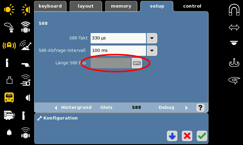

Hi Peter
In the CS2 new update 4.2.8 there is a new field in Setup/S88 that needs filling (how many old style S88 do you have). The result if not filled could explain your issues (I remember issues of stack overflow in the old daysBigGrin .
Here is the screen in question (Sorry, german language) and the new field in red highlight
On one of my CS2 it could have caused improper reading of sensors (just what I suspect).

The problem from 2 years ago mainly went away after I changed the LDT S88 decoders to the Opto style. I just had the one occurrence recently that I could not explain and perhaps your information about the new update screen is what caused that.
What are you supposed to fill in for the Laenge S88 Bus? Is that the actual length of the S88 bus, the number of S88 modules, or the total number of possible S88 connections?
#16 Posted : 04 March 2019 06:21:44(UTC)
Posts: 3,688
Hi Peter
IMO it is the number of S88 (6088) that you have in numerals (1,2,..)

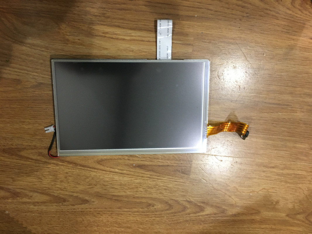

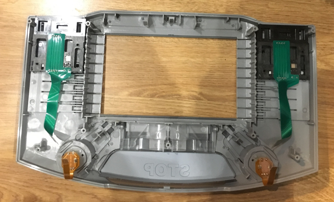

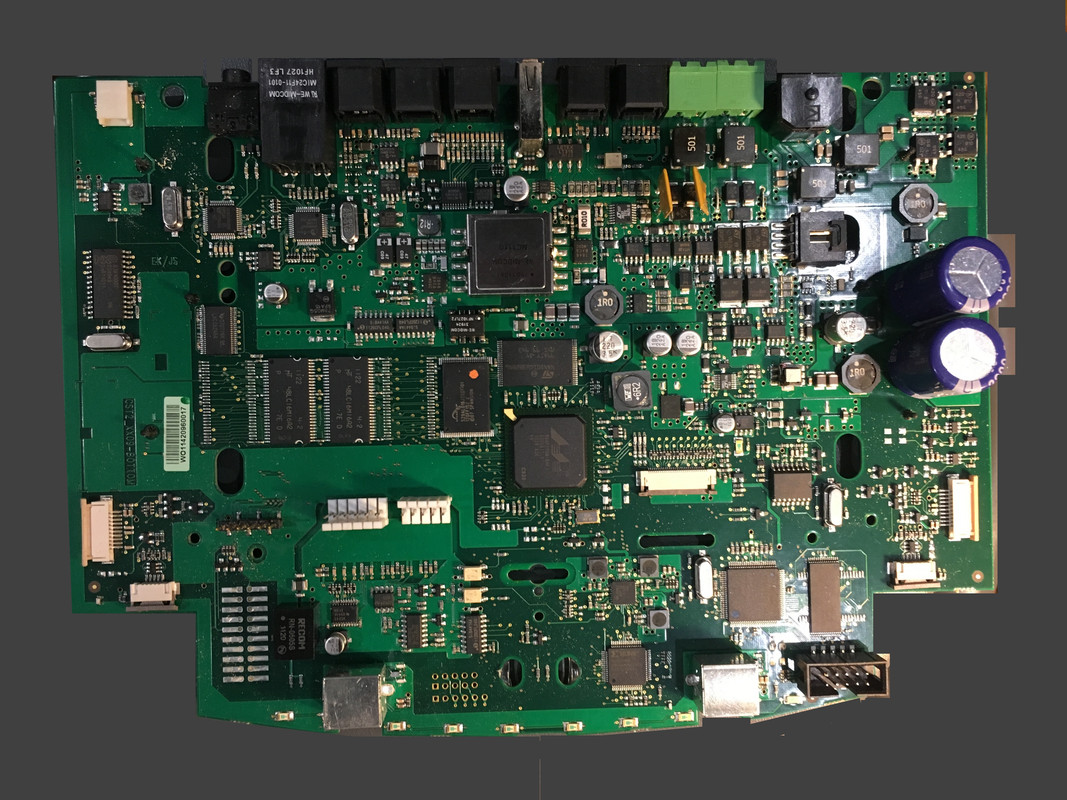

Here are pictures of one of my CS2s giving me troubles with the stop taste (it still works and is repaired)
The mother board
the display and touch screen
the empty upper shell with control knobs and card readers
As you can see there is not much apart the mother board.
I don't know how to cheer you up. Sorry
