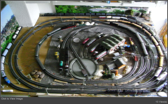

My current muse, although it seems too tall, long and wide (and I run swiss trains haha) Perhaps the upper section was the HOm shelf style-layout:

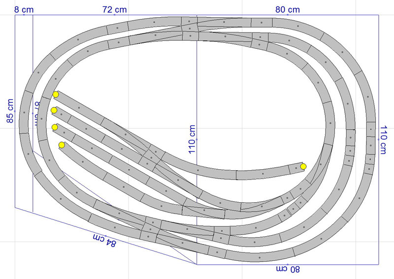

Engine depot? How about this bi-level idea? Two ovals and a BW 3 inches (4 inches if catenary is desired) above ground. Sandwiching baseboard and thin board supporting the BW resulted in "monocque" style. BW connection to ovals via points in front (and switchback tracks in rear). Any of the BW stubs could serve as decoder tuning track.
No need to conceal the turntable. Backdrop = removable cardboard-based "photo wallpaper".

A bit off topic but the background works well in that picture, looks like Faller 180510
