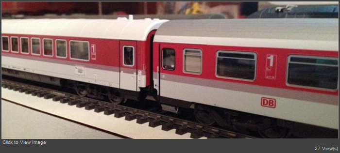

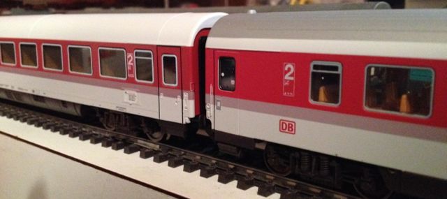

I now am running my Tiziano as follows: Re 6-6 - Apmz - WRmz - Avmz - Bpmz - Bvmz* until my 43310 gets here. As locomotive, I have been using either the 37320 Re6/6 or the 37325 Re 6/6 for the Luzern-Chiasso segment. *The Bvmz is a Fleischmann 5112K Bvmz 185 in the matching livery. It looks quite good combined with the Maerklin cars. The only thing that I am not certain about is that the Bvmz model comes with the airtight gangway connections, which I am not sure is appropriate for the Tiziano consist. The roof of the coach is ivory, which looks very prototypical when mixed with the grey and silver roofs of the Maerklin coaches. The coach has the same scale width as the Maerklin ones and the scale length matches. Unlike, the Maerklin coaches, the Fleischmann one has bogies which pivot on the centre of the bogie. This might cause the coach to hang over more in curves and may be an issue with catenary masts on R1.
I checked my older 1/100 models and can attest to the fact that the IC (4296) and IC85 models of the Apmz both have the window openings opposite the Washrooms sealed. It is interesting to note that the Tiziano Apmz is the same as the TEE version, with those windows still present, but the coach has upgraded bogies compared to the TEE version.
I will post a few photos of the consist, including with the Fleischmann coaches when I have the time.
FL5111 (Apmz 123) - MA43309 (Avmz)
FL5112 (Bvmz 185) - MA43876 (Bpmz)
Edited by user 12 April 2017 05:58:04(UTC)  | Reason: Not specified

I finally got around to posting some photos of the Maerklin Tiziano coaches alongside some Fleischmann models in the same scale.
See my last post.
