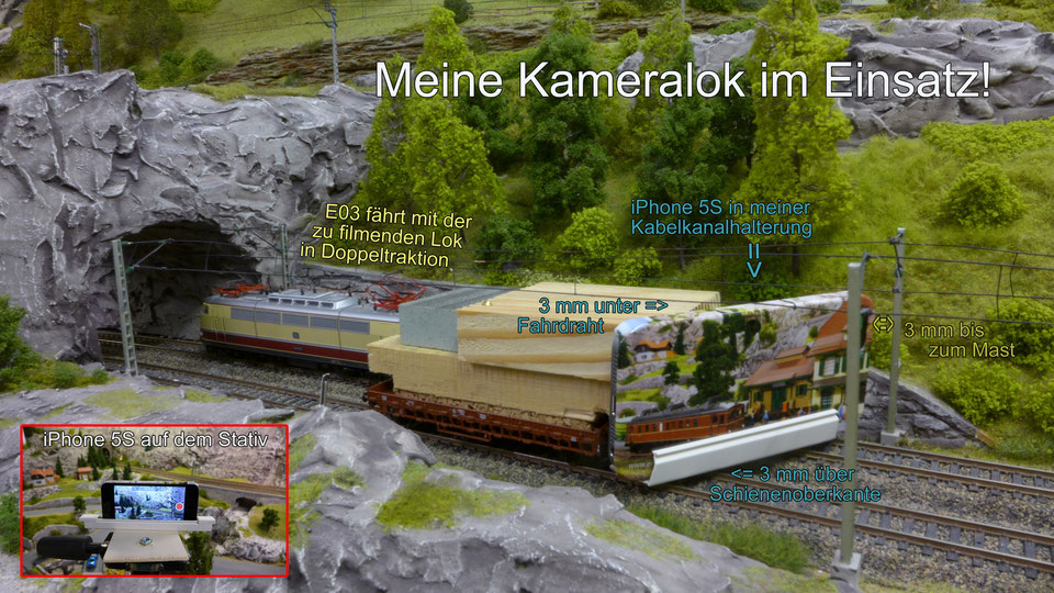

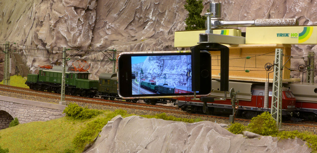

The layout of Gerhard runs with his pantographs set at about 1 mm below contact with the cantenary, to increase reliability, he fixes them:
He has some interesting rigs and double-traction running locos to use his iphone to film his trains with the cantenary: http://www.stummiforum.d...c.php?p=1535733#p1535733

one visitor on my Youtube videos said: your locos don't get the power from the overhead system because the pantograph doesn't arc, well of course in most cases they don't arc, running 16 volts through the wires is not going to give you much of arcing, will it., instead of 1000 volts going through the prototype but there is also a solution for it and this will be another job on my innovation list, installing 0402 led's under the wiper to imitate an arc., haven't decided yet what colour I should use white or blue, unfortunately you don't get white leds anymore with a blue streak in it.
