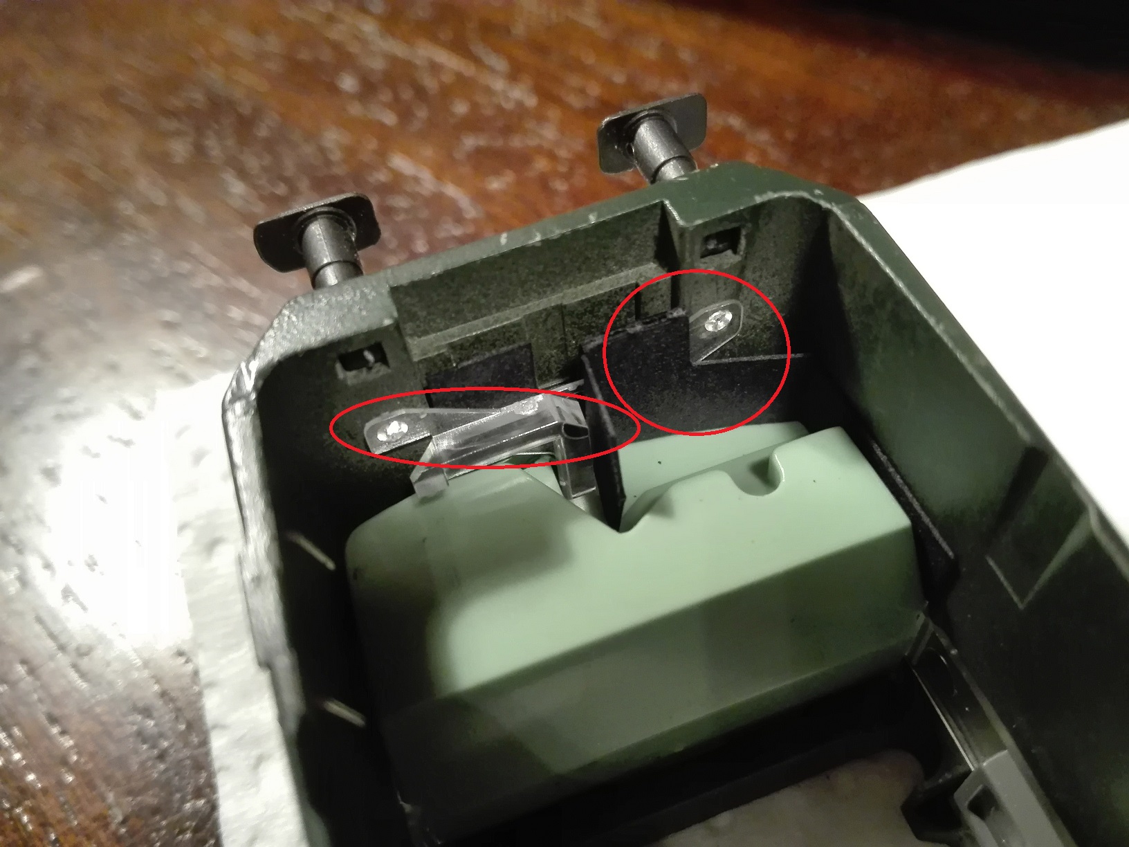

Hello, I am planning to digitalize a Märklin 3338, an SBB 6/6, and in the process, to change the bulb and diffuser it has and put three leds, in order to implement the "swiss lights" and also have a separate control of the main light.
The problem I find is that, once I have the body out, I find some kind of interior cabin body that I don't know how to take it out, even having dismounted also the roof.
And without dismounting the "cabin" I cannot take out the difusser and put the main light led. I tried to forcé it out, but I didn't too much force because I am afraid of breaking ot.
Does anyone know how I could dismount completely the internat body of the cabin?
Thanks and kind regards.
Javier

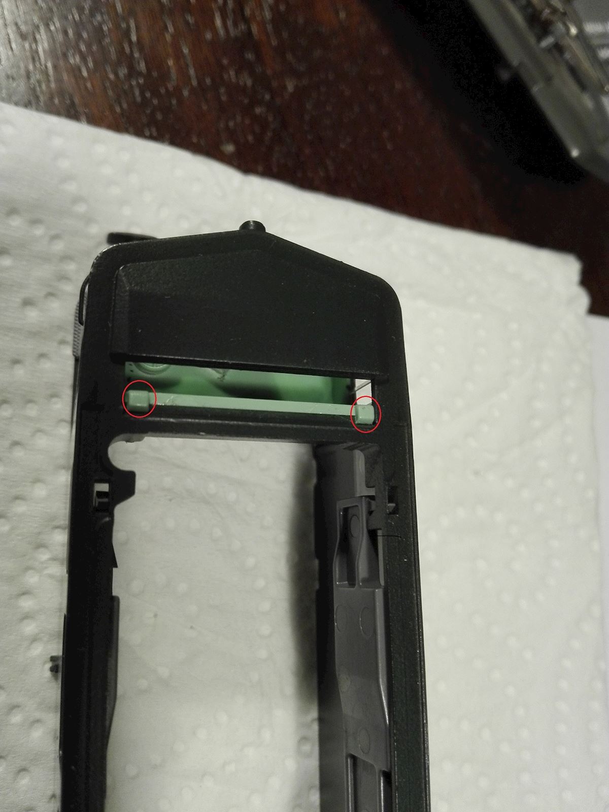

Is very easy to open the cabin in the 3338 and 3336 (are identical).
First you have to take off the screws that keep the roof cover on the body. With the roof away the cabins are open....and you can take of the thin metal with a small screwdriver carefully...
Be careful with the small black cardboard in both side on the light lenses. This does the separation of the lights for the Swiss light system.
When you finish you must put it back exactly where it was.

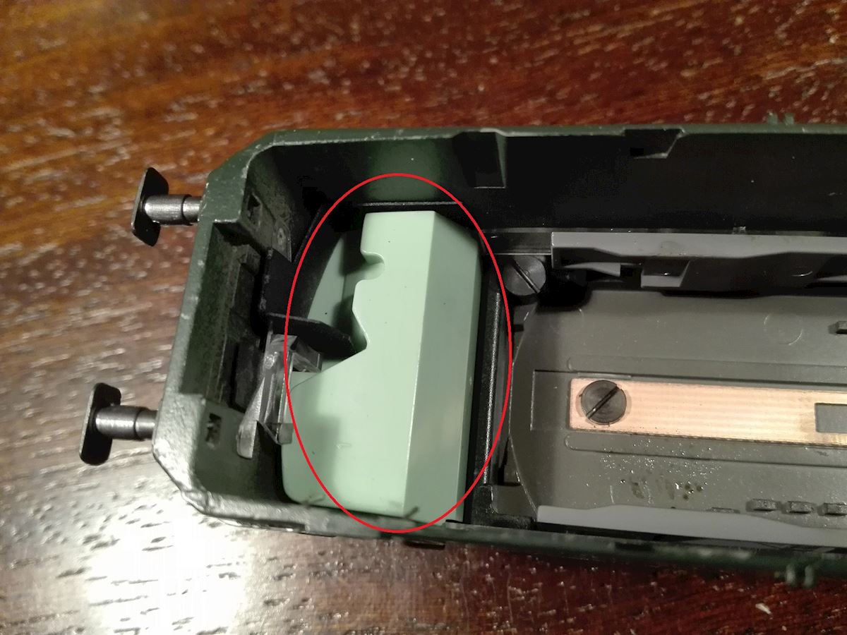

Let me explain my doubts. As Costas said, there is a small black paper separating both buls in order to do the "white swiss lights". If I digitalize maintaining the bulbs, I will have the "swiss lights" (black white) solved.
But I do want to do a couple of additional things, that need to change the two bulbs for three leds. First, be able to also put the red black swiss light, for what I already have a small diodes circuit. Second, to have a separate control of the main light, in order to light on it only when the lok start driving (I use for it the programmation facility of the ESU lokpilot V4). Some of the ideas came to me looking to some of the links yyou propossed, Mike, specially the hgt one. The others I didn' knew, I will look to them carefully for some other ideas, thanks for it, Mike.
For doing it, I need to take out the internal cabin:
As Costas said, opening the roof, one can find a couple of points that seems to be the ones to be moved to have the cabin falling down:
Of course the black paper has to be taken out and it is very easy to do it. But then my question is how could I take out the cabin wthout breaking the diffuser that seems to go thru the three light holes, the two lower ones seems to be not difficult, but I don't see any access to the upper, main, one
Thanks for your help.

#5 Posted : 08 February 2017 14:11:07(UTC)
HI!
After removing the black piece of card, (remember how it was arranged..take a pic Wink ) you have to **carefully** pull the plastic transparent headlights inserts from the body.
However you must first **tilt** the cabin insert backwards
I will post a couple of pics in a few minutes
Push the one insert on the top center from the outside, all the while pulling from the inside with an X-acto thin blade . Be patient and make sure they all come out more or less evenly...don't break them!
Good luck and show us the results when you're done!!Smile

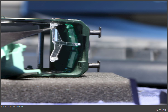

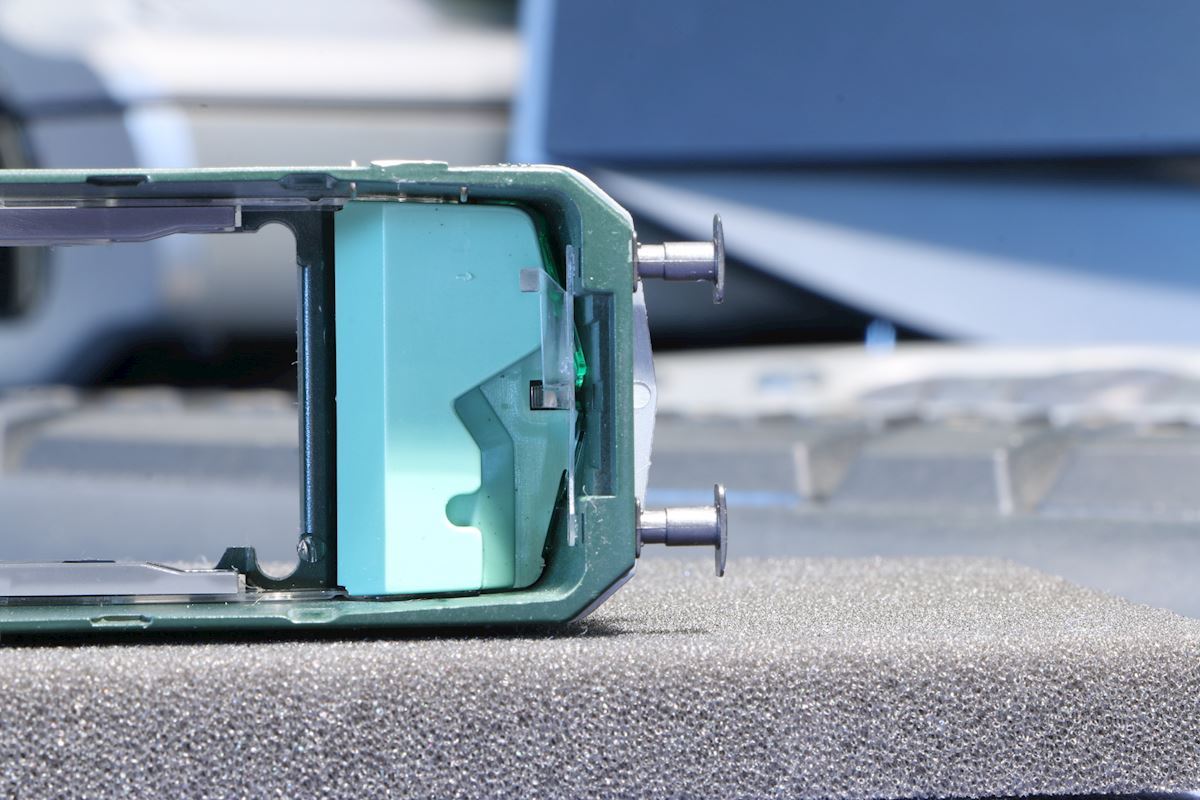

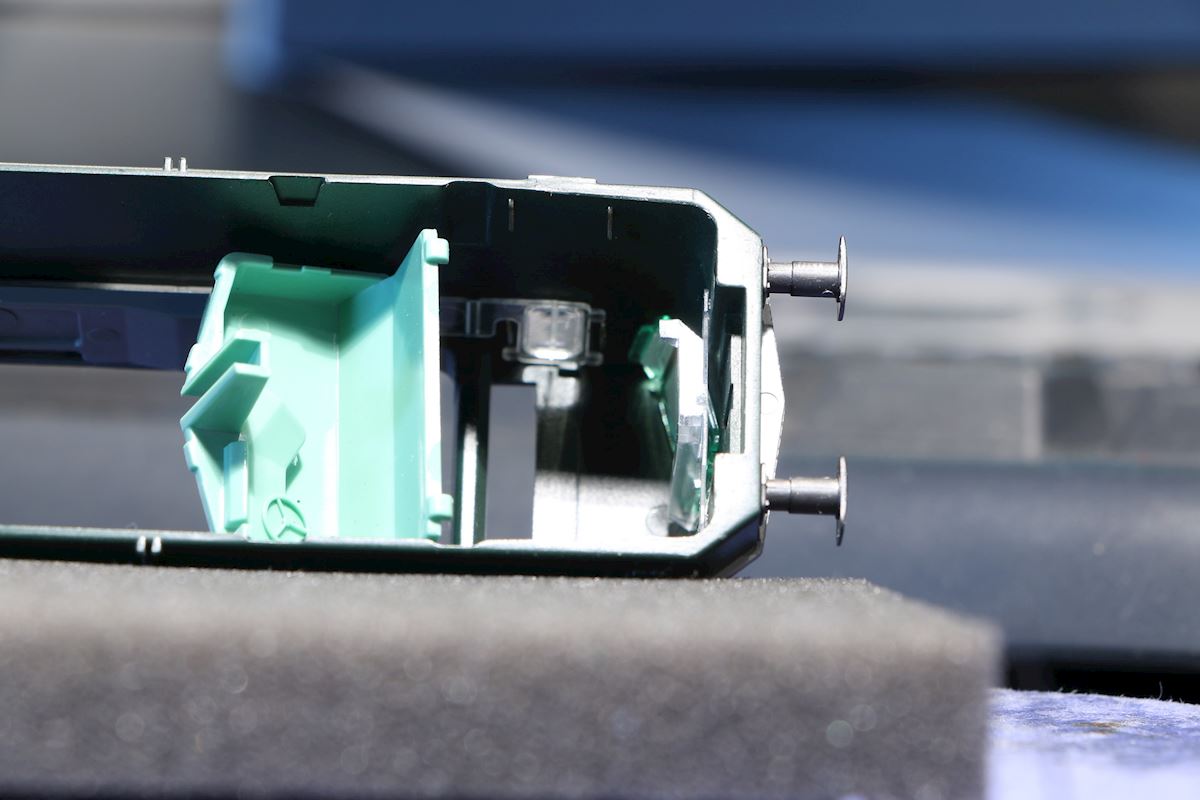

#7 Posted : 08 February 2017 14:33:35(UTC)
Here are two pics.
Hopê this helps
Jacques

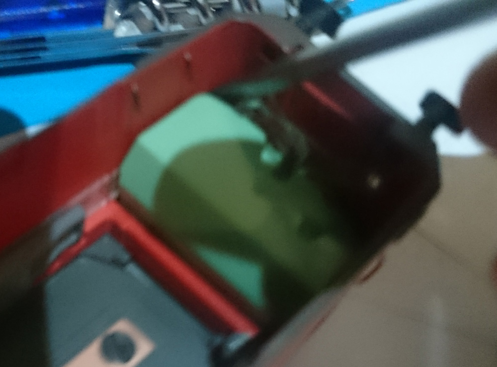

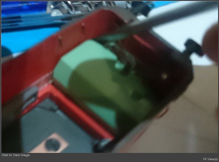

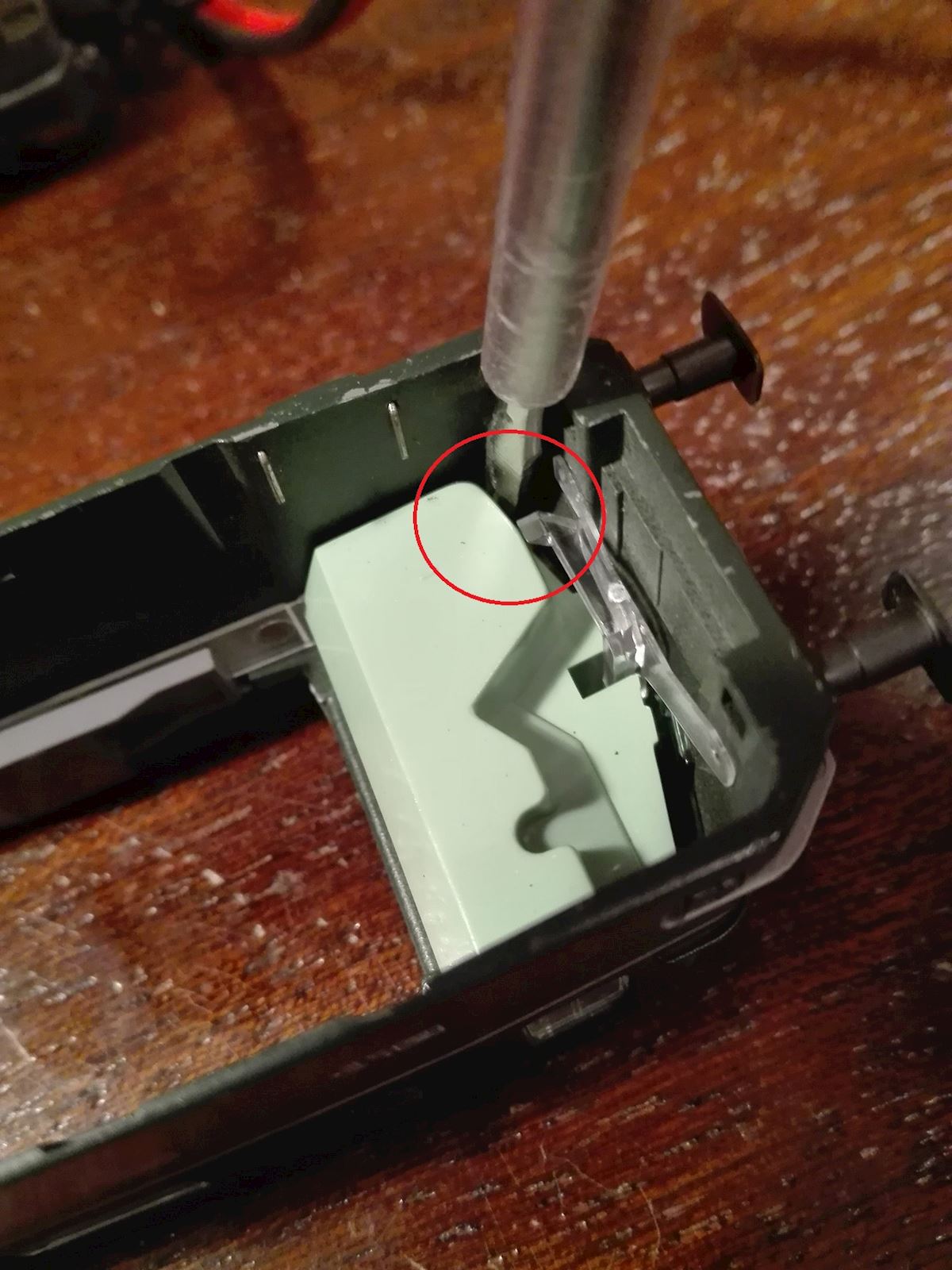

Offline ktsolias
#10 Posted : 08 February 2017 15:47:24(UTC)
ktsolias
Joined: 01/05/2016(UTC)
Posts: 623
Location: Athens
Its actually very simple:
Look the photos:
Put the screwdriver there and push gently
Done !!!!
With a fine tweezers take off the lens.

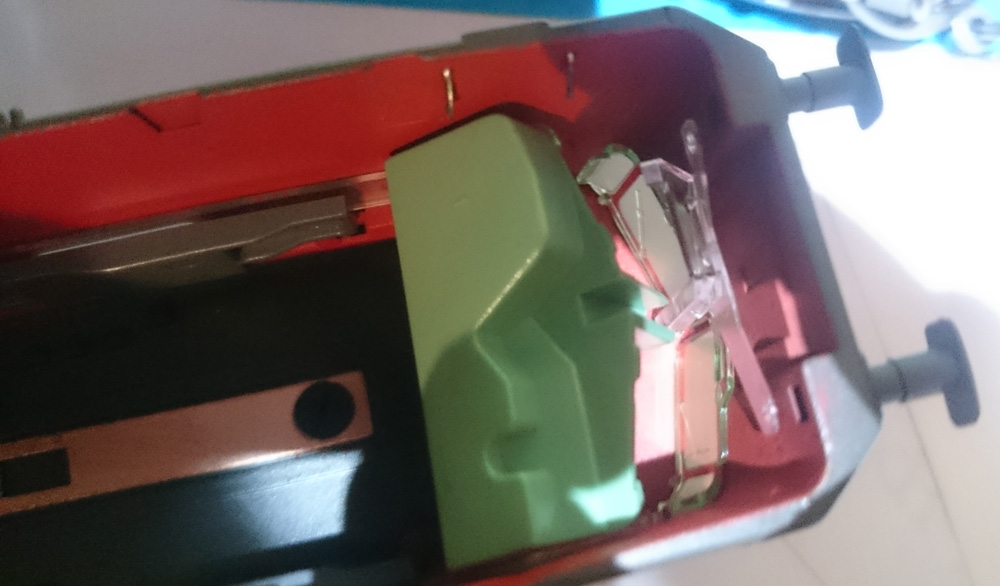

#12 Posted : 08 February 2017 17:39:35(UTC)
fje
Joined: 14/02/2011(UTC)
Posts: 125
Location: Madrid
I DID IT LOL !!!!
This pic is mine and my lok... BigGrin
Thanks again, Σας ευχαριστώ πολύ και πάλι, Κώστας, merci, Jacques (your pic was a bit unfocused and, thus I didn't understand what exactly to do, but now I can see you were the first giving the cue Blink ), and also thanks, Mike.
Now the big work of digitalize is to be started. Probably I will not do it before next week as a friend of mine wants to be present in order to look how I do it... I am not the best teacher, I should say, (my hand work is not "fine" enough), but, at least he will see the procedures to follow, and... I don't feel we will be able to have joint time this week.
