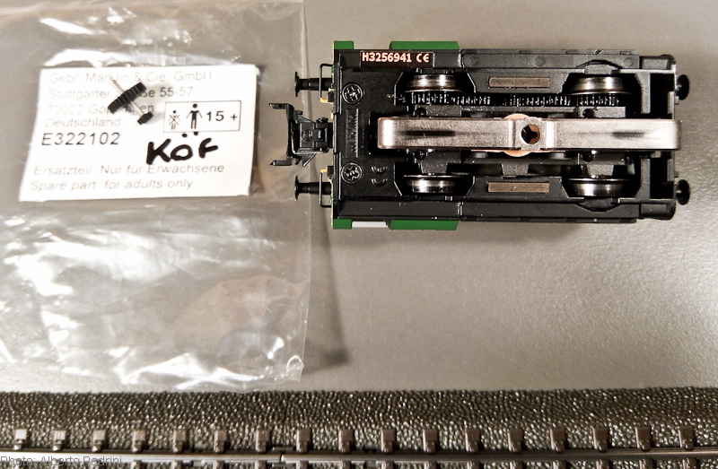

Location: Italy
I don't want create alarm about the Märklin loco, I've many models without problem, from 1956 to 2016.
Only the green Köf and the seetal have zinkpest, but it's the first time that I see gear broken, plastic retires and breaks in a new boxed loco.

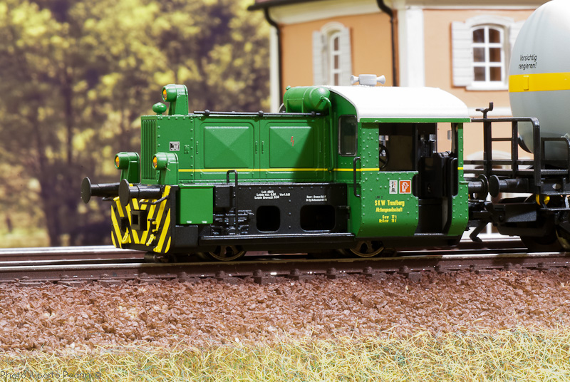

Alberto,
Sorry to hear about your Seetal croc.
As for the affected Kof, IIRC it was the Trostberg Kof model 36805, which looks like this;
Maybe it would be useful for the Forum to have a sticky with all Zinc Pest affected models, for newbies to read and be aware of so they can be careful when buying these models?

AFAIK there are two KÖF II models with zinc pest (36805 from around 2001 and 36808 from around 2005) besides the Seetal crocodile and a few freight cars (DB and US).
The owners of the company changed, but the company stayed the same AFAIK (but IANAL).
The Kingsbridge take-over was announced in 2006, so the KÖFs were made before Kingsbridge took control.
Many KÖF II suffer from broken plastic cog-wheels - at least you can still get them as spare parts.

Not all the production has the same defect, my köf 36805 (year 2001) doesn't have zinkpest, but the gearplasticpest on the main axle, (and also my FS köf 36806 year 2004)
This is a little defect, if you are able to open the loco in five minutes is repaired.
So, no panic, but check your model.

That may well be the case. You can find plastic cog-wheels in old models like 3029 or 3003 from around the ’60s or ’70s.
With the Köf II you have small plastic cog-wheels on metal axles and the plastic is rather thin. Design and material probably do not match and more material (larger cog-wheel) or a stronger material would be needed.
The TRAXX models have plastic axles and plastic cog-wheels. I haven't heard of problems with those.
No need to be alarmed about plastic cog-wheels in general - the Köf II is one known exception.

I had a similar issue on my 36822 Kof 2 years ago.
This is what I did when the Kof plastic gear replacements were out of stock:
https://www.marklin-users.net/forum/yaf_postsm453808_Kof-running-characteristics.aspx
I guess it should be possible to replace the gears of the seetal croc by metal as well.
BTW my Kof with metal gear is still running around happily :)
Bert

I looked at my 37521 tonight, no gears broken, but it doesn't seems to run right. I pulled it apart and I'm sure its a gearing problem somewhere... I'm seeing if replacements are available. then maybe I'll give it a shot.
Alberto and friends- have any of you been able to obtain new gearsets?
You mean a click/block every turn of the wheels?
This was the cherry on top of the problem, due to the linkage of the wheels.
I was thinking to send in Märklin all the pieces and forget the loco.
Too much problems.
Alberto
Too much problems.
That is EXACTLY what is does- so its not even a broken gear but some other problem!?
Also- is the 37522 immune or do they have the same problems? Thanks all!
