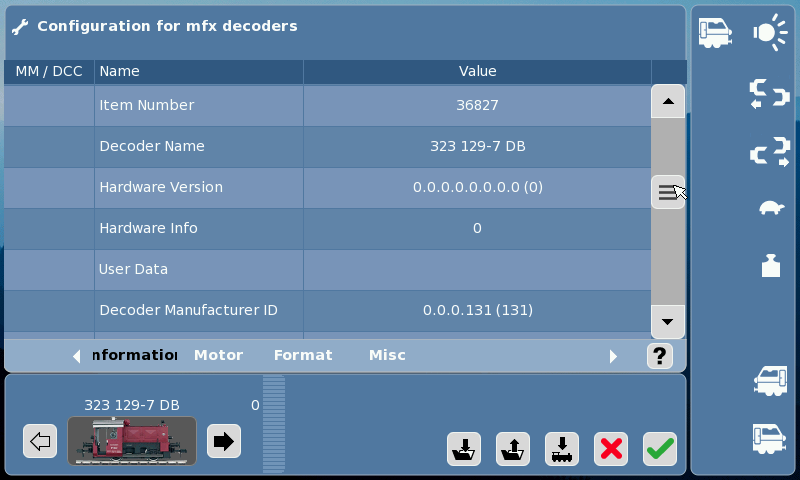

Just a note: with a CS2 you can check the ref. number of the set the decoder came with. If the decoder shows ref. number 39235 then it's the soundless decoder and someone swapped covers.
Check "Item number" on the "nformatio" tab.
