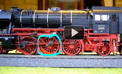

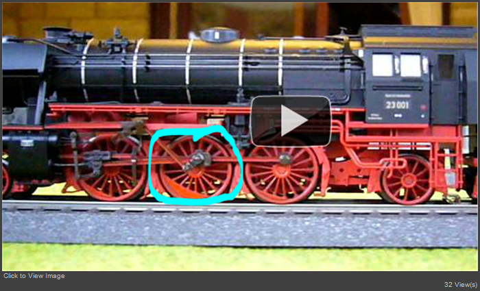

Not sure if this will help, but here we have Alan's BR23 travelling at one click on the CS2.
I've got to be honest and say I can't see the Loco having the problem in this video, but maybe a trained eye will spot something.
Hope it helps.

Ian.
Yes!!!
I can see the last driver is slightly ahead of the rest!
It's very clear at about time click O:09 to 0:13!
Can you make the same video from the other side?
I think we have found it, but I need to see the other side too, then I can probably tell you which side to apply a correction....

The fault on the Loco looks worse on that side, you can see the Loco lifting off the track.
Great job on the video. ...the first of many.Smile
Ian.
Offline Ian555
#40 Posted : 03 January 2012 17:03:29(UTC)
Ian555
Joined: 04/06/2009(UTC)
Posts: 20,302
Hi Alan,
If you compare the 2 video's, look at the driving rod between the front and middle wheel.
On your side of the Loco, the small rod is pointing "up the way".
I had that same problem on a Loco a couple of months ago, it just "clicked" into position and has been alright since.
Ian.

#42 Posted : 03 January 2012 20:55:54(UTC)
Posts: 11,165
Alan, I had exactly the same problem with my BR45...
I had handled the loco a bit uncarefully - It toppled over and fell from about 20cm height and it landed on the side...
I was going nuts looking for the problem since everything looked ok.
Then I finally noticed while looking at it very carefully from underneath that one of the outer rods in the valve gear
was slightly bent at the angle where it is secured to the wheel and caught the rod inside it...
Instead of being almost a 90 degree angle, it was more like 75 degree, barely noticeable unless you looked really hard...
Careful bending with sharp nosed pliers fixed it, and I could relax again... Tolerances are much tighter nowadays...
But I must say, it looks like the upwards angled rod is pushing "too much", is it catching the inner rod?

#45 Posted : 06 January 2012 00:49:04(UTC)
Robert Davies
Joined: 20/11/2010(UTC)
Posts: 426
Location: Worcestershire, UK
Alan
Nice videoing!
If I can refer to Juhan's photo without reposting it, I think that the problem is at the opposite end of the rod to which he has referred. The rod joins a crank on the big end to what is called the expansion link, which on the real thing is able to move up and down, thereby controlling the valve gear and selecting direction. Comparing the two sides of the locomotive in the different videos, the expansion link is upside down on the left-hand side (the side in your video) with the result that the rod seems to be striking the running plate and lifting that side of the loco.
It looks to me that you need to turn the expansion link over (i.e. top to bottom) and you may need to take the drive rod off at the big end to do this.
This link http://en.wikipedia.org/wiki/Walschaerts_valve_gear shows the parts in more detail and you can see how things should be.
Edited to correct terminology and add link
Robert
