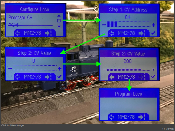

#26 Posted : 02 February 2014 18:30:54(UTC)
Posts: 15,581
And how do you that,if there is line over CV protocol???
Select any DCC locomotive entry and the CV menu item will be available.

    I used this menu:
    But The break sound (this horrible thing everybody is talking about on several topics) has disappeared.
    I tried to find how to reach some CVs :
    But I didn't found anything about the CV64 !
    So the question is: How to reach CV64 (and others if necessary) to adjust break sound threshold with my MS2 ?
    Please help !

    Offline TrainIride
    #38 Posted : 28 January 2022 15:01:03(UTC)
    TrainIride
    Joined: 23/10/2010(UTC)
    Posts: 2,084
    Location: FRANCE
    Thank you for your help ThumpUp
    So what I have done:
    Well my Brake Sound is back !
    But one limitation I have :
    I can this way modify the CV values.
    I cannot this way read the CV values.
    The value shown for each CV at "Step 2" is the last modified for the last one, but not the value in the decoder.
    Best Regards
    Joël
    #39 Posted : 28 January 2022 16:18:10(UTC)
    Posts: 15,581
    CVs can be read for DCC locos, but not MM locos.
    If the catalogue or loco manual shows DCC for the loco, better try DCC. With MM it is write only - and in some cases more "trial and error".
