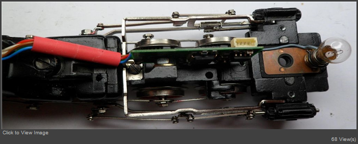

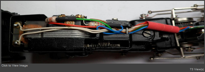

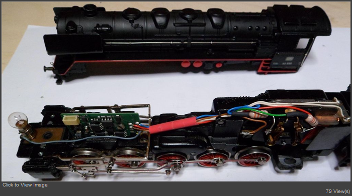

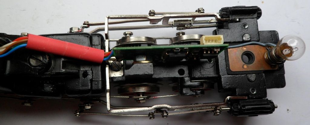

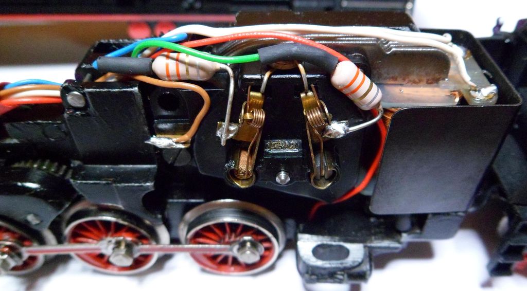

finally found a few minutes to open the 3047 and make some photos.
Surprisingly I added new chokes in this time and removed the original one. I don't remember why, probably it was a test whether or not this makes a difference.
The decoder is mounted using the original screw of the reversing relay, a flat washer and a small nut as additional washer.
The loco had two pick-up shoes which I thought is not ideal in digital operation where this could short-circuit booster sections. I removed the front one and it turned out that one pick-up shoe is sufficient.
Besra

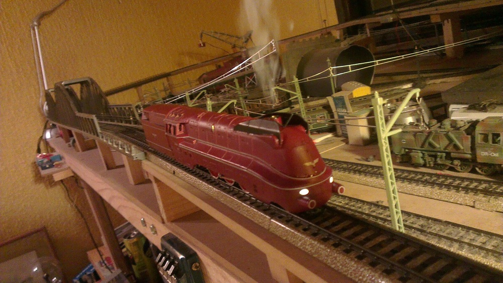

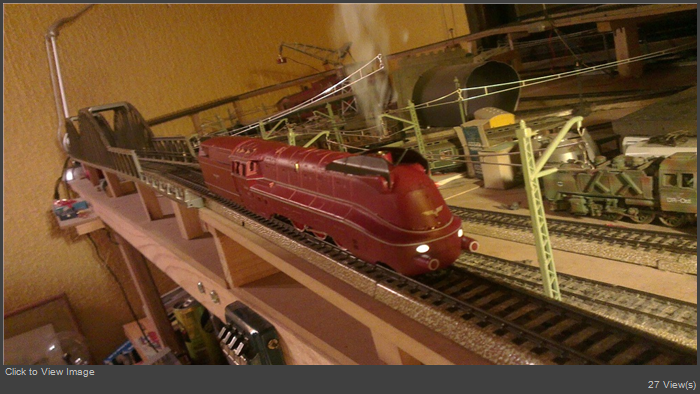

The conversion of the BR03 was a little more challlenging, even if the housing has the hole for a smoke generator, at least in my model there is no contact for it, also the bulb is placed too far of the light difuser for my taste, so i have managed to mount a bulb holder more ahead, fit a 2 pin socket on it and put a warm white LED, the result is very nice IMHO, because it brings some kind of futuristic looks to the loco.

Cool vids Francisco, thanks for sharing!
The one with the 03 impressively shows a well working load regulation of the 76200. I always wonder why some folks claim it has a bad (or almost no) load regulation. You proved them wrong!
The 3089 has no contact for a smoke unit, that's true. But it should be easy to solder a wire to the unit. Seuthe also offers wired smoke units (e.g. No. 100), if needed.

Hi Francisco,
I'm very happy to hear these good results!
3098 - BR38 - working just fine, SFCM engine
My 3089 had to run through lot of conversions until I was (and still am) satisfied: The first one was from analogue to a very early and very cheap Tams decoder (LD W-1 or something). Not so good. Running characteristics were comparable to Marklin c80 decoders of that time, the Tams additionally did offer programmable acceleration / deceleration rates but worst thing was the loco sometimes crawled away slowly when it was supposed to stand still. Next conversion was from Tams to Uhlenbrock 75200, first decoder with load regulation available for Marklin motors. The load regulation, even though far away from being perfect, was an improvement but the running characteristics did not satisfy me plus it was hard work to program CV's. So, next try: Uhlenbrock 76200. Much better, but still load regulation was less good than known from other conversions. I spent hours trying to find best CV settings but in the end I decided to convert it again. This time by removing the field coil, replacing it with an ESU magnet and adding a ZIMO MX630. Perfect, or better to say as good as can be expected considering the 3-pole armature in use.
Anyway, from your video it looks like one conversion is sufficient in your case ;)
When asking about SUSI modules I guess you are referring to sound modules? Sorry, I have no experience with them. The only modules I ever connected to SUSI ports were LISSY transmitters.
Besra
Offline franciscohg
#19 Posted : 04 July 2013 17:18:21(UTC)
franciscohg
Chile
Joined: 10/07/2002(UTC)
Posts: 3,300
Location: Patagonia
Hi Besra, it Works fine at the first attempt, but only thanks to your work on fine tunning the CV'sThumpUp
I have only one experience keeping the 3 pole motor and a permanent magnet. but i was really not happy with the result.
Of course the full conversión using 5 pole motors gave amazing results, but it is more expensive and it is hard to have in stock those motors for every old model one could buy...in the long term i think they are the way to go....
Remember that everything i want or need, i have to wait more than a month from buying to receiving it, so, those 76200 will be a very nice choice to hame some in stock and make run all the oldies that i might buy at once!!

Well, a couple of sound modules have arrived, along with the USB ladeadapter, wich i must say is cheap and easy to use, even if almost all the documentation is in German, not like the upgrade of mSD wich i cannot yet make sucessfully........
It works very well, here a sample with my old BR 44, now i will work with my BR 23

And the BR 23 - 3005
