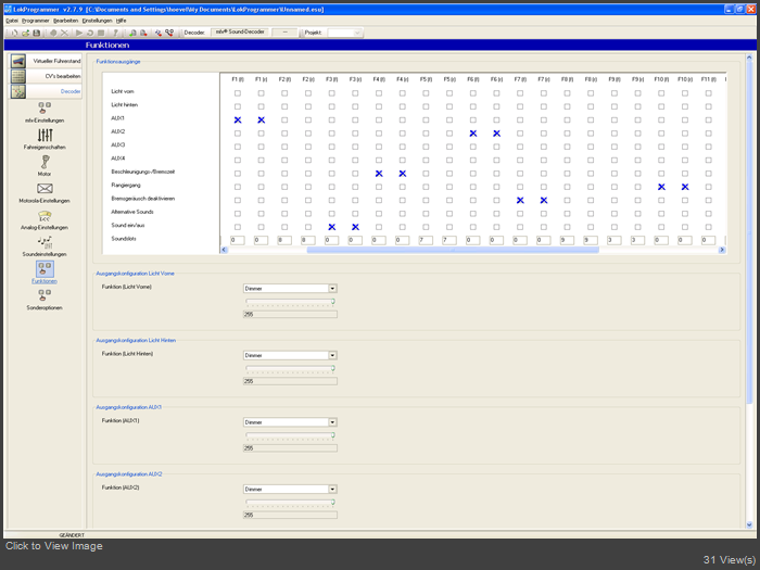

Which LokProgrammer software did you try? Software version 2.7.9 should support your decoder (the new 4.x.x software does not).

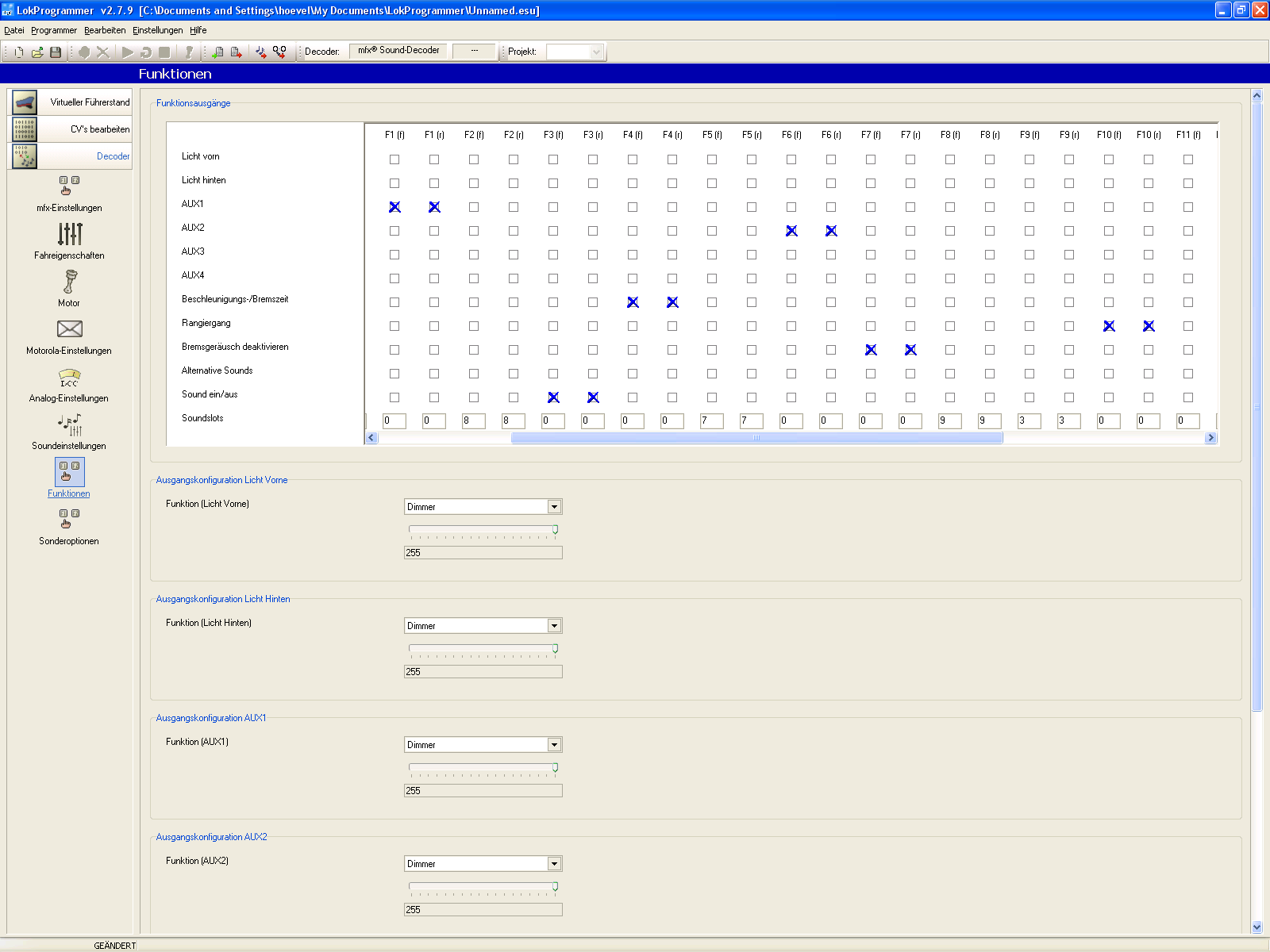

I don't have a 60933, but tried my 10 002.
It worked.

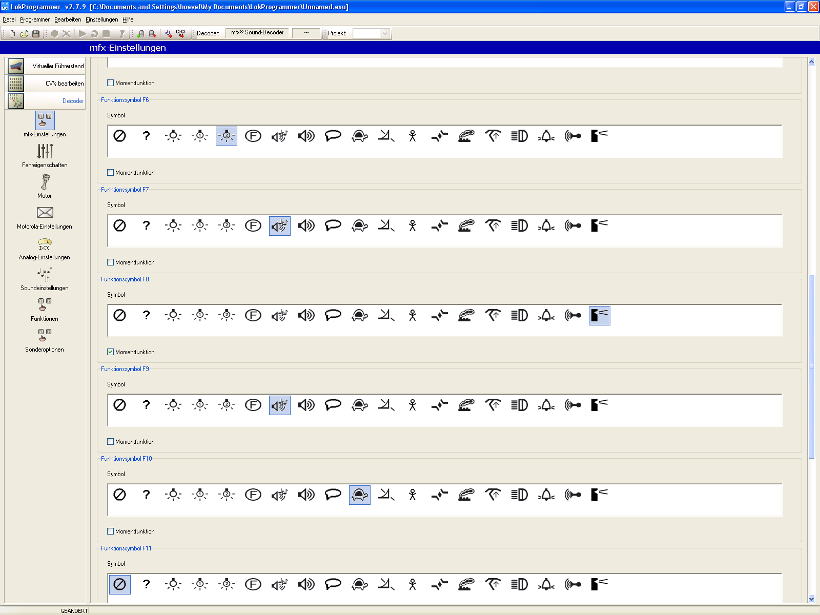

Under "Funktionen" I added checkmarks to switch shunting mode (Rangiergang) with F10.
Then I went to "mfx-Einstellungen" to select the appriate symbol for F10. Then wrote the changes to the decoder, tested it with the CS1 - heureka.
