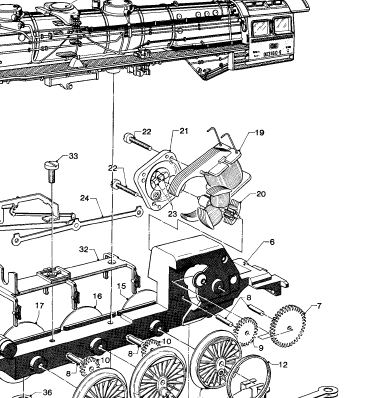

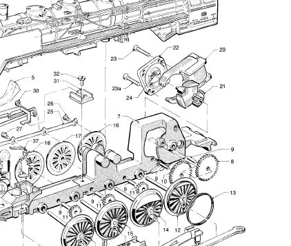

I am assuming that the 3082 and 3085 locomotives are flat style commutator motors (and not the more recent drum style DCM).
If so, then the 60760 permanent magnet may not fit into the locomotive frame.
The holes from the locomotive body will not line up with the holes in the magnet, and you may not be able to attach the magnet.
I have found this to be the case with some of my older locomotives.
Therefore you have to keep the original motor parts (or at least the magnet).
The original motor parts and magnet worked on an AC motor, but the 60760 kit pushes out DC current to the motor.
Hence you need to have diodes so that the forward- and reverse- directions are working properly.

Serge,
We can probably assist you with your conversion, but it would be very useful if you could possibly open up the chassis and take a close-up picture of the 3-pole armature.
Then we can assess whether you have a flat style commutator or a drum style commutator.
It is important to know this before you go too far in your conversion.
Alternately, can you possibly date the locomotives from your catalogues ?
This could also assist us in this deliberation.
Regards,BigGrin

This may help:
3082 (BR41) made from 1974-1992
3085 (BR03) made from 1973-2003 (30 years!)
Both use the drum style 3 pole motor.

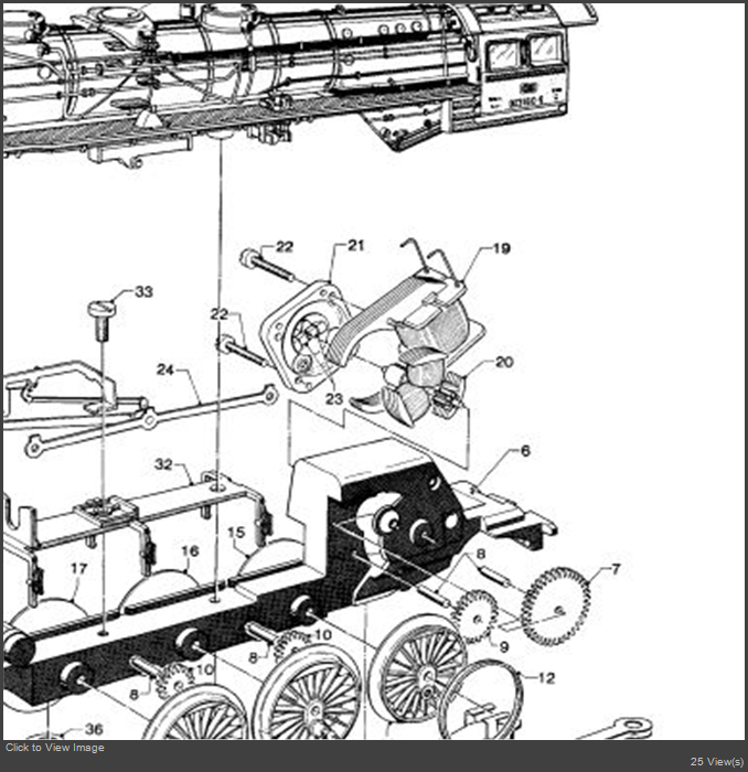

Ray - You are quite correct !
From the detailed parts pictures shown, these are newer drum style motors, so the 60760 kit will work nicely !
For your interest, I can post a separate thread on converting flat style commutator motors where the new magnet does not fit the older loco body, and I have used the diode trick.
Regards, BigGrin
