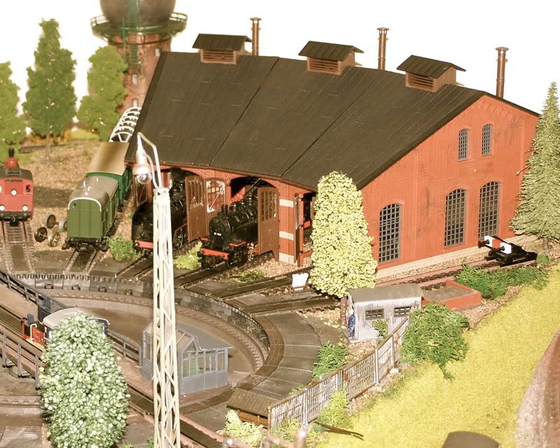

I like the Faller 120218 kit. Its called "Ringlokschuppen Freilassing". Out of the box, it comes with five doors instead of the "normal" three. You can, however, choose to build the roundhouse with any number of doors. The one I have at home only has three doors because of lack of space.
The real beauty is that the space between tracks in the roundhouse is 7,5°, which matches the Märklin turntable. In other words: You can use every track on the turntable. If you buy a Märklin roundhouse, you can only use one out of two tracks (as I recall - feel free to correct me on that point).
Best regards, Voller.
http://modeltog.voller.dk

[size=1" face="Verdana" id="quote]quote:Originally posted by Voller
<br />I like the Faller 120218 kit. Its called "Ringlokschuppen Freilassing". Out of the box, it comes with five doors instead of the "normal" three.
The real beauty is that the space between tracks in the roundhouse is 7,5�, which matches the M�rklin turntable. In other words: You can use every track on the turntable. If you buy a M�rklin roundhouse, you can only use one out of two tracks (as I recall - feel free to correct me on that point).
You are completely right! I had really almost forgotten this one. It has 7,5° track space angle which allows already 24(!) stands with just a half circle (180°), which is simply great by all respects!!! [:p]
Lucky ones who have the space for that!!! Smile

#13 Posted : 05 July 2007 14:11:08(UTC)
Posts: 6,783
Thanks Voller, for the great photos and explanation.
Is there a particular reason you have K track? in the roundhouse, but C track on the side?

Voller that roundhouse looks great whats the length of that one? my marklin one is a bit big for my layout and I would love to build a new one.
worse things happen at sea
Offline Voller
#15 Posted : 05 July 2007 16:45:35(UTC)
Voller
Joined: 27/12/2006(UTC)
Posts: 78
Location: Helsingør, Denmark
Thanks guys.
The length of the house itself is about 34 cm, which is about the same as the Märklin roundhouse. C-track won't fit in the roundhouse because of a small piece of plastic holding the tracks in place.
I suppose it wouldn't take a rocketscientist to remove that piece of plastic and make room for the C-track...

Just finished the Kibri roundhouse 59452,for me its a better fit then the marklin one which hung about 2 inches over,easiest model I have ever built
#27 Posted : 19 January 2008 16:55:53(UTC)
Posts: 7,500
Looks very good. Kibri is ther easiest to build with Faller the most difficult. I have found that the automatic door opening and closing does not always work too well. I think Vollmer and Marklin are the same kits.
The surrounding area certainly finishes off the project very well and of course Dale is the expert on the interior.
