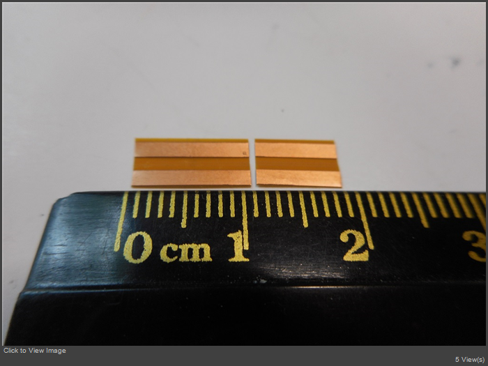

Hence the following. Use a small surface mount bridge rectifier, add the capacitor and heat shrink. To make it easier to work on I decided to use some paired flexible copper strip I have had for a while. It solders easily and is quite strong. It is not possible to cut the copper strip without damaging it so I used the following idea. Some photos :
This was one piece which I cut with scissors.

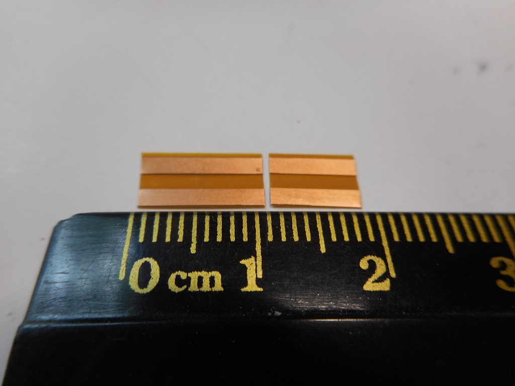

A small edge was turned back on itself and squashed flat. This piece is then lightly glued to the end of the other piece. The turned up edge prevents any possible short circuit.

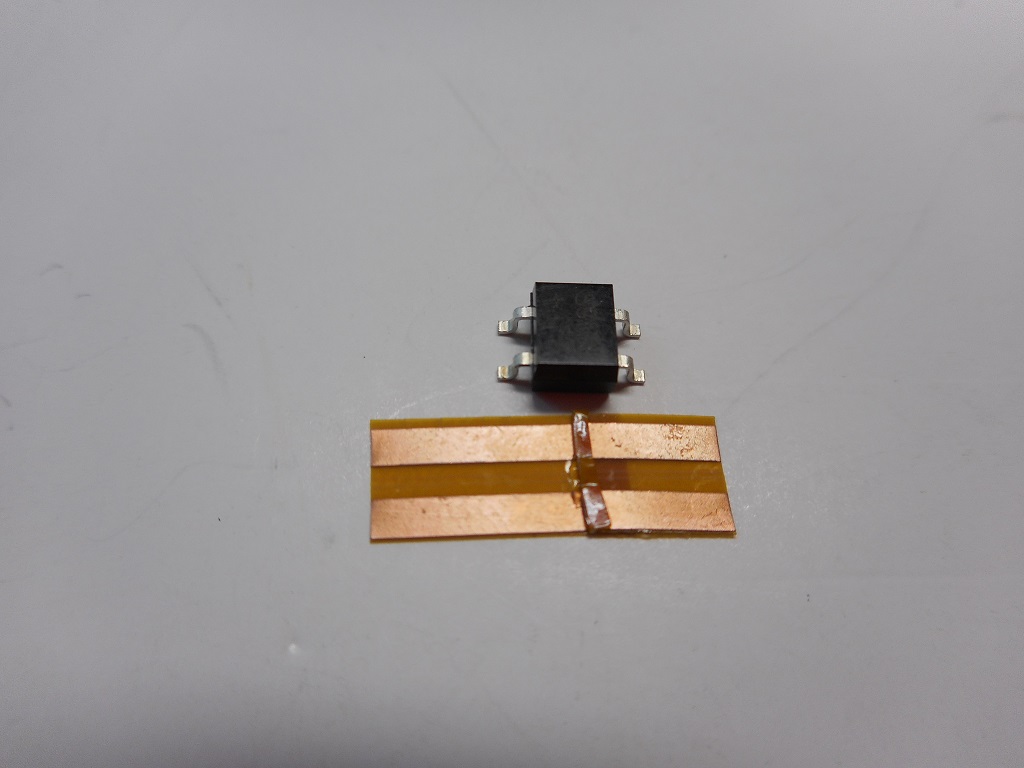

This shows where the bridge will sit when soldered across the join.

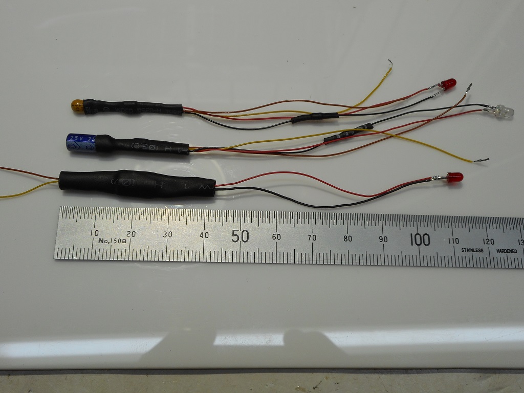

Soldered and wires attached, compared to an earlier version.

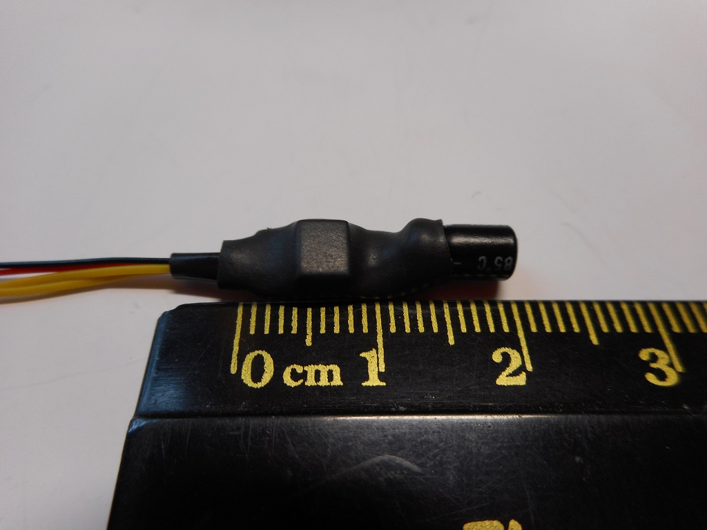

Final product. 20mm x 6mm at widest point.
Previous versions with diodes. Smallest about 32mm.
