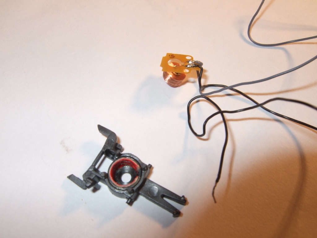

SUCCESS! With the Stummiforum information which Francois kindly directed me to, I managed to open up one of my faulty 117993 Telex couplers (ones that lets go of towed carriages) and line the inside of the solenoid cylinder with insulating tape so the solenoid fits snugly and after re-assembly, it works faultlessly! So this method of repair works for both 117993s where the decoupling pin sticks & does not drop and also where it lets go of towed carriages, as in my case. And as I have a total of 7 units of faulty 117993s, to learn of this fix is really good news. Thanks again Francois.
By the way, I took a photo of the coil and gasket assembly and this is attached. As pointed out by Patrick on the Stummiforum thread, you really have to take care when you remove the coil to avoid breaking the wires. In my case, after carefully prising off the bottom cover with a cutter blade, I used a toothpick to push through the hole at the other side (i.e. the top of the the coupler) and this ease the coil assembly out together with the gasket and connecting wires. The photo is taken after the two are separated.
And to clarify ref the unwanted decoupling affecting my 117993s, I would first confirm that this happens even when coupled with Marklin close couplers. I know and accept that the older Relex couplers do not work with 117993s (it lets go the first time the train goes over a crossing or any uneveness in the track).
By the way, you are absolutely right that the reason why the pin moves up in my faulty units is due to the excess space & clearance in the cylinder such that the coil and pin can move around. What happens is that the variable backward & sideways pull on the 117993's coupling bar as carriages are towed causes the coil and pin to shift around inside the cylinder & it eventually works the pin upward until the coupling bar lets go. And as I do not connect the uncoupling wires to the decoder when I am testing the 117993, there is no possibility that the uncoupling is due to the coil being activated by an unwanted signal or other voltage.
Anyway, thanks again Francois for informing me of this repair. You've put my project to equip my locos. with 117993s "back on track", if you will excuse the pun!
Bennett.

Offline M Gleis User
#16 Posted : 14 February 2013 22:25:03(UTC)
M Gleis User
Joined: 19/01/2012(UTC)
Posts: 17
Location: France
HI Bennett
This is great news ! I'm glad for you
Enjoy the Telex
Francois
Hey, did this repair process ever get written up and documented in english for the benefit of others? A PDF or attached images vs offsite linked images would be best (as Ive found lots of 5-6 year old threads of interest where the posted images hosted on image hosting no longer exist ).
I"m diagnosing telex couplers not engaging or not hanging on on a new Lok I just purchased and it may well be this same issue. I'm not sure a warranty claim with Marklin will resolve the problem if the yield rate of these new telex couplers is so low.
I've just created a PDF and attached it here for others, as a reference. Let me know if the content isn't correct.
Telex coupler repair procedure post.pdf (671kb) downloaded 124 time(s).

Roco's Universal coupler is compatible with Märklin's close coupler, but couples more easily. In my experience coupling works better also when coupling Roco with Märklin.
They do not couple in curves though (neither do Märklin's).
Coupling a Roco Universal coupler with a Märklin Relex coupler will work for some cars, but fail for others.
