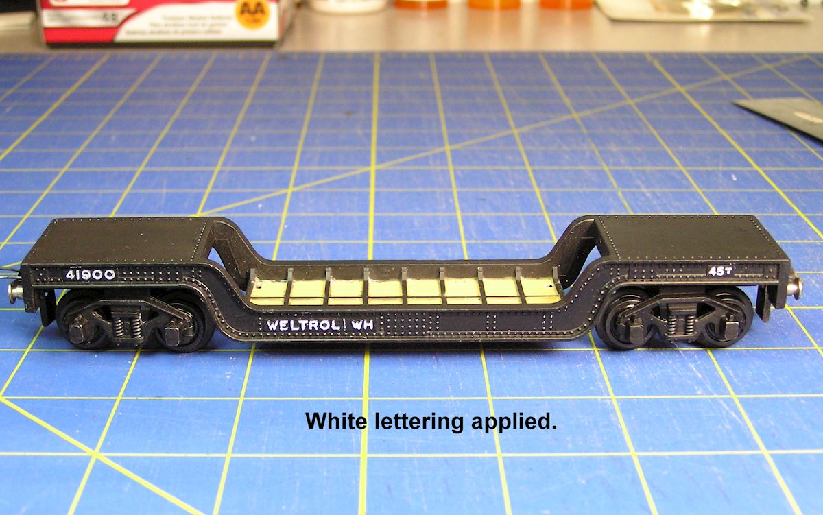

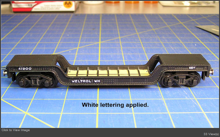

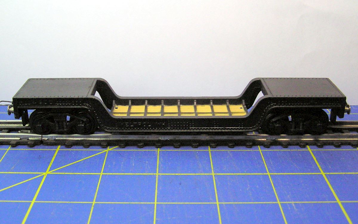

I have a number of loco's that are in generally good condition but where the "Marklin" word and the road number have been worn away from handling.
These raised details are really small and I'm curious to know how others have found the best way to bring the lettering and numbering back to life.
I have a couple of old 3000 bodies to use as my practise target before moving on to other items.
Looking at various videos from the factory, it seems they use a rubber block on some processes (Tamping?) and I'm assuming that the rubber block carries the absolute finest film of paint so there is no bleeding across of run-off (maybe not the correct term).
Even the absolute finest paint brush seems to be the wrong way but I've seen many repaints posted here where this has been done so there has obviously got to be a way (or several).
This is for existing raised printing so decals etc are not an option - I just want to get that fine film of paint back onto the top of those letters and numbers.
Appreciate any input from those who have done it.
And what is the correct colour, is it white? (seems to be more of a silver)
Melbourne
Hi Cookie,
I just found your post about painting raised lettering and came upon a solution some time ago by trial and error.
The key was to find a wooden pencil with an eraser attached to the end. Who remembers them?
Using an xacto knife the sides of the eraser were shaved to form a rectangular end (on the eraser) about 3mm by5mm give or take a bit. Then I took some white enamel paint and applied it to a piece of shiny cardboard with a small brush, making sure that the paint was thinly spread. Then dabbing the eraser end in the paint ensuring the rectangular end was covered in paint, thinly of course, The end was lightly pressed against the raised lettering.
Perfect results were achieved by using this method. The pencil itself provided the perfect handle to the eraser and the length of the whole thing gave good control over the application of the paint. It has seen lots of use since. I have attached a picture showing typical before and after.
Peter B.

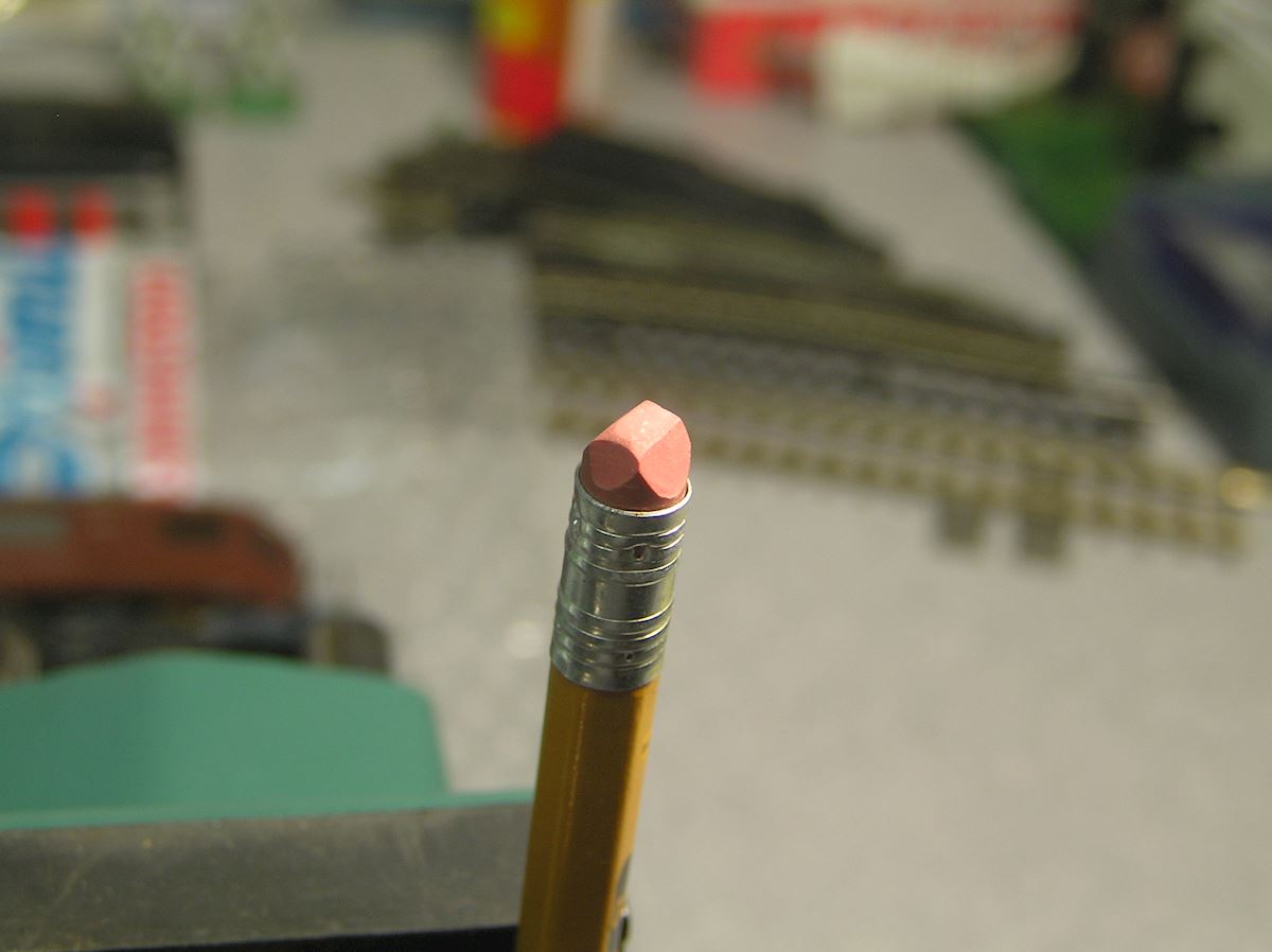

#9 Posted : 27 November 2013 23:08:59(UTC)
Smart trick!
I'll take it as an "advanced payment" for the ROXY BLS Ae 6/8 repair recipe!

Smart trick!
Your are most welcome Jacques. I have attached a couple of pictures of the "Tool". The BLS is lurking in the background.
