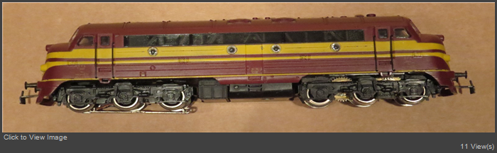

In a discussion with a fellow toy soldiers collector who happens to also collect Marklin trains, I just learned that he bought an old CFL loco at a impressive price.
After further discussing details it really looks like a loco I got in the 70s from an uncle who was a huge Marklin collector.
I think he bought it when on a trip in Luxembourg from his home in northern Belgium and gave it to me on his way back as I was living at the Luxembourg-belgian border.
It really looks like the one pictured above.
The box is a coloured one with various locos on it.
The number 3063 is on a sticker that cover the original numbering (3054) and a drawing of a loco.
Is that the same loco descibed in the article ? What can be its price in 2015 ?

I can only tell you what your locomotive is worth if you post detailed photos of it, taken from all sides, plus close-ups of the wheels, 2 photos of the box with the '3063' decals and the Serviceheft (if there is one). According to your description, it's a 3063.2 (or 3963), and in mint condition (i.e. never used!) it would be worth around 1,000 euros. You should also test the locomotive and open it to check if everything is original.
Collectors would pay more for the first version made from 1965-1967 if the light blue illustrated box and the instruction manual were included; the second version is rarer than the first, but collectors prefer locomotives from the 1960s in light blue boxes.
Probably your locomotive is used, so I need photos to tell you what it's worth. There are also fakes based on the 3066.2!
Mark

Yes it has been used 35-40 years agowhen I was a kid and again 4 years ago when I played with my son (who wasn't much interested).
No booklet anymore and I guess every part is original as it as been with me for all this time (most of the time stored in the attic).

I've had a look at your photos. It seems to be an original 3063.2 from the 1970s and it's still in good condition though a bit used. Have you had a look inside? If it has been converted to digital, you can forget about the collector's value, but if it hasn't been tampered with, you should get at least 800 euros for the locomotive in case you want to sell it. The 3063 decal on the box looks original as well, in comparison with the boxes I have.
Mark

Interesting thread. ThumpUp Sorry to interfere, but why does the 3063 sticker cover the drawing and number 3054? That would suggest a DB electric loco model, and wouldn't the styrofoam insert be different for such an item? Just curious...
The box of the 3063.2 (a.k.a. 3963) was a special case. To start with, that version was usually sold without a box between 1972 and 1976 as it was a so-called 'Teilesatz'. Usually those kit versions were shipped unmounted in unmarked brown boxes and often assembled by dealers, but customers (or dealers) could order a matching box from Märklin. During those years, that would have been a standardised dark blue 'photo' box like the one in Michel's photos, a.k.a. "Hippiekarton" (hippie box) among German Märklin fans. Those boxes were printed in several sizes, and usually featured stickers with the product number of the best-selling model in that category, which happened to be the 3054 in the case of the 26.5 cm box. That explains the seemingly 'wrong' number underneath the 3063 sticker. Märklin had a different styrofoam inset for each type of locomotive (e.g. 3067 for the Nohab/AFB diesel), so that was not a problem.
Another thing that needs to be said is that the 3063 sticker is different from the ones on other Märklin locomotives from the 1970s. Stickers printed since 1972 included an outline or silhouette of the locomotive, not just the number. I suppose that the number of boxes ordered for the 3963 must have been small, and unlike the 3067, 3066, or 3068, the 3063.2 was not in the Märklin catalogue in the 1970s, so the typical stickers were never printed for the 3063.2, though the other Nohab/AFB diesels got them in the 70s. A transparent 3063 sticker on top of a 3054 one is probably authentic; if it's not transparent at all, it's suspicious.
