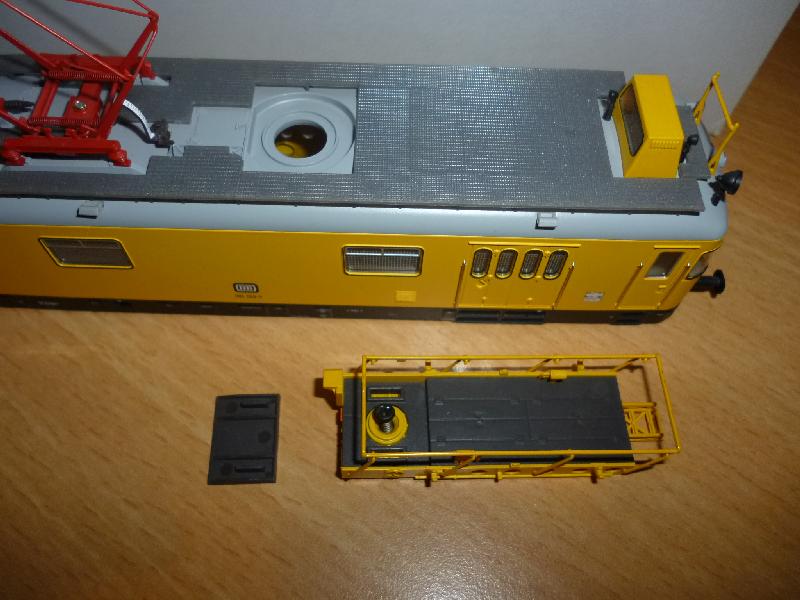

First is the removal of the body, very simple. I suggest you work on a clean rag or something soft to place things down on and to catch anything that might be adrift.
There is a small panel on the platform deck (directly above the hoist ram) which you need to pop out, you'll see a small thin seam where it joins, push down just to the left of the seam and it will pivot up where you can grab it with tweezers. Undo the small Philips screw, remove it and gently lift the entire platform off.
The body is a 'friction fit', and for me I found it easy to place my thumb onto the hoist ram, then place my middle finger of each hand on the bottom edge of the body below the platform, roughly about where the wheels are and just lift with both fingers while gently pushing down on the hoist ram with my thumbs. Kinda hard to explain but easy in practice. Lift the body slowly and you may encounter some resistance when the electronics PCB hits the headlight shroud, mine was a very tight fit here but moving the body about slightly released it, then it just lifts clean away.
Body Removal

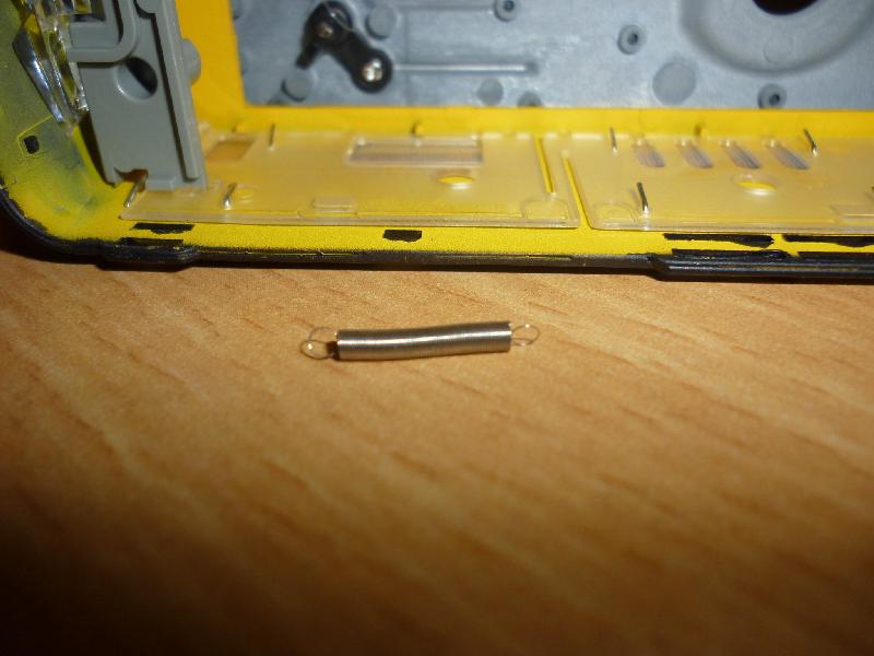

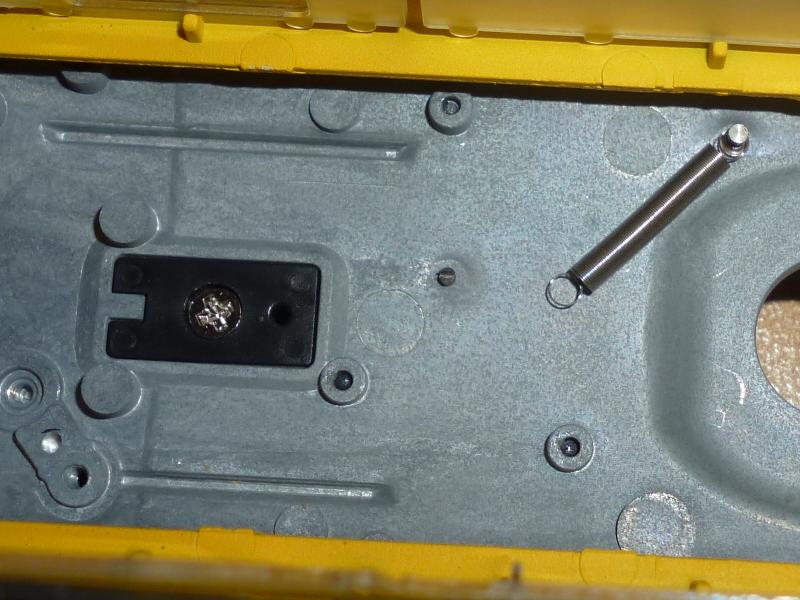

As above, at this point was my first surprise with the spring and very glad I saw it, would have been very easy for it to have passed my eyes unnoticed. If your panto is working this spring will be secured but if your cord has also broken, this will almost certainly be loose within, and with a very real risk of shorting across the electronics PCB so should your cord break, STOP using the Loco until you get it fixed.

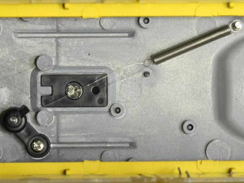

Ok, so here's a photo of the spring and initially I was puzzled where it might have come from even wondering if it was part of the platform mechanism but the more I thought about it this morning and looking at the very limited diagram in the booklet the more I determined that it was part of the Panto drive and pending more detail I decided to take some more photos because I could find very few so here was a perfect opportunity to create a reference for others.
Phantom Spring
Looking in underneath the Pantograph and the upper portion of the drive clutch - this appears to be a one-way kind of clutch mechanism where the pawl will catch in one direction but slip in the other. Unfortunately with the body on there's no way to see the two parts correctly engaged (mated if you prefer) and if I could get my hands on a sacrificial body shell where I could cut the side out at the corner for a 'cutaway' view it would be very easy to see how it works. It may yet be possible to achieve a view by removing the shroud around the drivers cab at that end and with a strong light and a hack of a good lens possibly catch the mechanism in action - I'll keep that thought for another day.
Detail of the underside Panto drive

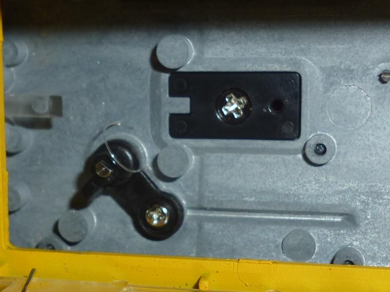

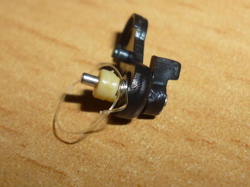

At this point I could see the end of the VERY thin cord, this really was a surprise, much thinner than I thought. Not a lot thicker really than a human hair or a strand of fibre-optic cable. I grabbed the end with my tweezers and gently pulled, it only unraveled a small amount but I didn't go any further at that stage.
This morning I got back into it again at home and this time decided to remove the upper clutch from the roof underside. Here are some detail photo's at different angles and I can actually see them much clearer from these images than with my own eyes - misplaced my jewelers head magnifying glasses which I will absolutely have to find when I get to repair it so I can see!! It's obvious that the cord has snapped and where the other end has gone who knows. And I am a little worried has this broken from the friction of repeated use or mis-use? (accidental I'm sure)
Clutch and cord different angles....
Clutch & cord
Clutch & cord
Clutch & cord

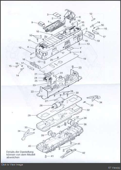

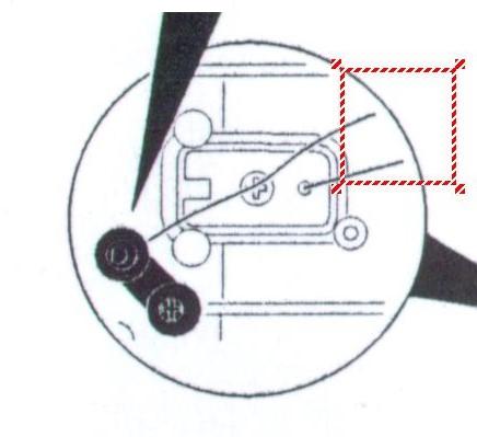

Ok, now I turned my mind to that spring again and a closer look underside after studying this image from the booklet...
Booklet
The cord seemed to just disappear in a loop and I wondered if it went away through the end-loop of the spring. Looking closely at the roof underside was a small post with a shoulder on it just as you'd expect from a spring anchor, and the spring sits nicely here...
Clutch & cord

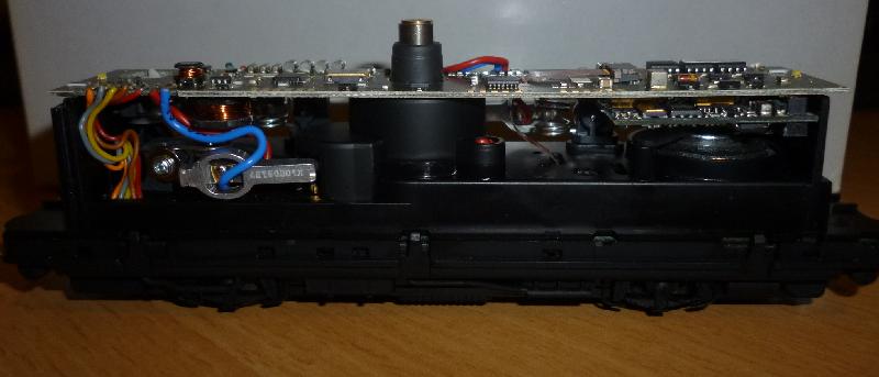

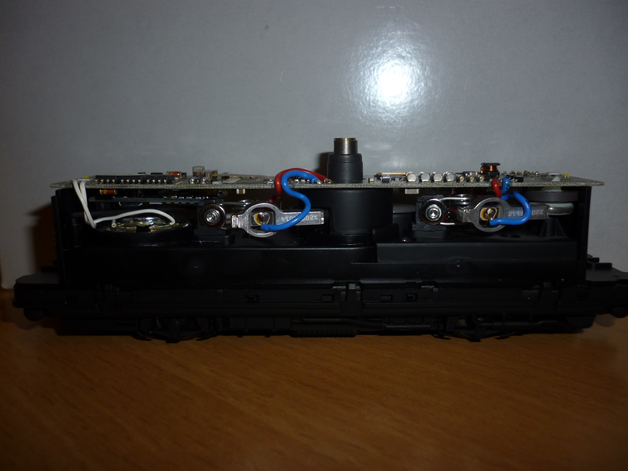

OK, seems very likely. Will find out soon enough. On with some photos of the rest of the interior
One side image....
 One side image

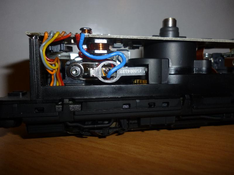

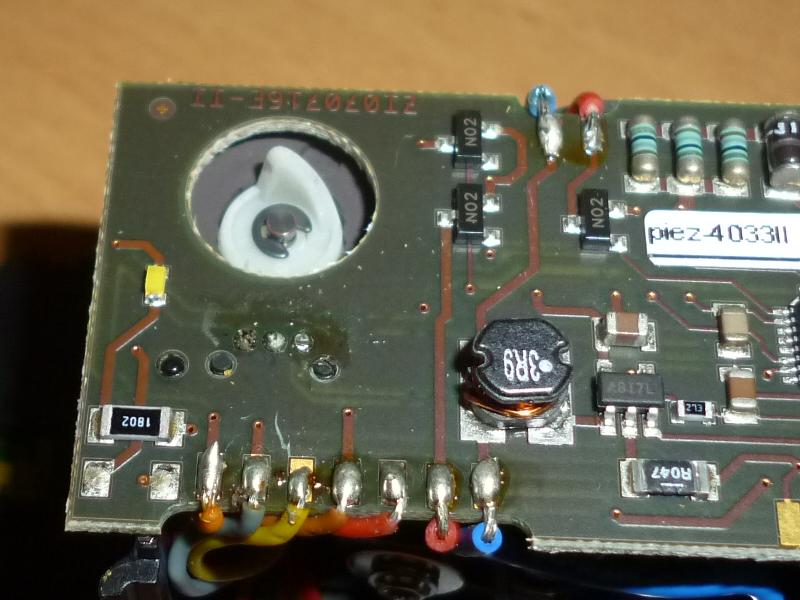

Platform Piezo 1...
 Platform Piezo1
Other side image...
 Other side
Platform Piezo 2...
 Platform Piezo2

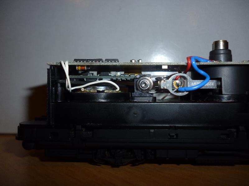

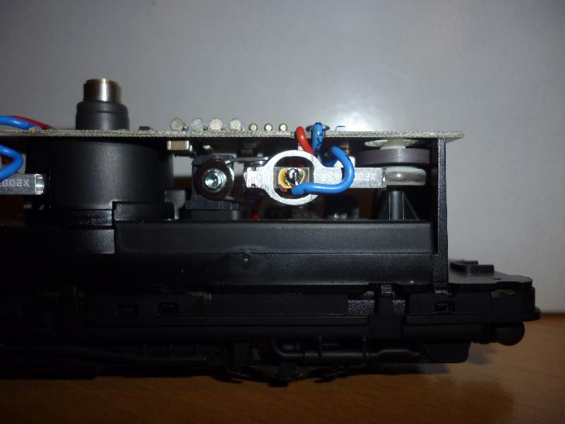

Lower portion of the Pantograph clutch mechanism cam...
Panto drive Piezo,,,
 Pantograph Piezo drive
See above a bit of a possible build-up on the white wheel which I will try to clean off before it gets worse, perhaps with a little Iso-propyl-alcohol on a rag or cotton bud (q-tip)

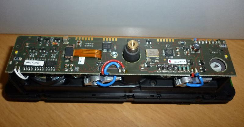

Electronics Decoder/s...
The Electronics/Decoder PCB
** note this Loco has two decoders, the primary one is the Mfx decoder, and secondary decoder for the platform motion appears to be standard Motorola format and of course there is also sound. You'll see a small piggy-back PCB underneath the main one so just what controls what I do not know at this stage.

Having a look at your picture, it seems to me as the wire broke sharply and is not consumed close to breaking.
IMHO maybe the pantograph was lowered and then blocked in that position, which is not recommended in the instructions booklet.
Infact the plastic wire is under the spring tension and forming an acute angle broke (and the tranport shocks help in that).

below is the parts list from the model 39970.
The required spare parts are no longer available.
The model can not be repaired.
We regret that we can not give you an enjoyable message.
Sincerly yours
Märklin Customer Service
Alexandros Karamichailidis
Gebr. Märklin & Cie. GmbH
P.O.Box 960
D 73009 Göppingen
phone +49 7161 608-222
E-Mail: Service@maerklin.de
Well, of course I'm disappointed, but I'm also somewhat realistic - it is after all 7 years since this model was first released, but then again, not yet 4 years since it was withdrawn. It would seem to me that the panto cord would be a bit of a vulnerable item and that replacement parts of this nature might be needed.
So now I have a few questions.

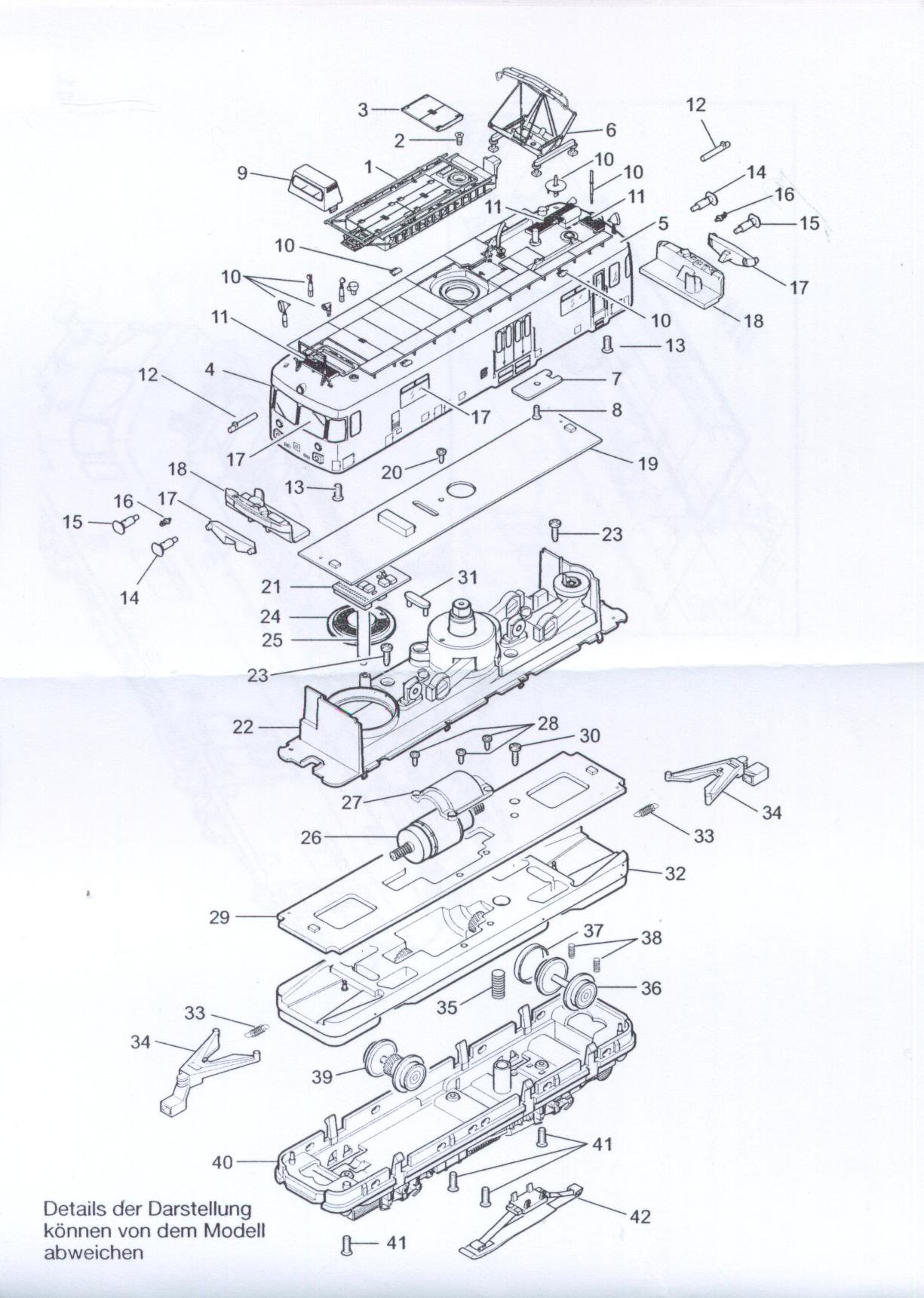

1: The parts diagram shows two different references, one #5 - p/n 115279 for 'Dach' (the roof) and #4 - p/n 115276 for 'Aufbau' (construction, or what I assume to be the body).
Note that the entire upper body is actually two main parts. The yellow body is plastic, the grey roof is diecast. Therefore, if I was to order the Roof, would it come complete with the Pantograph operating parts - ie the clutch to engage with the Piezo, the nylon cord, and the pin for the Panto? (as per my images)
2: The parts diagrams for the 39970 & 39972 show different numbers. The 39972 does not have the operating Panto, so perhaps the difference lies in one having additional parts?
3: Is it more likely that the part I want is in fact the roof assy, which would come complete with the Panto parts but the entire roof assy is no longer available?
What about the 39971? this is the Maroon version, but still has the working operating Panto - the roof for that is p/n 138641
