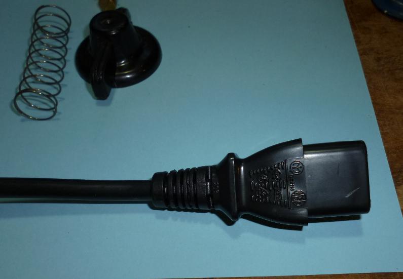

I use normal PC power cords of which I have a good supply, they are the correct current rating, very flexible and being PVC, should last the next 20, 30 50?? years.
Fortunately the 280A in particular is very easy to replace the cord on (once opened up), I just cut the IEC connector off, strip sufficient outer sheathing off, tin the wires ready to be soldered back onto the circuit breaker and reassemble. 15 minutes max.

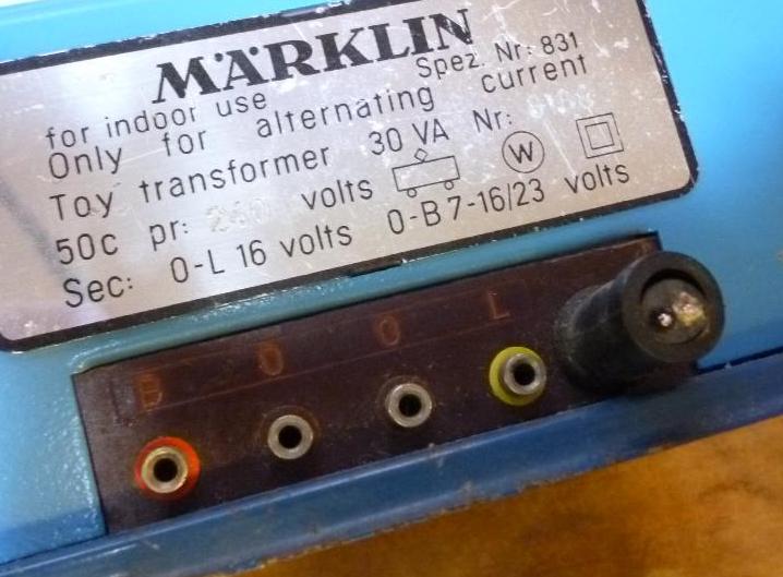

Funny you should mention your 6166. It's not often I have to write-off a Trafo but I happen to have a 6166 ex the club GFS from some years back which needed exactly that for a different reason.
The cord on this one was PVC so it was fine, visually it looks ok (apart from a colour mismatch between the top and the base which was the first "what's wrong with this picture?" alert ) and it actually worked but I could hear rattling inside which needed investigation and the Red indicator light did not appear to work.
The Transformer core is wound around clear plastic which had started to fall apart. At this stage, the only obvious affect was that the indicator lamp was no longer mounted correctly and therefore not shining through the lens. You can also see from the pictures below that a couple of coils of the secondary winding have become free at that end.
In this instance, I suspect that the Trafo may have overheated, or the clear plastic has simply deteriorated prematurely? As it turns out, I also have a very similar 6177 Trafo, never before opened, it came with the factory display layout I purchased in Sydney so it would date from early 70's also. So out of curiosity I've just inspected it this morning to compare.
