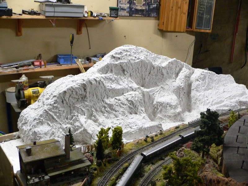

On my layout, because of limited space I used some Sculptamold for rock faces instead of the Woodland Scenics rock moulds (which I had originally intended to do). Sculptamold is a cellulose / plaster mix which has a rough finish when dry. I coloured it with a slate grey wash from the Woodland Scenics earth colours range. Info on Sculptamold can be found here:- http://www.dickblick.com/zz331/04/ and some tips on using it here:- www.northtexasnarrowgaug...d%20Scenery%20Clinic.pdf
Pictures of my layout and rock faces can be found here:- https://www.marklin-user...ault.aspx?g=posts&t=6626

A mountain is a funny thing.Im not saying mine is any good.....but,the texture has to be right.You get mountains and you get mountains.Over here in Africa...our mountains are red and brown.I do not know any other mountain.So naturally i went with brown mountains.

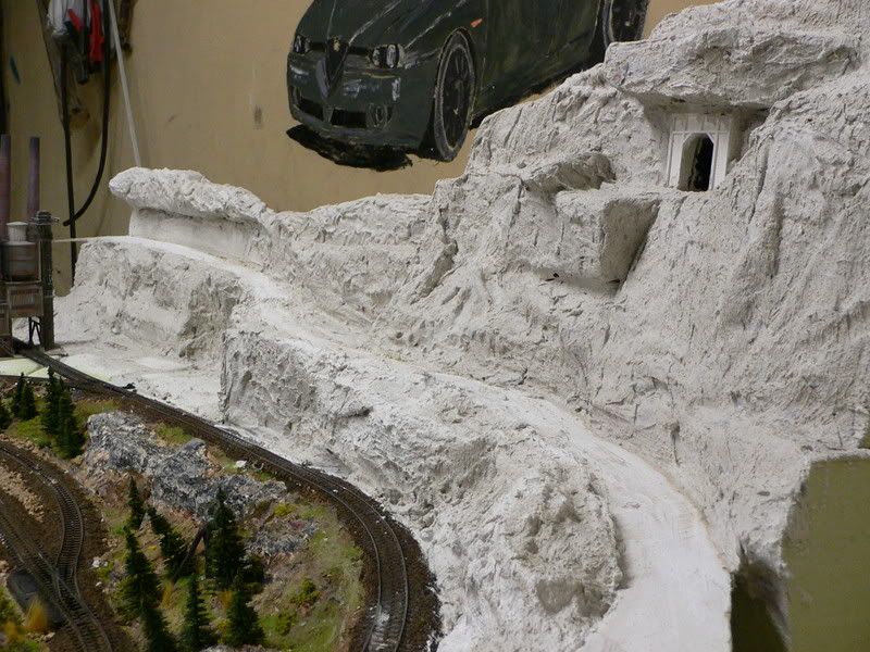

First step.Build the basic shape out of polystyrene off cuts.
We have a product here called "rhinolight".Its a finishing plaster.I then dip strips of newspaper into a fairly runny mix of this plaster and pull it over the polystyrene.I make sure that i get lots of crevices and folds in the paper.It looks like this then
I then make a very dry mix of plaster.You can actually pick it up and form it in your hand.I use a wide big paint brush and paint the plaster with short strokes all over the mountain.This makes it a lot stronger and gives it a very rough texture.
Then the fun starts.Another batch of very very sticky plaster.This time just enough water to absorb the plaster and then a handfull of plaster over the mix to make it tough.This i apply by hand...in thick wads.Now the world is your oyster.You can either take a large flat screwdriver and make rock shapes in it.....
Or you can go haywire and take an old credit card and carve the plaster into shape whilst still wet,
I use burnt umber,burnt sienna,flat earth,light cinnamon,slate gray and black on these.Even splashes of ochre.Little orange here and there and so forth.Im busy with this one.Has about 3 colors in it now.Will get better.
This is also a nice texture
No funny stuff here.Just straight prodded plaster,painted on with a brush.
A last one.I actually finished this mountain today.Just need to prod it and carve it.
