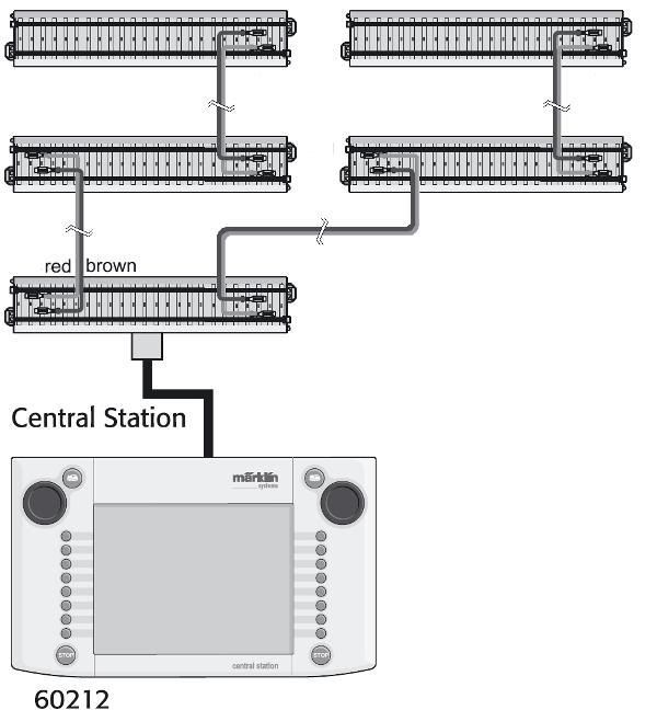

I am getting ready to send my CS to M* USA (when they will be ready for the update). Have a couple of questions and maybe Lutz or someone can help me (I apologize if maybe you have already addressed them here or on some other part of the forun).
Connection to the tracks with CS
The CS I got came from a starter-pack and has a special C track for the connection (24088). M* suggests to feed the track every two meters or so. Should I "pick" up the signal from the feeder track 24088 and then "distribute" it on several locations (approx every two meters) as shown in this example?
Is that ok?
Connection of 6021
The new manual shows this connection to the "sniffer" ports of the CS
The transformer will "add" power to the system? I have a 60VA transformer that came with the CS plus 2 x 42VA transformers (one came with the 6021 and a former starter package, one additional I bought). I believe that in my lay-out 1x60VA + 1x42Va should be sufficient. Does it mean that once I connect my CS and my 6021 as per above schematic I am Ok as far as power?
Should I consider connecting also my other 42VA transformer? In such case I should have a booster but the new manual shows the booster connection without trasformer.
I think M* should address these points on their manual also for customers with medium/large lay-outs. As I understand, the ONLY connection to the track should be through the CS.

Mario:
Your connection of the tracs should be OK, except for a step by step voltage drop. I would make a "ring" of a wire pair along the tracks, maybe 1,5 square millimetres, connected to the green connector on the CS. Then you can just hook onto the wire pair anywhere on your layout. In this case, the voltage drop along the wires are reduced to a minimum, since you have power supply form two sides.
A separate ring must be made for the CS and for any boosters connected to the layout.
6021:
I presume that the power supply to the 6021 is only to drive the unit, no power is tranferred to the CS, only signals. I will use a smaller transformer, as the 6021 requires only a few VA.

I use a 6x1,5 multiwire cable for that purpose, with connection points of about 2m distance between each other.
[size=1" face="Verdana" id="quote]quote:6021:
Correct! The 6021 booster output is not connected to any track/layout, which would normally consume most of the current drawn from a transformer, but rather straight to the 6021 Sniffer input. This doesn't consume much power at all.
However, if you'd ask me now if you could still use the 6021 booster output to control ANOTHER layout than the one of the CS... But I'm sure you'd never think of or even ask about such strange things!
How do you connect more than one transformer to a lay-out when using the CS? I have now three M* transformers and would like to connect at least two to the lay-out. Is this possible? What kind of equipment do I need to do that?
You have to buy boosters and connect them to the CS. Your transformers will give the power to the boosters which will give the signal to the layout.
kind regards
Stephan
Thanks Stephen. That means buying either 6017 0r 60172 and connect my transformer to them and then to the CS.

On my small layout, in progress, I have a separate power feed to my K-83 (6083), K-84 (6084) etc.
So today I have hooked up my 6017 booster (6002 trafo) to this power feed and then to the upgraded CS.
This way I have all the power from the CS to drive trains and all the power from the booster to drive decoder for accessories
And it works [:p] Weeeeeeeeeee

just apply the same thinking with digital circuits as you would do for analog circuits.
You can have a number of transformers (or boosters), but when they are connected to a layout, every of these outputs providing power to a certain layout/track section section MUST be isolated from any other (there is yet a difference - if you connect two transformers together you might be able to grill eggs this way; if you do the same with two boosters, one or both of them will likely or even for sure be grilled!)

Well, almost. You'll need the small green plug to mount the cable to the sniffer port of the CS expansion box.
Any updated and new CS comes now with the following two additional accessories:
- the booster connect cable
- the green 6021 connection plug
