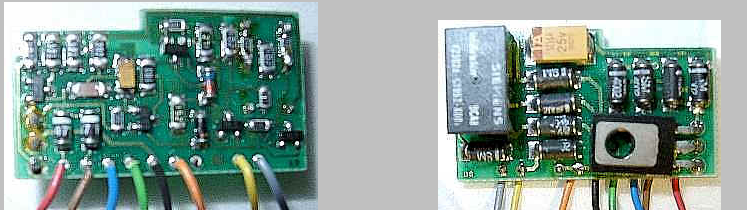

My 3315 has a reverse board in tender that I need a wiring schematics for. I did not see any number on board. I can provide whatever info needed. Thanks in advance.

Hi Thomas
After my search I found that your model (BR50 with tub tender (Wannetender) with DB markings was released from 1987 and replaced shortly thereafter by Delta Digital models
On a German website I found an extensive study of electronic reverse unit and there were multiple types.
The German web site is The good old electronic inverter unit
The unit likely to be yours looks like this
There are 2 wirings possibilities
- a full version with low voltage lamps and direction dependent lighting (Your case I think and a simplified version with standard lights (16 V) permanently lighted
The full version is this
I hope this helps
