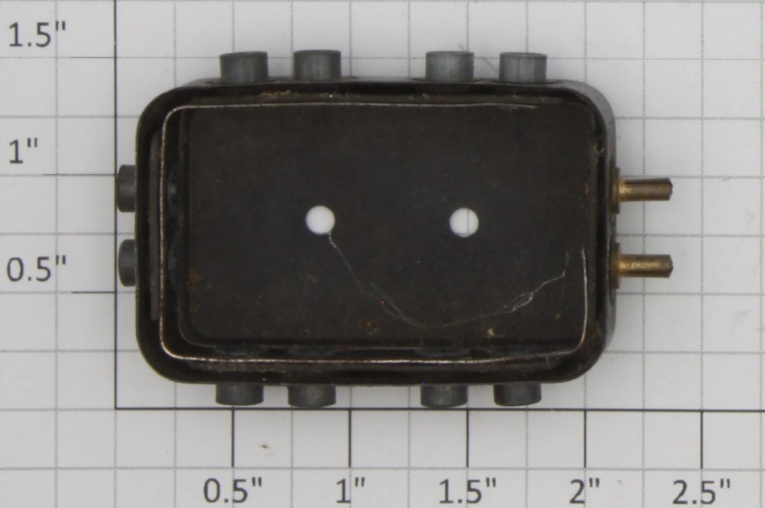

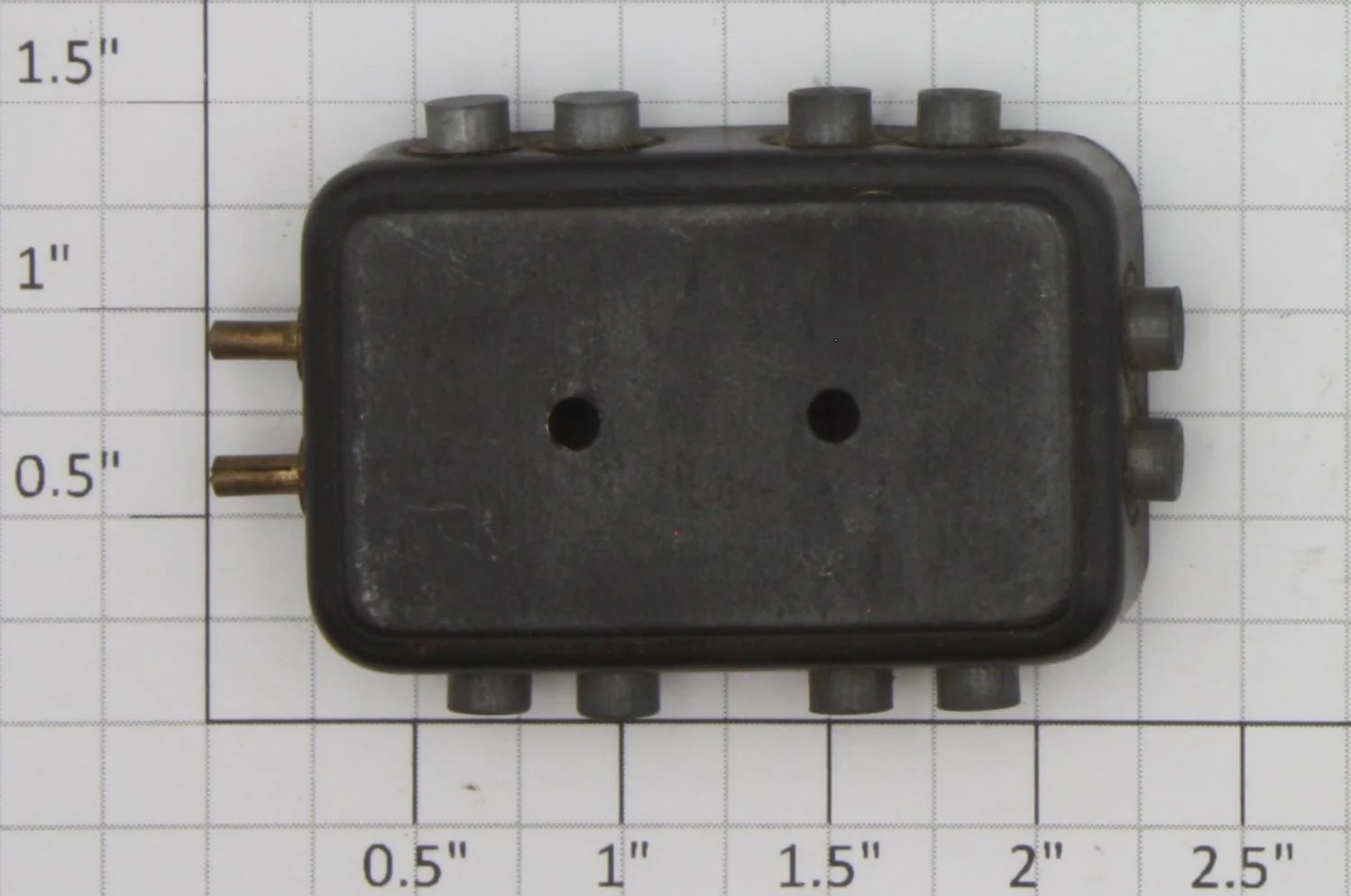

I see these listed online. What is it used for?

Do you have a picture from the underside? Where did you get the 471 from?
I'd guess it could be a current distributor?

It is just a simple connection box. From memory the connections are in pairs. I have a few. From the days when points (turnouts) had two wires only, big lanterns and exposed electromagnets.

471 first appears in a catalog in 1936 as "Verteilerplatte mit 5 Anschlüssen" / Distribution plate with 5 connections. The 1947 EN catalog describes it as "Distributor Plate with 5 double pole sockets". The 472 was similar but had 2 push buttons for "operating 2 electromagnetic devices". Is it possible the 471 was for items which were always "On" but didn't return the circuit back to the trafo through the track?

From the same vendor, here is a photo of the underside. It does indeed appear to be a simple distribution box.
Thanks for the responses.
