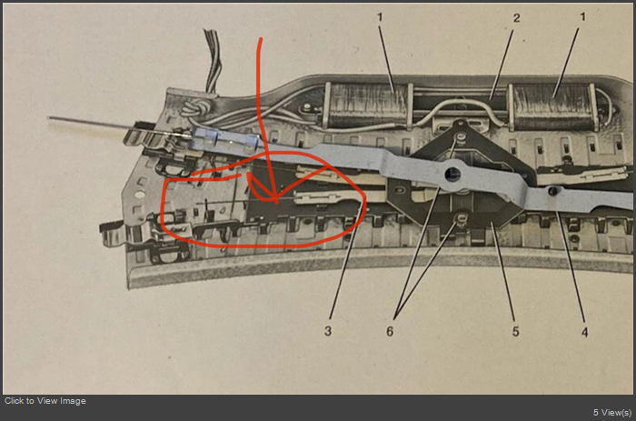

Restoring old m-track h0 layout, have a 5207 crossover where the wire “pin” that flips the track is broken. I tried soldering a paper clip here which works, but is to stiff if there is traffic coming over way needs to have some spring to it.
Any suggestions for how to repair? (I don’t think Marklin even sold a replacement part here except for the whole double arms?)
Picture of needed part replacement :

Piano wire? But what size?

It needs 0.5mm (I think, or even 0.3mm) spring steel wire ("Federstahldraht") that cannot be soldered. They crimped it. If you succeed to open it, you can try to recrimp the new wire, else glue it in with 2 component epoxy resin.

I think using a thin steel guitar string could help
You must check the wire diameter using a caliper

I wonder. 5207 is not the easiest to find but 5128 is much more plentiful and cheaper. I think you will find that 5128 has the same mechanism as 5207. You could cannibalise one for the other.

There are other "federstahl" type material out there; F.x. Tilligs point-motors comes with a couple of them in different thicknesses. (for N and H0 scale points).
I have also once used the Faller Car system street guide-wire.

Try using Nichrome wire which is springy and comes in a variety of diameters and you can get small lengths. The price is not to high if you try Temu or Aliexpress. Aliexpress has been very reliable for all my orders.
