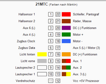

Does anybody know where the common earthwire is on a 392334 factory fitted decoder I'm trying to fit some stay alive capacitors to use this locomotive on m-track and I can't find a manual anywhere I don't want to go in and just prod with a multimeter and hope I find something. Common earthwire is often referred to as the programmer ground.

The 21MTC decoder socket has the same pin layout for all types of decoders. You'd better check for a ground spot on the loco board, not the decoder board.

Hi Clive
I cannot find the loco you mentionned (392334) but the little I know is:
- all factory-fitted decoders follow the same Märklin's wire colour code
- in this code, the frame ground, coonected to the wheels is BROWN
- the common wire for fonction return is ORANGE. It is the RECTIFIED PLUS 5Never to be connected to the frame ground). Pin 16
- the common wire for the MINUS RECTIFIED is pink. This is Pin 20 in the 21MTC)
Here is the full colour code table for MARKLIN (NOT NEM). See green frame
Since more than a decade, Märklin uses the 21MTC (Märklin, Trix Connector)
The assignment of pins is as follows
I hope this helps
