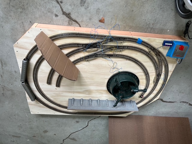

#10 Posted : 17 September 2025 05:20:26(UTC)
Posts: 3,052
Hi gents,

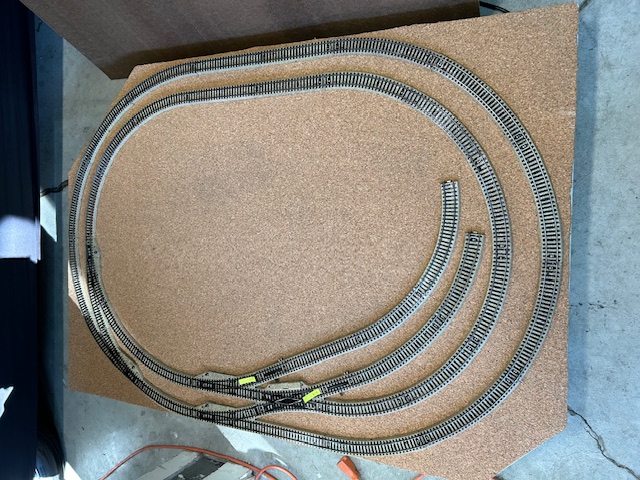

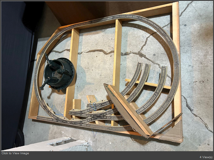

Progress report attached! (I didn't have enough 5200 to complete the loop). This idea/concept is good on several levels, and the green thing shown is the base for the Christmas tree.
More tinkering including a mock up shed to come tomorrow if I have a little time. The track works, I just need to sort scenic blends with the tree...

#13 Posted : 22 September 2025 06:38:12(UTC)
Posts: 3,052
Update: I spent today thinking through this further, and making framework for the baseboard. Due to room fitment, I may need to chop a corner out for the fireplace, and another for walkway access, so I'm working on those details.
More to follow. I'm fairly happy with the track plan and have sourced the missing #5200 curves, although I need to pick them up still.

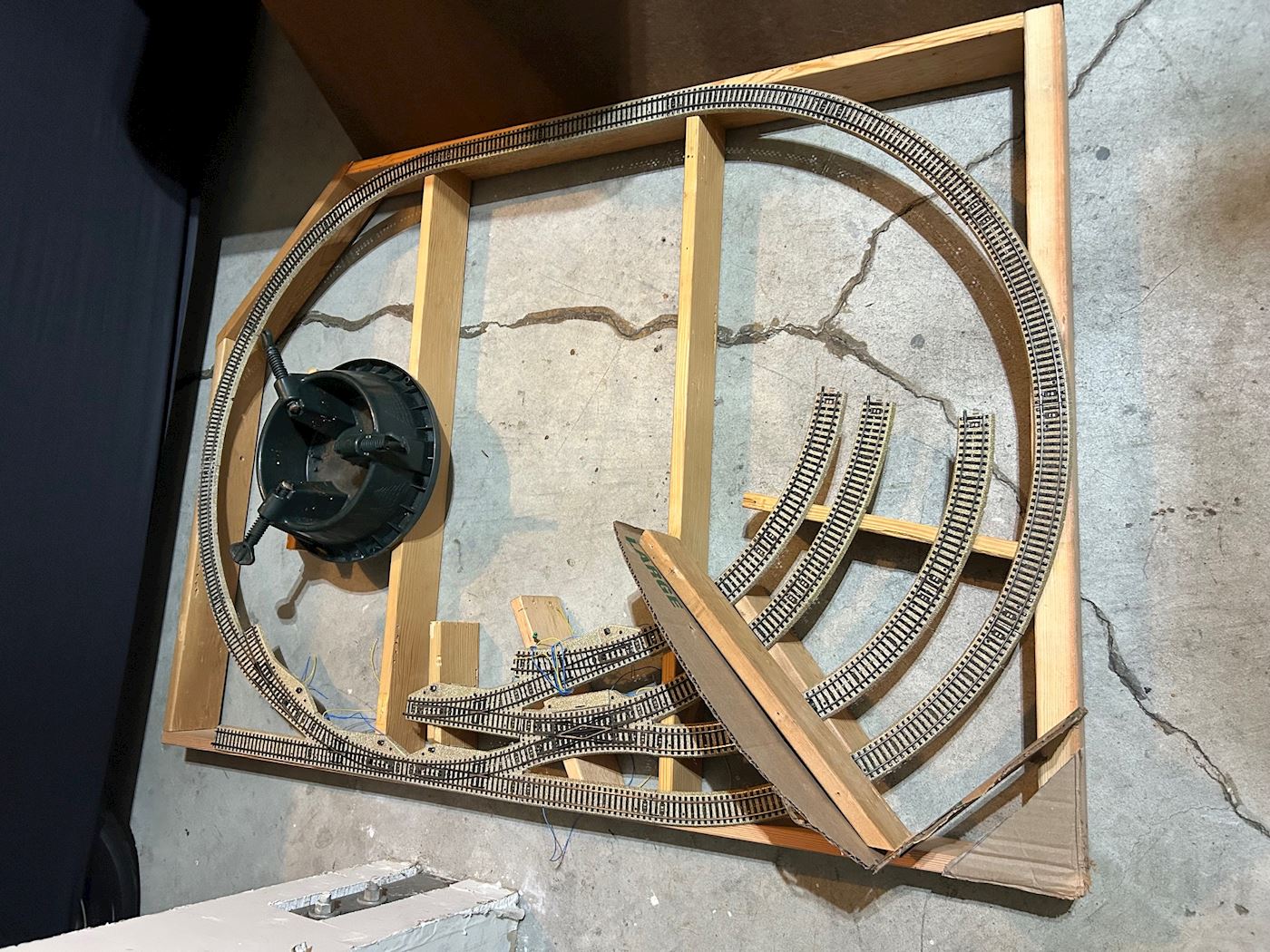

#14 Posted : 26 September 2025 20:28:17(UTC)
Posts: 3,052

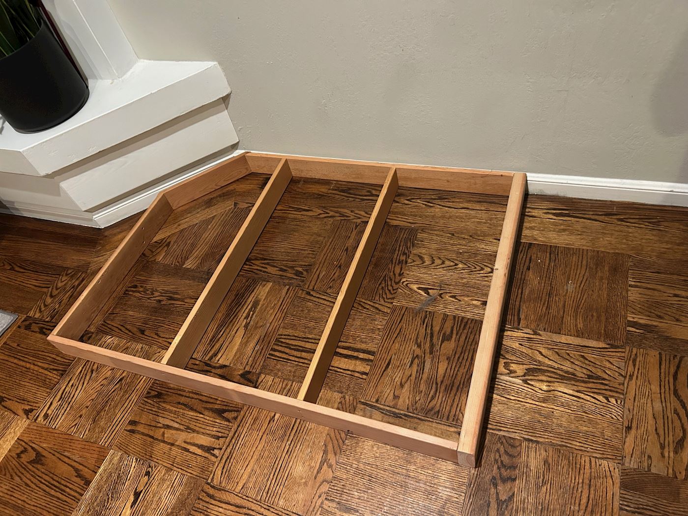

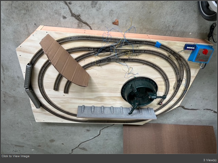

A minor progress report. None of this images are staged, so apologies the quality isn't there.
Track plan is confirmed to fit the space and be functional.
I have been working on the frame, which has lost one corner to fireplace curvature, and will likely need to lose another for clearance upon room entry. The latter is somewhat problematic- but fixable- because it ties back to the station shed I have not figured out yet :)
One critical point I did not mention: with a little exception this whole project is to be accomplished using materials on hand! No incremental purchases if possible, although I am going to need to buy the plywood for the table top. It is also meant to be pure "fun" - not the immaculate planning of a lifetime achievement model railroad! I have the floor space in the house for the month of December, and I plan to make the most of it...
Some images are below. This weekend's projects if time allows:
1- Finish the frame and plan for the shed/elevated section etc
2- Actually cleaning the old M track and ensuring proper functionality of everything mechanical.
thanks 8 users liked this useful post by 5HorizonsRR

Update: I got some of the planned weekend work finished. The board has taken its final shape, and been signed off for fitment by the FD. I also laid all of the track and also confirmed that fitment. (the end product is 3/4" wider to accommodate train overhang)
The "materials on hand" mandate made for a few ugly joints etc in the woodwork, so I will fill those seams tonight, and paint tomorrow. Rest of week goals are gluing the cork underlay, cleaning, testing and laying the track. If I can get all of that done I will impress even myself! Next week electrical, then I'll actually have time to think through and properly go about scenery, which will take me a while...
Speaking of which, total investment to date (reminder the track was donated) is $10.88 USD, which is refreshing knowing I bleed money anytime I walk into a hobby shop :)
If you are wondering where the second transformer will go, well, so am I :) I'll figure it all out later...

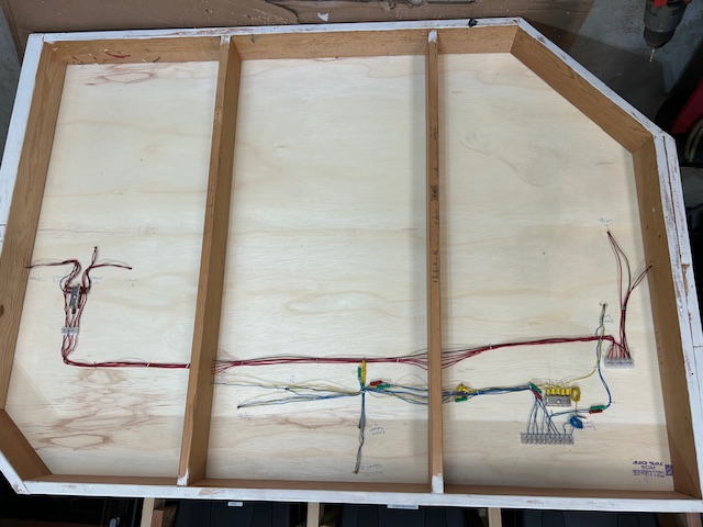

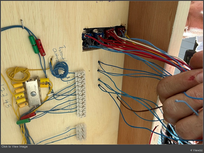

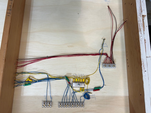

#21 Posted : 07 October 2025 22:59:57(UTC)
Posts: 3,052
Project update! Last week accomplished the following:
Finished the base and secured the top with cork
I have completed a massive cleaning and prepping of the near-abandoned M track. It was in really bad shape, so this took some time. I have to say it turned out wonderfully, but man the track is not great compared to "modern" offerings.

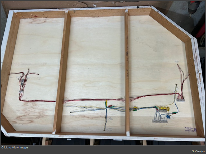

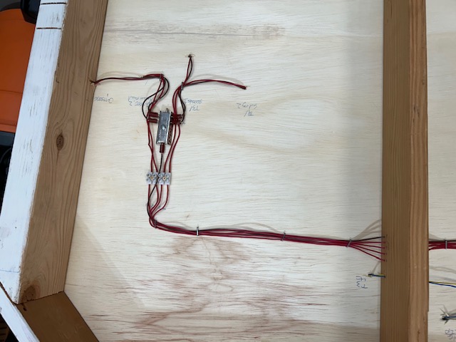

I then changed the track plan again, as well as made a wiring plan. I have split the inside oval into two blocks, so that I can park a locomotive elsewhere on the oval while I move trains in/out/on/off the sidings...

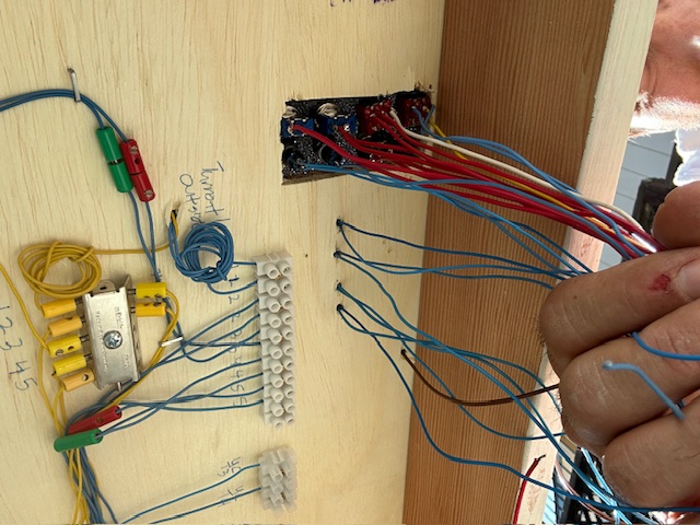

Installed all of the track and wired the whole layout except for the control panel.
Images below! I'm hoping to have a panel in and trains running/bugs worked out by the weekend...

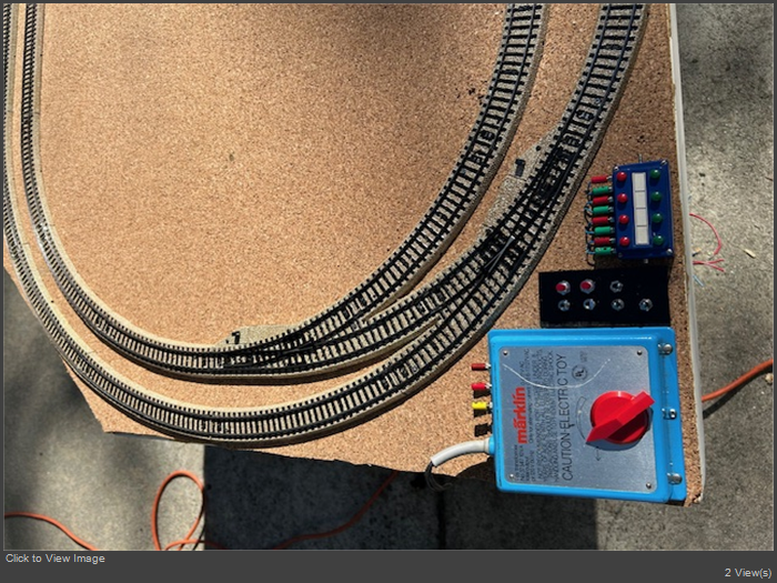

An update and a question!

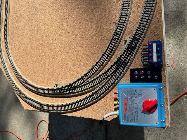

First the question: Are 5207 double slip switches problematic? I have only tested 2 locomotives so far, but they absolute HATE running over mine. Or is there a known issue that would cause such poor running? I don't see anything obvious upon inspecting mine. Have a look at this video:
https://youtube.com/shorts/E0bmAni5MSc?si=qKvQv2y6RgAKiuOg
Now the update: Trains are running! Minus the issue above, everything is great. I made a control panel that fits the real estate and we are in business. Pictures mid-construction:
Tomorrows goal is sorting the turnout issue, if fixable. Then final electrical cleanup.
From there I want to lock down the scenic plan and make some cardboard mockups etc. If I can get that where I want it this week, I can build the covered/elevated platform and start scratchbuilding the station shed.
thanks 4 users liked this useful post by 5HorizonsRR

#25 Posted : 12 October 2025 07:03:10(UTC)
mvd71
Posts: 1,986
Location: Auckland,
Possibly the older loco has wheel flanges that are large and contributing to the wobble. The double slips were never brilliant in terms of smooth running, but that is particularly bad.
Is it the same in both directions?
#26 Posted : 13 October 2025 21:20:26(UTC)
Posts: 3,052
Hi everyone,
I spent Sunday messing around with this. It took 3 alternate turnouts and some bending/filing etc, but I have a turnout that now works. Still a ton of wobble on select locomotives, but at this point I'm going to declare it a sad reality of this turnout design. The important thing is no more derailments...
So with that replaced and rewired I have also added a more powerful transformer and will do more road testing tonight. Assuming we are trouble free and the joints aligned, I can then set my sites back to the scenic plan and mockups!

Here are a few snaps. (no idea why they are loading upside down?)
I'm trying to start playing with cardboard mockups, and the noch walls/portal aren't necessarily what I will be using, but are helpful to get me thinking about scenic effects.
I'm pretty happy with the overall concept, but need to refine the large mass-objects (example: height of that rear wall etc) as well as well as start thinking about details.

I have strayed from the plan. We sat to do scenery and realized the woodwork and the angles involved were going to necessitate some engineering first. The result was (will be...) 2 removable pieces:
1- The back cover/deck. This is cut and fixed, just needing finishing and the scenery.
2- The station, which also extends back as a second half to the cover/deck. This is moving from cardboard mockup to wood as shown. Nothing screwed/glued as of yet....
Looks like I'll need the weekend to get these bits done, then on to scenery... It all moves slow because I only have 1-3 hours per week I can liberate to work on it....
WILL UPDATE LATER- FOR SOME REASON IMAGES AREN'T UPLOADING....

No idea why the previous images didn't work, but we now have two removable pieces. The back side is finished, the station triangle is still under construction but one unified component at this point and starting to look like something.
Goal for this week: Finish and paint both (no details yet) + get the sculptamold ground cover down...
STILL CAN'T LOAD IMAGES? ~200KB JPEG SO IT ISN'T SIZE? UGH...
