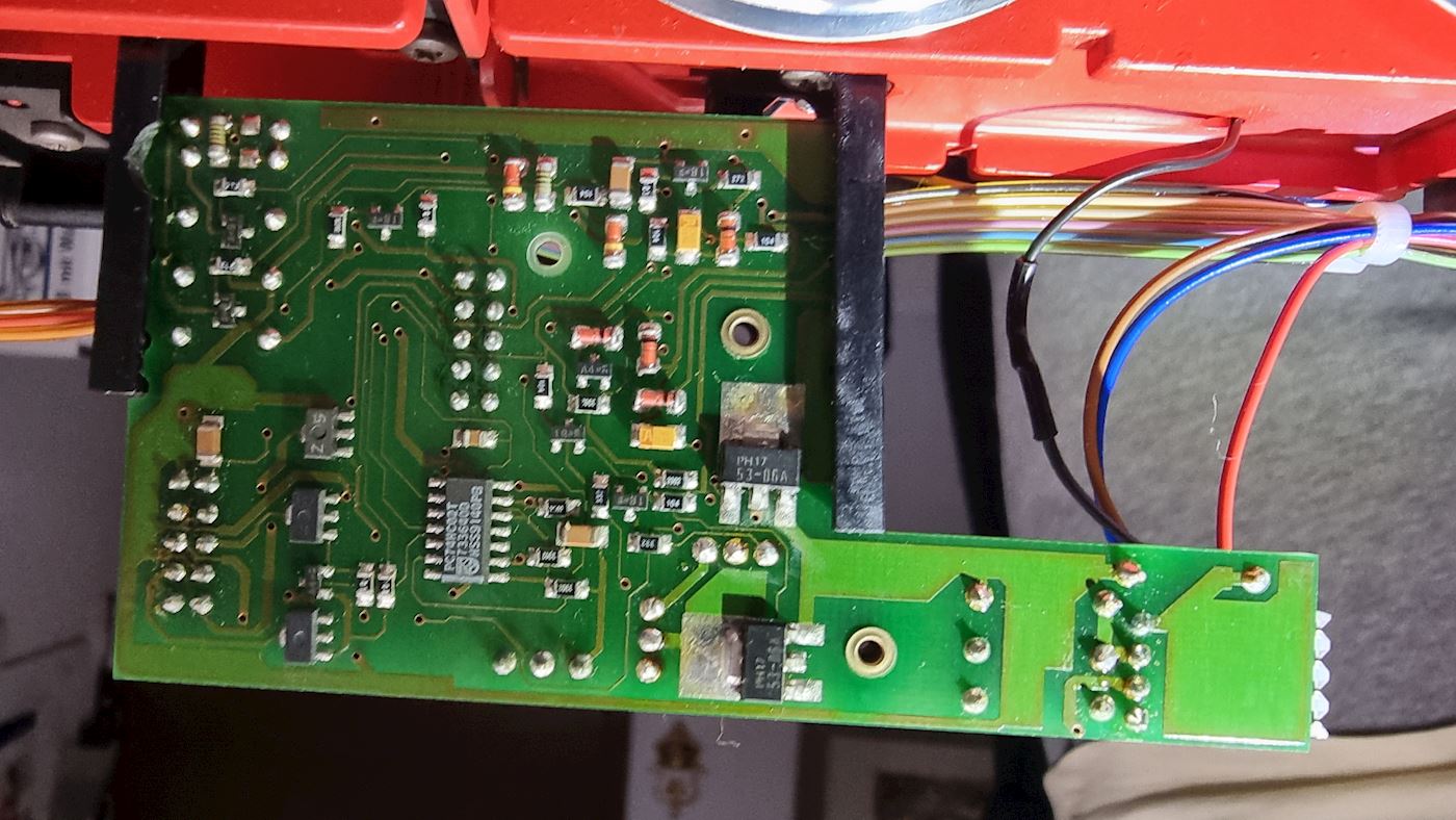

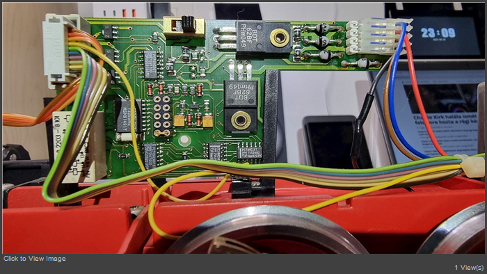

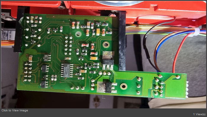

It took some time to actually test the engine. Since I have no documentation I just assumed it has an early Motorola digital board with sound, but 5597 does not appear in the digital database. When I looked at the board in the engine, I realized that this must be an AC board with an analogue sound module.
The big white relay was a clue that this is likely to be AC engine. I tried with an AC power supply and she is running, and there is a basic chuff sound and a reed switch in the tender activates a whistle.
Am I correct that this is an AC board? I don't see any dip switches to indicate that it also supports Delta. But again I assume something is either AC or Delta digital not both.
I yet to test the motors, but I am hoping that is a DC motor (for future ESU retrofitting).
Also I could not figure out how to take apart the tub tender. It feels like the top can be removed, but I don't see any hidden nuts. I want to check were all the different wires go, especially that one of the wire does not appear to be connected. Any of you know the disassembly steps for this tender?
