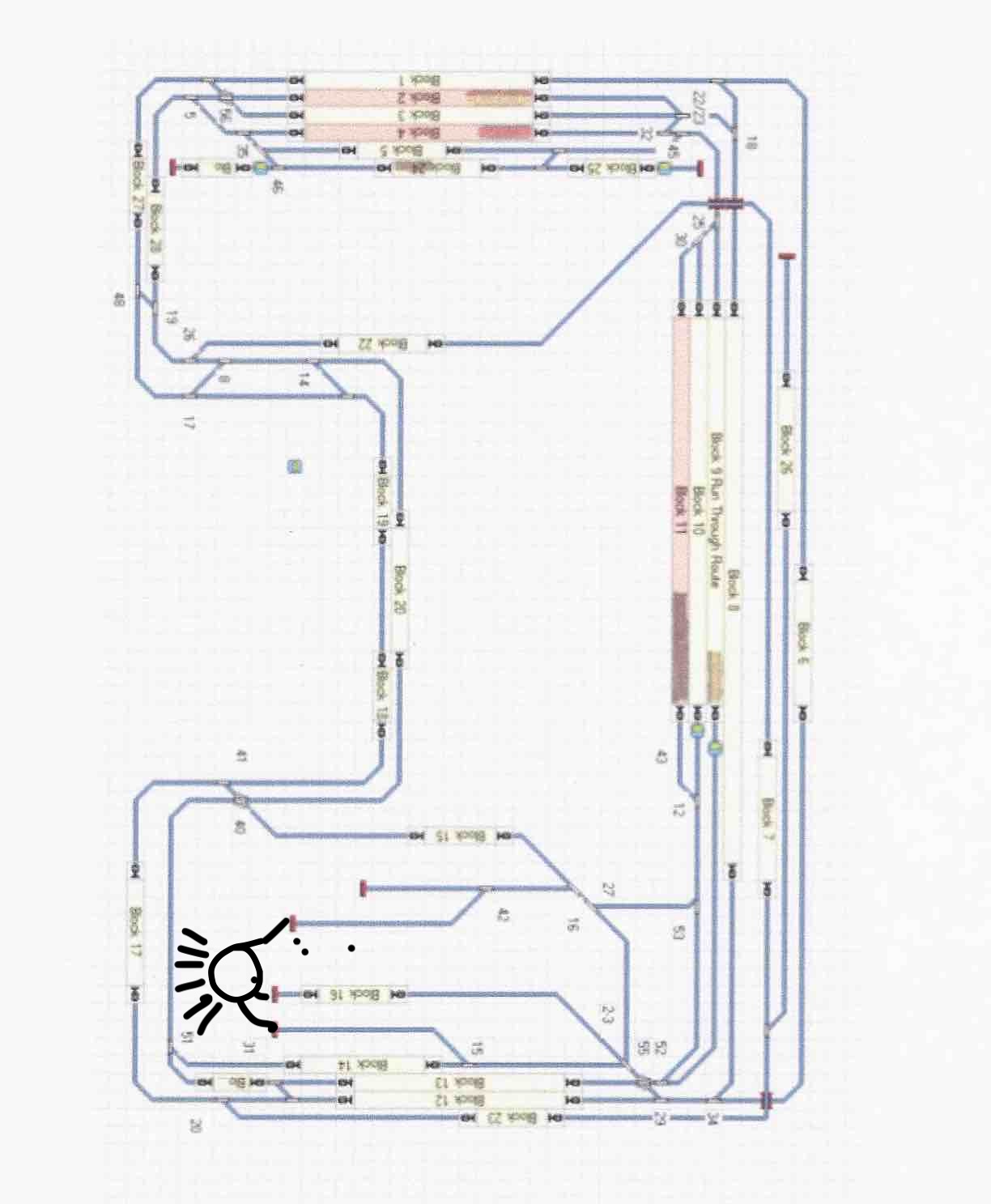

Offline sanjiv
#9 Posted : 13 April 2025 09:05:58(UTC)
sanjiv
India
Joined: 06/01/2025(UTC)
Posts: 18
Location: Delhi
Hi Sanjiv,
Did you get my email requesting more information?
At which location are you intending to locate the 74861 turntable?
Originally Posted by: sanjiv Go to Quoted Post
Hi Ross, Thanks for your response. Yes Im using Traincontroller Gold 10 Ver 10.0B3. Truthfully I haven't done any profiling for the locomotives, but have now understood that profiling is perhaps the best for precision control. control. I have a layout with 30 Blocks. The station Blocks are long enough 110- 130 cms to contain an entire consist including the loco. The others are single track blocks more for direction and route setting .
The above is a copy of my switchboard.This is how Ive made many contact tracks. However for almost 6-7 Blocks I have used Marklin 24995 with cut tracks in between. Ive got about 22 Locos so Im going to start profiling them. It will take some time but will revert once done. In the mean while if you could also think about rendering help on simplifying the process of integrating the turntable would be grateful. Im really been on learning and getting this going
Sanjiv
Hi Ross, I haven't yet received the mail asking for more information. The turntable is located at this location. In fact Block 16 is the Bridge of the Turntable.
Sanjiv

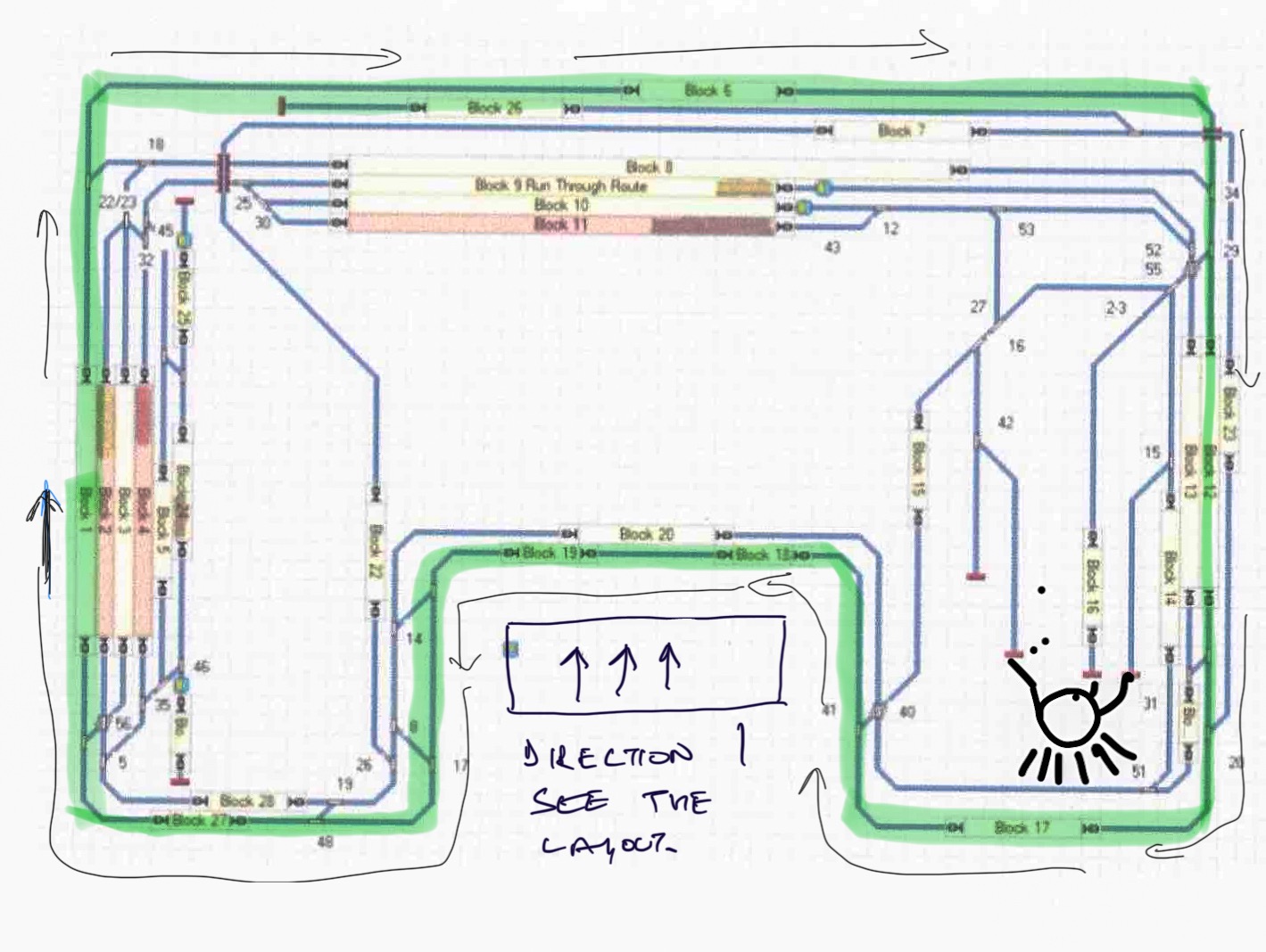

Offline sanjiv
#11 Posted : 14 April 2025 13:41:35(UTC)
sanjiv
India
Posts: 18
Location: Delhi
Hi Sanjiv,
Hi Ross
Above is the layout and how I view it. Profiling will start at block 1 and run all along the green markup in a clockwise direction (as depicted by the black arrows)
I will send you the Traincontroller file on the 16th as I’m travelling at the moment and don’t have access to my computer.
Feel free to email at any time. I’m starting the profiling from the 18th onwards and will keep you posted of the progress and perhaps ask for any clarification if I get stuck.
Thanks a ton for the interest shown
Sanjiv
