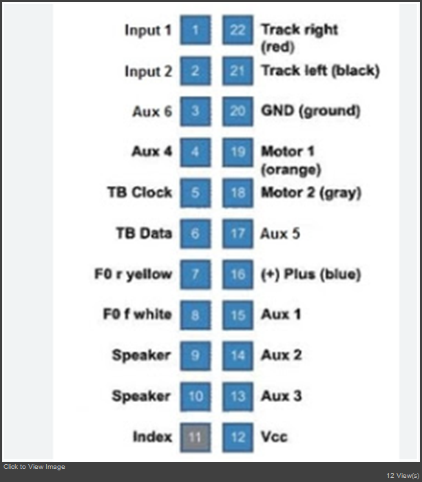

What is involved in converting a Trix DC locomotive (IE 22174 Lollo) to three rail?
This locomotive is analog, DC and has a 21 pin MTC socket.
Would it be as simple as installing a mLD3 decoder, installing a slider, and rewiring the wheel contacts.?

Hi Don
Your loco is 2 rails DC
So to convert it into 3 rails you need to change the wiring
- MTC 21 Pin 22 was track right now is connected to slider
- MTC 21 Pin 21 was track left now connected to both track left and track right
ATTENTION: the figure above is misleading: PIN 20 is ONLY the common return for digital fonctions AND NOT the frame ground.
Installing an mLD3 decoder, your loco is now 3 rails analog and digital
ATTENTION: double-check the wiring before applying power

Thank you Jean
that's great information!
I already have the appropriate slider and I will rob a decoder from one of my other models to test this out.
Don

Well, that worked out just great. As I said, I had the slider in my parts bin, and I invested in a low cost Lokpilot basic DCC decoder ($35.00 CDN). At that price, I decided not to steal one from one of my other locomotives.
I utilized the rear bogie DC wheel pick up and simply unsoldered It's red wire from the circuitboard and soldered it to the grounding lug on the bogie with the brown wire.
I plugged in the three rail slider in the front bogie, and plugged in the Lokpilot decoder.
Very simple. After the third attempt at automatic motor calibration, it now drives perfectly as expected.
