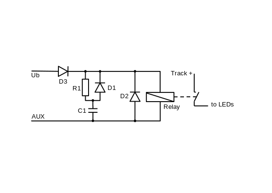

Drawing:
I am sorry, but I do not understand your drawing.
Let me first admit, I do not know ESU 50709 hands on, but from reading and from other projects I infer AUX is an open collector transistor capable of switching up to 100 mA to ground.
Based on this assumption, your relay would be connected to Ub (decoder's supply voltage) and to AUX. In parallel to the relay, you'd insert the buffer capacitor C1 (a few hundred uF, 35V) in series with a resistor R1 (a few hundred ohms) to limit the inrush current, and a diode D1 to enable unrestricted current flow should Ub be interrupted.
On top, to be on the safe side, you'd optionally use a diode D2 antiparallel to the relay to absorb the inductor's turn off current spike, and diode D3 to avoid the capacitor supplying current back into Ub should that fail.
I'm happy about comments or corrections to this proposal.
Rüdiger (Rudi)

Drawing:
Thank you Rudi! This is indeed my solution, except I have not added D2 or D3. I am going to reconnect everything tomorrow, and report back with images and details. I will also test it with the addition of D2 and D3. I appreciate your validating my logic, and making these suggestions!
#16 Posted : 13 April 2025 13:57:45(UTC)
Posts: 8,717
You will not need the diode across the relay coil as the resistor and capacitor will damp the switch off spike. There will not be much of a spike anyway as the capacitor will keep the relay operated for a period after the aux output turns off. When the output turns off the relay will slowly drain the capacitor and will drop out when the current from the capacitor through the relay coil gets below the minimum hold current for the relay. There will still be some flowing from the capacitor after this happens until the capacitor finally looses all its charge.

It looks like I have managed to resolve the issue. I pulled everything apart, and started over on the bench (as opposed to inside the passenger car), and with new components.
Sure enough it worked, I'm not sure if the previous capacitor was no good (haven't tested yet), or if it wasn't large enough (I moved from 470uF to 1000uF, but everything works perfectly now, with about 2 seconds of buffer. I re-installed everything in the coach, and it is still working nicely
Thanks to all of you for your help! This is a really viable solution for which I tend to convert many coaches. My alternate approach will be the same relay concept but with an accessory decoder instead of the light board decoder.
I need to take a video once I run the whole set on the layout.
