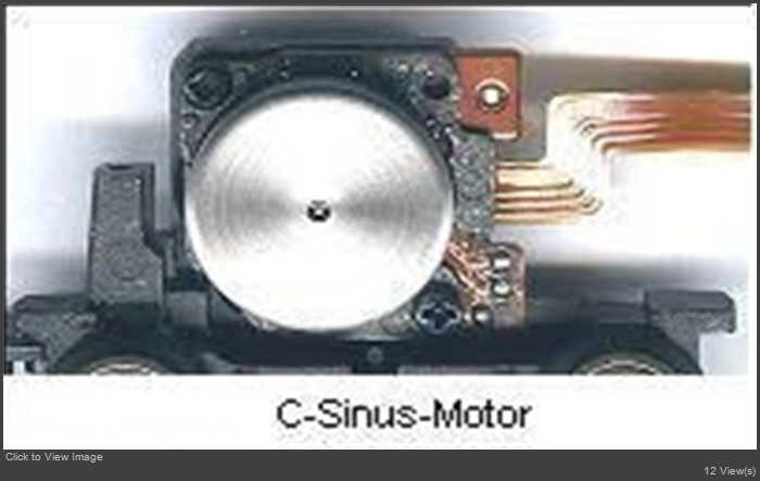

Here is the motor which is in the locomotive.

It may be hard to get an OEM replacement decoder for the classic Sinus motor. There may be a solution from ESU.

It might be the driver that is faulty.
3rd party drivers are available from rail4you.ch. https://www.rail4you.ch/remotorisierung/dsm-2-0-der-treiber
you also need a new decoder. ref the rail4you.ch page
Another option might be to fit a conventional motor and a new decoder. (you might need to replace the bogie, but that might be expensive)
I think you're 100% correct that the driver is faulty or in this case it was damaged. I've been spending a fair amount of time on Google and I came across a post on the group where someone had the exact same train and said there is a voltage problem and this is a know issue with this driver board. This person chose to go the route of fitting a conventional motor by replacing the bogie, so probably as you said, expensive.
I also found a post about the driver you mentioned from Rail4you, I'm thinking this is the route I will probably go cause I'd like to keep the Sinus motor, just hope that the voltage issue didn't damage the motor. Would you know how much the driver from Rail4you costs?
I paid 80€ for the driver in 2020. (without shipping)
I also forgot to mention that the driver is a bit sensitive to power interruptions so a power pack is strongly recommended.
The c-sinus motors seem to be more "robust" than the original drivers, and my first-generation C-sine motor survived my soldering etc. (the motor in 39710 does not have flat cable)
I'm happy with how my 39710 now drives, even if the upgrade was a bit expensive.

Since I've dissected the locomotive further, I've found the driver board is scorched as well, is it possible through all of this that the motor could have been damaged as well? I don't want to order a new driver from Rail4you just to find out later that the motor is shot too.

See if the gears turn easily and if they are not locked use a 9v battery to power the motor. Or you can also just test the motor for resistance with a multimeter.
You cannot do that with a C-Sine motor, it needs electronics to drive it.

I've been spending a lot of time trying to figuring out how to fix this locomotive. I was initially going to get a driver board from Rail4you but without being able to test the motor to ensure it's not damaged, it would be a very expensive exercise in trial and error. I started looking on eBay to see how easy it would be to find a replacement motor, well, that was an exercise in futility, couldn't find one with the same part number but eBay gave me a suggestion, there is a motor from a company called Mircromotor.eu which is supposed to be a direct replacement for the C Sinus motor, was wondering if anyone here has tried using this motor. Here is the website and part number is HM001G: https://micromotor.eu/Mo...ts/H0-Gauge/Maerklin-H0/

I have heard of some modellers who have replaced the large sinus motor (C-Sine) with the normal motor from subsequent models of the same locomotive type. You would need to remove the motor, the PC board and replace both with the parts from the non c-Sine version.
I am guessing that this job would require experience with this kind of work and is not something that a beginner should undertake. Micromotor.eu might be an option, but I don't know what you would need as far as a PC board.

Hello Mike,
I too had a dead #39572 & the main board was burnt & very hard to get. So I stripped it all & I got a second hand front bogie & fitted a high propulsion motor & made up a board as in the picture & fitted a Lokpilot M4 decoder & it runs as sweet as & not expensve to convert. In one of the pictures you can see the damage to the board & why I did what i did. Parts for this loco are very hard to come by. The only sound it made was that of a horn & I retained that sound board seen in the picture.
