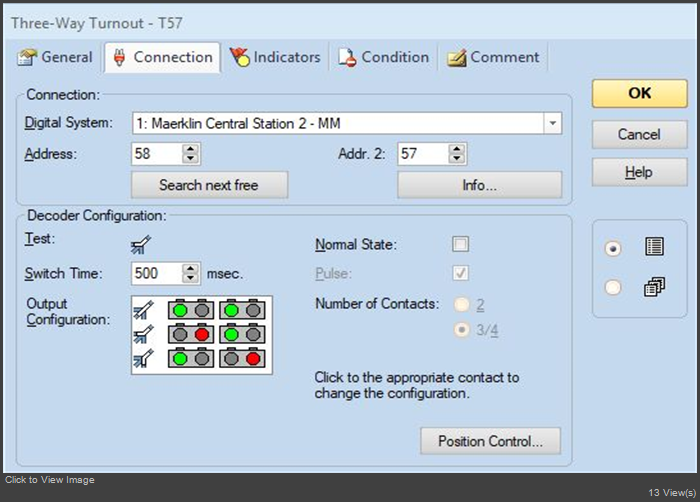

For what it’s worth. I had a CS2 and TC version 9 and earlier. As I recall the order of the two turnouts (of the 3-way) in the CS2 was changed compared to the CS1. Don’t know about the CS3.
Here is a screenshot of the connection back in 2013 with CS2 and an earlier version of TC:
Note. Address 2 lower than Address.
Offline tgj
#5 Posted : 03 April 2025 16:00:15(UTC)
tgj
Joined: 02/03/2025(UTC)
Posts: 25
Location: Rinkenæs, 6300 Gråsten
Hi Blid,
Thanks a lot for the insight and the screenshot — really helpful!
I’ll definitely try your suggestion and let you know how it goes. I noticed you’ve set the Switch Time to 500 msec — was that setting necessary for things to work properly, or just something you found useful?
Interesting point about the order of the two turnouts changing between CS1 and CS2. I’m using a CS3+, so I’ll keep an eye out in case something similar applies there.
Thanks again for sharing!
Thorben

My previous example was wired for CS1. Here is an example from 2016 when wired for CS2:
Later on I draw the 3-ways as a left turnout immediately followed by a right turnout. I think that had to do with my monitoring of the turnout position (and turnout motor behavior) rather than the 3-way symbol not working OK.

I didn’t have a problem with 3-way turnouts when defined as such in the CS2 and TC. The problem I had were the Marklin C-track turnout motors. I monitored them with s88 sensors as suggested by Littfinski, LDT. When I split the 3-ways it was easier to mark the turnout motors that didn’t work. After some years any many replaced motors I realized that I should have just bridged the micro switches in the motors.

I forgot. An advantage with the 3-ways, when defined as such, is that the controller sends a straight command when turning the other. You won’t end up with turn left and turn right at the same time.

After sending my latest post I noticed an error in my second example. The TC default is for 3-way turnouts where the right turnout is before the left turnout. Marklin C-track is the other way round. It is also recommended that the other turnout is straight when one is thrown. This is what I suggest:
For a right turn the left turnout MUST be straight. It was missing in example 2.
