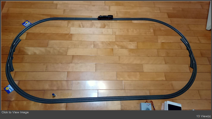

I made a simple track layout expanding 5m long around metering by the tape measure. The length is approximately 435m in real distance (5m*87).

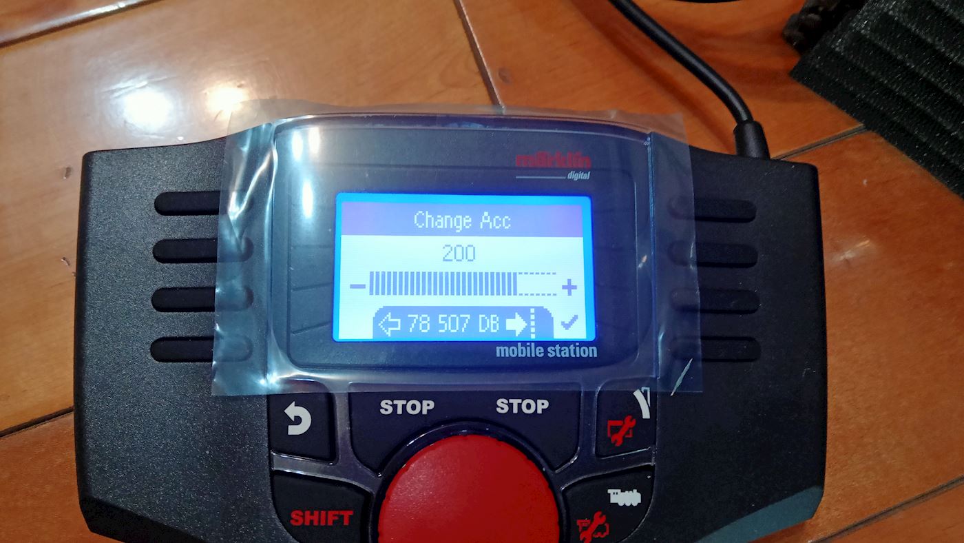

I set the parameter of ACC (Acceleration) and DEC (Deceleration) respectively as 200 and 255. The testing locomotive is DB BR78, therefore, I checked out Wikipedia regarding the information of this locomotive, which describes the maximum speed is 100km/h.

I set a “start” of the track and started up the locomotive with the knob turning into the right end for getting the large amount of current. The locomotive gradually speed up by means of the setting of ACC. When the loco was being in full speed and was passing through the “start”, I pressed the button of timer until completely running a loop of the layout, I stopped the timer.

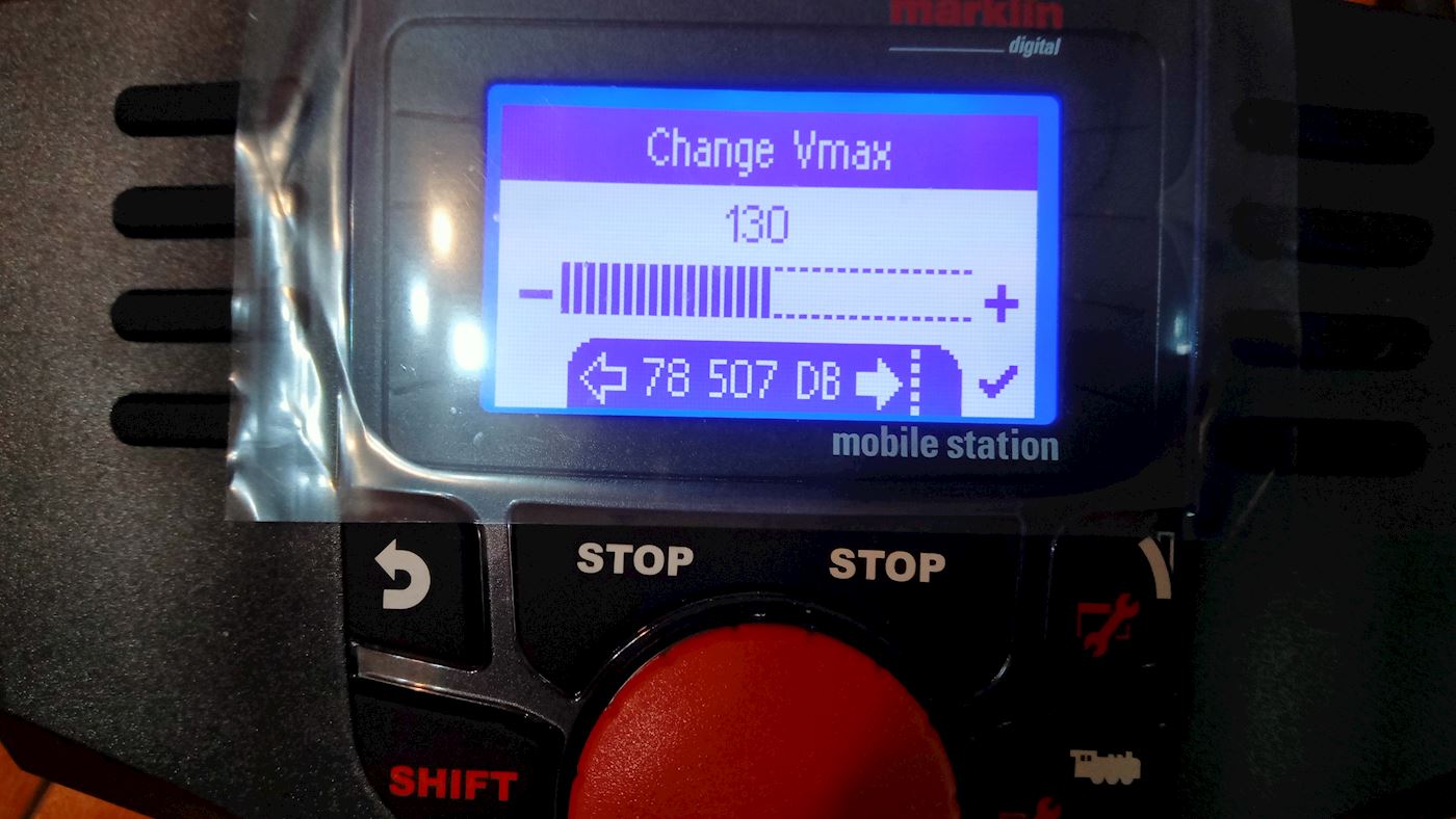

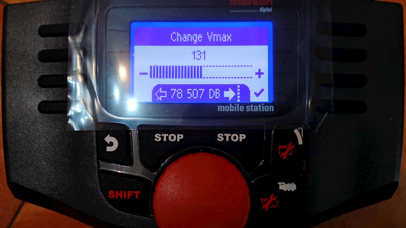

According to the upper parameter, I lowered the Vmax as 131, this time I got the time about 15.41 seconds which means the speed is 0.435km*3600/15.41=101.6km/h close to the reality.
STAGE 6
The Vmax is adjusted a bit to 131 which got the time 15.53 seconds. The speed is 0.435km*3600/15.53=100.8km/h equivalent to the reality.

It seems strange that you would get a SLOWER speed with Vmax=131, than with Vmax=130. What gives¿?
Thanks for reminding me of this mistake. The prior test was parameter 131 corresponding speed is 101.6 km/h, then lowered to 130 corresponding speed is 100 km/h
