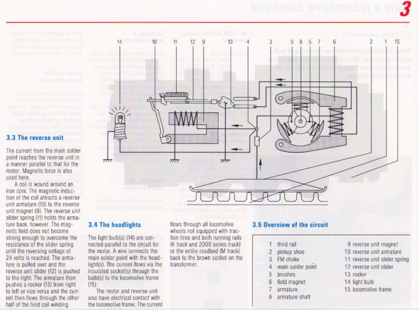

Guys, I’m trying to see if this motor is working before I buy a decoder. It’s a 3003 BR24 and we have it all apart. Can anyone draw some lines on this photo to help me figure out how to wire it for testing?

Offline TrainIride
#5 Posted : 13 March 2025 08:12:42(UTC)
TrainIride
Joined: 23/10/2010(UTC)
Posts: 2,083
Location: FRANCE
I cannot see clearly the picture,
so please find hereafter a drawing for the wiring of old Märklin models of this kind:
Hope this helps,
Best Regards
Joël

Offline TrainIride
#6 Posted : 13 March 2025 10:33:14(UTC)
TrainIride
Posts: 2,083
Location: FRANCE
Some more details:
Don't forget the brushes :
Best Regards
Joël
Offline johnhendry
#7 Posted : 13 March 2025 15:42:36(UTC)
johnhendry
Joined: 06/11/2024(UTC)
Posts: 59
Location: Georgia, Atlanta
This is EXCELLENT!! Thank you Joël!!
