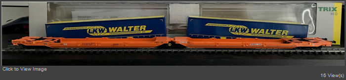

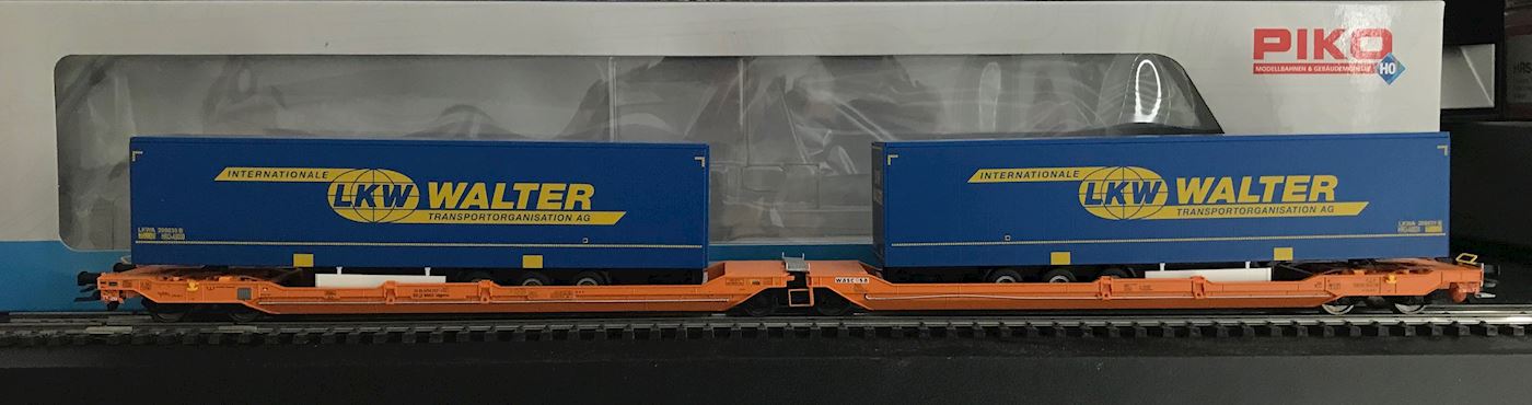

For the purposes of this review, I have taken my Piko and Trix Wascosa T-3000 cars, both of which will be running with LKW Walter trailers as loads.
Piko:
Car Unloaded
Car Loaded
Bridge between halves

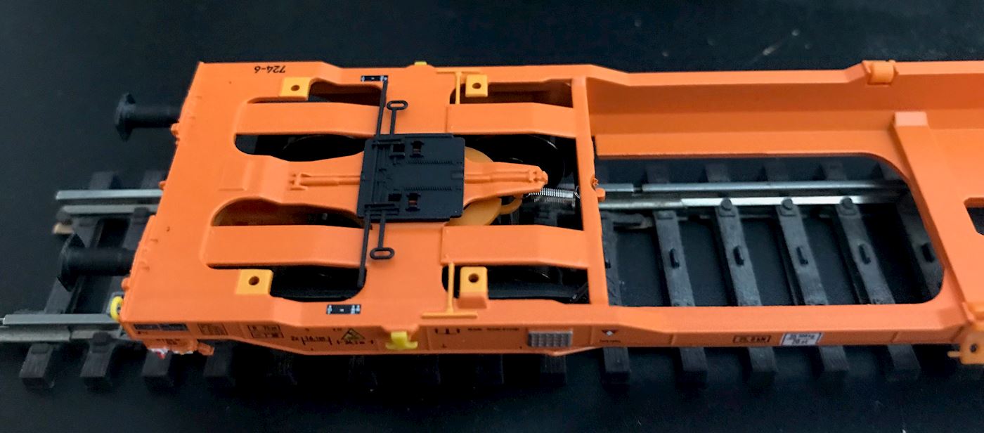

Fifth Wheel Mount
Container Mount Fittings
The Piko T-3000s all use the same prototype with 4 folding pins per car half. This means that you can seat a pair of 20 foot containers on each car half for a total of four.
I have found that there can be some difficulties mounting Herpa or Maerklin containers on the Piko model. The pins do not perfectly match up with the mounting holes and the folding pins may not always work properly as seen here:

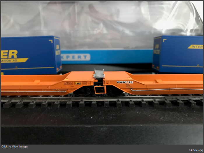

Maerklin/Trix:
Unloaded
Loaded
Bridge between car halves

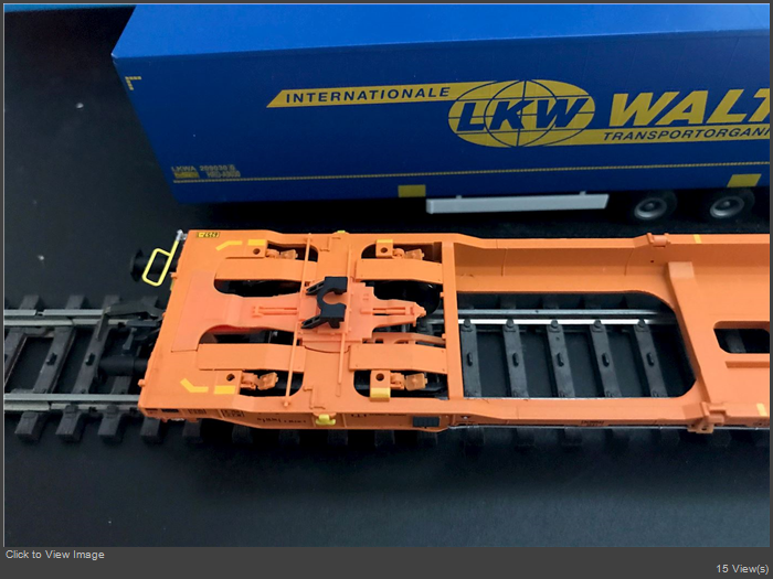

Container mounting pins
Fifth Wheel Mount (Not fully installed)
Maerklin (L) and Piko (R)
I had no problem mounting the four 20 foot containers or two 40 foot containers on the Maerklin car. I also tested it with the 45 foot containers from my 47051.001 Samskip cars (no photo). The 45 foot containers use the same fittings as the 40 foot ones. I did have some issues with the 45 foot container from my 47051.006 Geest car, but it seems that there is a problem with the container pins on that model as it also was problematic with the original car.
The folding pin mounts seem to be better designed on the Maerklin model. The mounts have to be clicked into place, but once set, they remain in place. This is a better solution than the pop-in clips used in the 4744X T1 type car.
I don't know if I would mount 23 foot swap (tank) containers on this model, as all of mine (Maerklin/Herpa) have sockets and require Herpa's 084192 Adapter to be used with Maerklin cars with sockets. I am not certain how well the sockets on the Maerklin T-3000 will work with the Herpa Adapter in terms of holding the load in place. I trust it more on the flat surface of the 4705X type Sgns car. I will try it at some point and will update at that point.
The Maerklin Wascosa and MFD Rail cars have some differences from the DB one. They come equipped with four folding pin mounts per half car or 8 per side. This means that there are additional mounting possibilities not feasible on the Maerklin DB or the similarly realized Piko model, including 30 foot containers:
