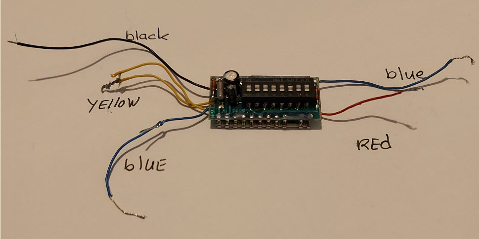

Hello all,
I have a loc-decoder, i think it is the first C80 variant.
Does anybody have a wiring manual for me or knows how to make the connections ?
It could be that i am missing a wire, i am not shure.
On the back it the following is readable ;
Märklin 60282,
Blaupunkt 8638 309 949

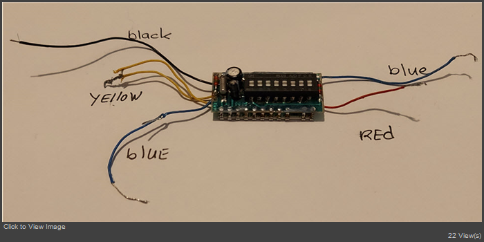

Thank you very much. Do you also have a circuit or block diagram of the 6080 (C80) decoder ?
I see that I am missing a brown wire, were is this connected on the pcb ?
Or do you have some detailed pictures ?

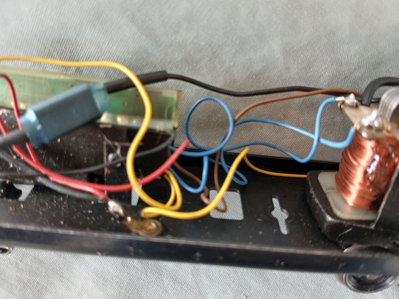

Hello, good afternoon,
The brown cable goes to the locomotive ground, usually the screw in the motor block
I hope that the pictures help you

Thank you,
I dis-assambled the decoder and found out where the colored wires should be and made new wires, now i can use it....
