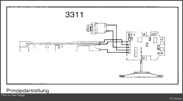

#6 Posted : 21 December 2024 19:54:06(UTC)
ktsolias
Joined: 01/05/2016(UTC)
Posts: 623
Location: Athens
thanks 4 users liked this useful post by ktsolias
Offline ktsolias
#7 Posted : 21 December 2024 19:57:03(UTC)
ktsolias
Posts: 623
Location: Athens
thanks 1 user liked this useful post by ktsolias
