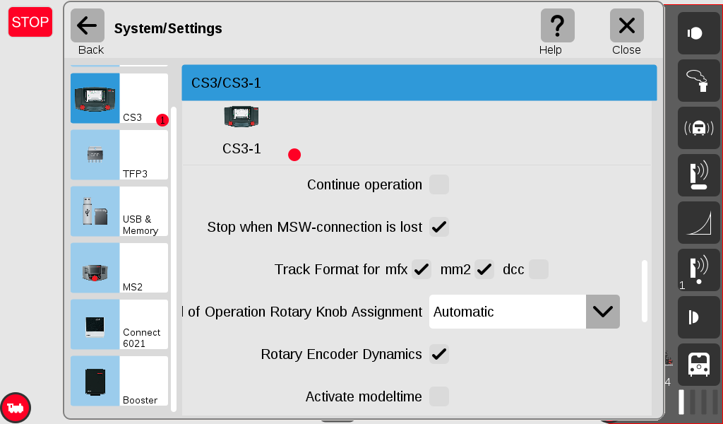

Regarding Mfx registration, check that your CS3 has this settings enabled:
Note that older non-mfx locomotives needs to be added manually or from the database. (MM and MM2 protocoll)
(I currently don't use the DCC protocol so I leave that off)
