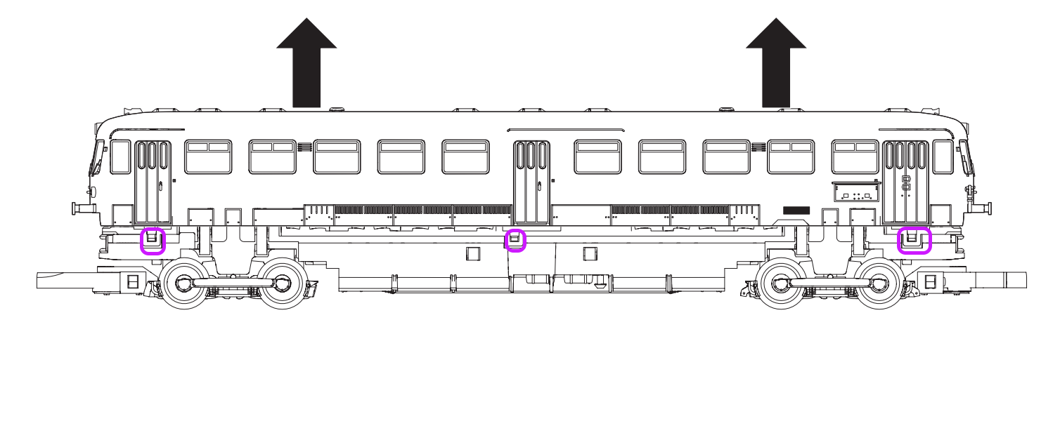

Chris G has already mentioned that he has been unable to remove the body of the ETA 150 railcar to adjust the tail lamp stting and I am in a similar predicament.
Has anyone else here managed this successfully and, if so, would you be kind enough to share your technique?
All the best
Chris

Märklin is very clear on how to remove the body.
There are side latches on the body 3 on each side (see pink circling)
I suggest you unlatch each one gently and insert a toothpick to prevent it of closing againg
I don't have this model but I have many Märklin HO passenger cars and goods wagon which are latched like this
Zme

Hi Chris
Thanks Jean
The problem I am having is that there is just noting of the chassis to get hold of! I have some strips of thin plasticard I usually use for just this job, but with nothing to hold the chassis I'm getting nowhere!
It's not the end of the world, but it would be nice to adjust the light setting!
Thanks again!
Chris

To conclude on this, this evening inspiration struck and I made a "tool" out of a couple of bits of 0.25mm plasticard that gripped the chassis just enough to separate it from the body.
Happy to go into a bit more detail if anyone is interested.
Chris
Zme

The "tool" I made consists of a pair of 20x50mm pieces of 0.5mm plastikard with a strip or 20 x 1mm glued right at the end to form a ridge.
To use these, insert between the chassis and body on each side of the railcar with the ridge part on the inside. I found it worked best off-centre close to the bogie. You can then carefully pull chassis and body apart by holding the body shell in one hand and the two plasticard strips in the other.
Hope that helps
Chris

I'm pretty sure the body shells are of regular plastic - I'm sure I would have noticed the extra weight if it was metal impregnated.
Even when the latching pips are disengaged, it's still hard to get things apart as there isn't anything to get hold of on the chassis. You can see he's struggling a bit in the video holding the bogies which on the trailer car, at least, are very delicate. The device I made grips the chassis, and gives you all the purchase you need to separate it from the body.
Chris
